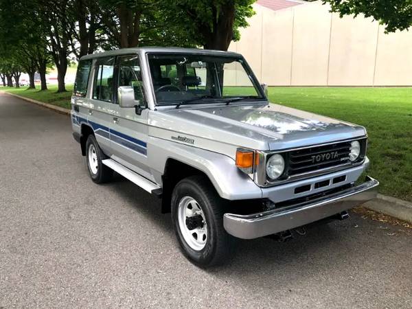

Anyone use these front hub caps, or better yet have a picture of their rig with these on? I have the same style caps on my rear wheels and I'm debating whether to go with a set of these or the black "sleeve" style that does not cover the hub lock. I rarely ever engage 4wd so I don't really care if I need to pull these off to do so. I searched online but can't find any photos.

The ad says they are for 1985-1990 FJ60 and FJ62, don't they all have locking hubs?
Unfortunately I don't see any measurements in the ad. The 60 in the ad doesn't even have them on :doh:
Might just get the sleeves to play it safe but I'd love to see these on if anyone has used them...

I thought they all came with locking hubs also, the one in this thread from Jordan doesn't have locking hubs
I don't think Toyota would have ever covered the locking hubs.
wonder if they are for rear full float axles?
As Paul said, those are for full floating rear axle ends (they cover the hub assy).
The front caps have cut-outs for the manual hubs.
It's weird that there are multiple ads for these elongated caps and they all say they are for front wheels 🤷‍♂️
Onur, would they work on the front axle with drive plates?
