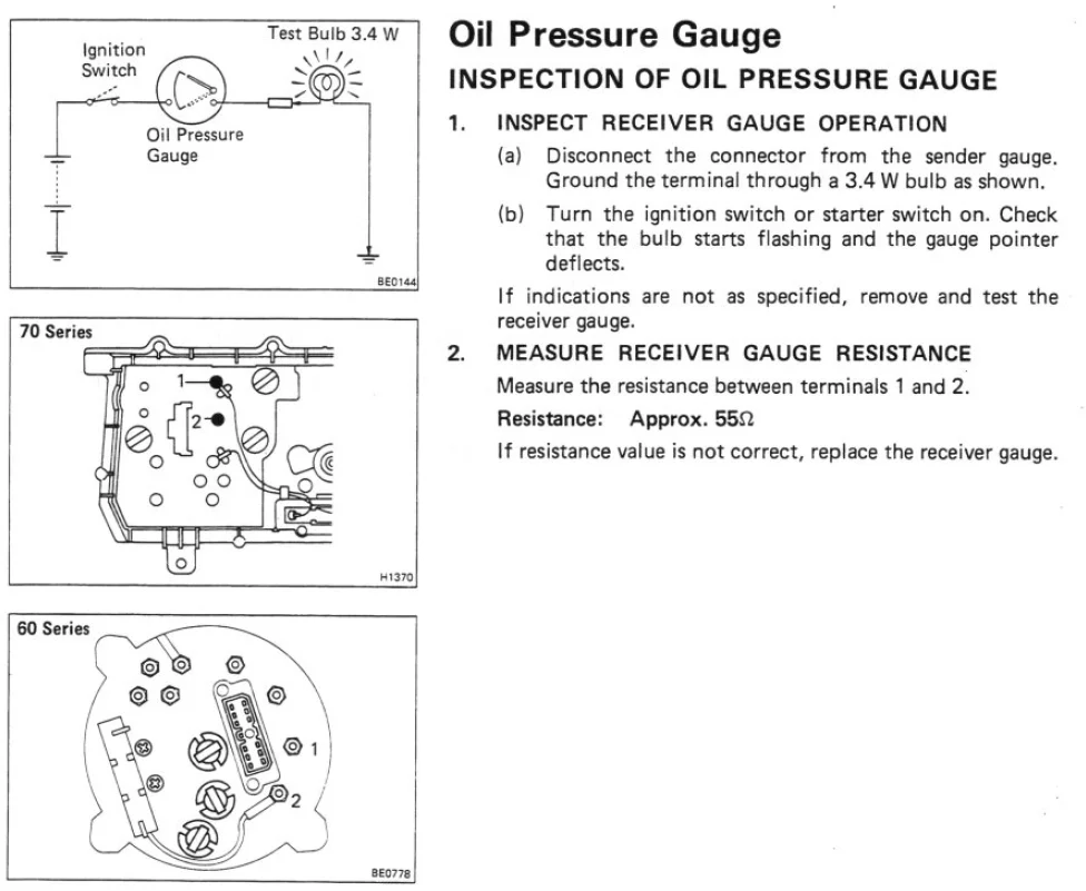

Hello I have a 1986 fj60 with a 2f in it it has been parked a year and a half because it broke down then I moved but I finally got it to where I moved and it fired right up but there is clicking in the top of the engine and the oil pressure gage is maxed out what are the possible problems?

It might just need a valve adjustment to get rid of the clicking. Not sure what advice to give about the apparent high oil pressure.

replace the oil pressure sender with a gauge, temporarily. More than likely it is an electrical problem with the oil pressure sender or gauge. But if it has been just sitting a year and a half, you should change the oil and oil filter.
