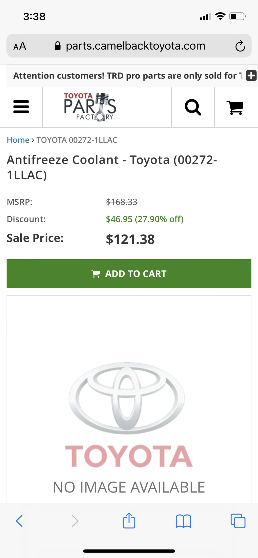

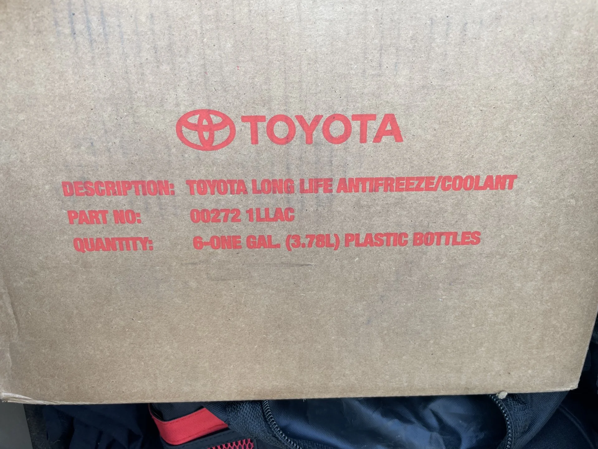

Find your local dealer, use their online discount purchase price, and you can get a gallon of OEM red for just about 20 bucks a gallon. I don’t know where you are in Phoenix, but here it is available at Camelback Toyota. 6 gallon case for $120. I paid a little bit less in Austin ($112).
Just a side note, not trying to get into the red versus greed coolant war.
