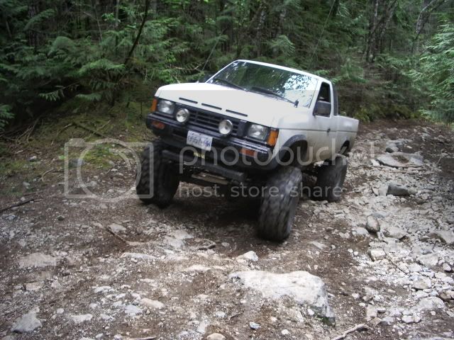

Joey's '98 taco with fj80 axle and pretty small backspaced wheels.
I remember seeing those trucks before, unfortuneatly I can't find and FJ80 axle around here for less than $1500 and getting high steer on it is somewhat expensive when you go with leaves, which I am. I figure I can build the FJ60/62 axle for around $600 with high steer, $800 with 4.88 gears to match my rear.
