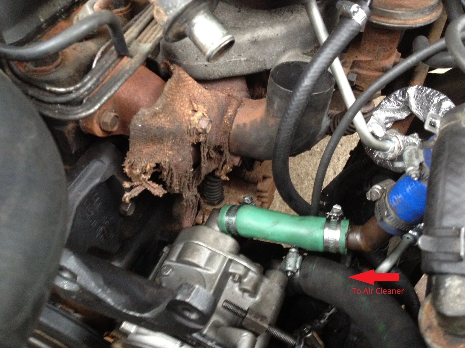

Hi everyone. Can anyone verify the smog pump hose routing for an FJ60 with a 2F engine? This is how ours has been routed forever but wondering if correct...

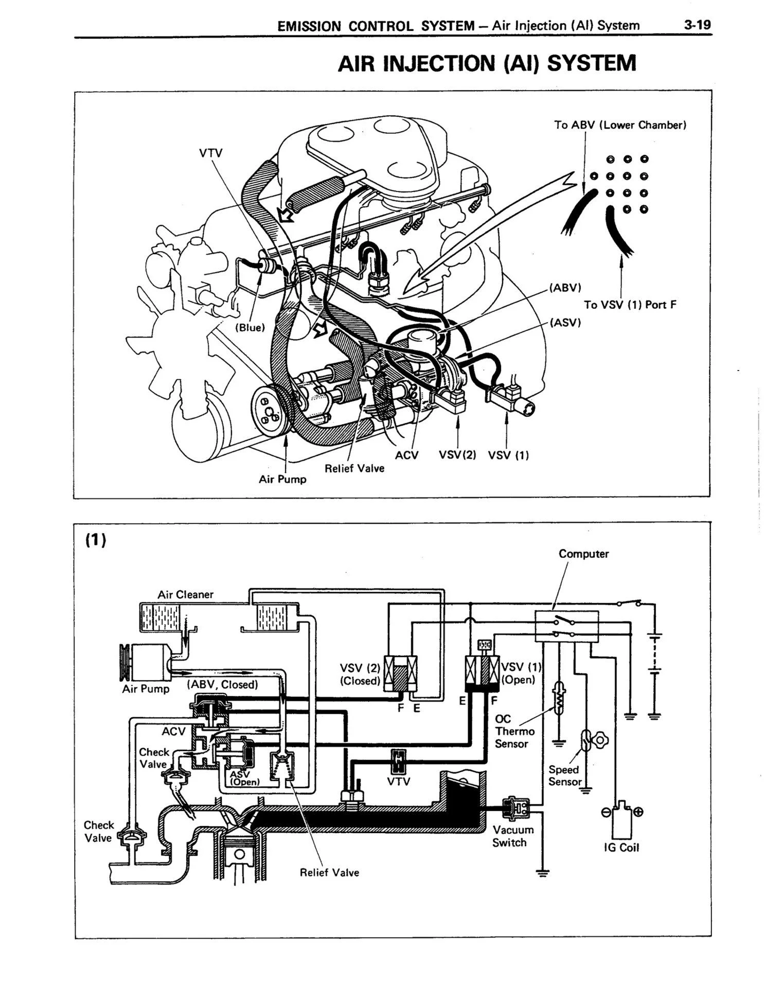

I would say no. There's no hose going to the air injection manifold. The different colored hose with funky fittings also doesn't instill much confidence. The emissions manual shows how it's suppose to be plumbed.

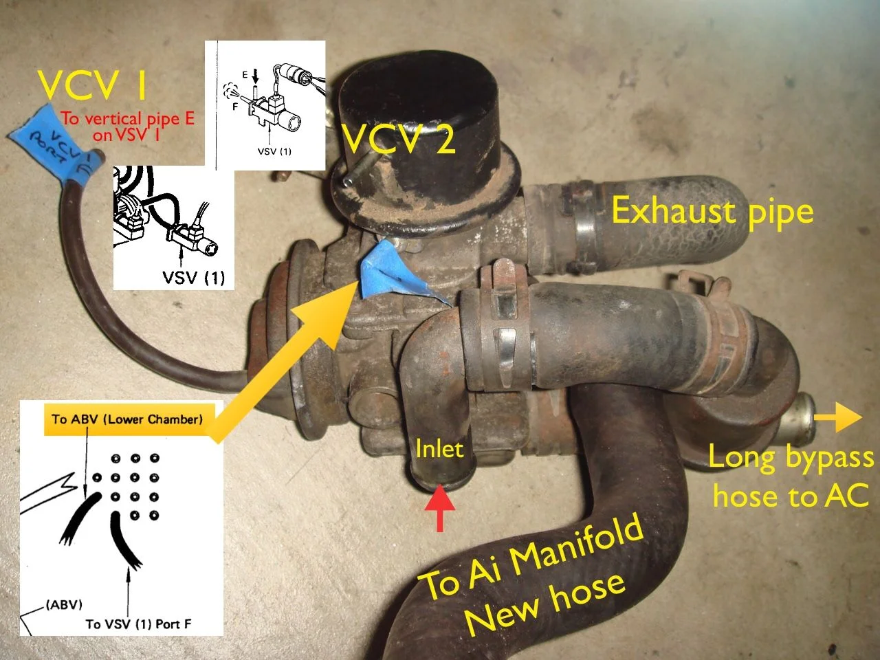

And here's some labeling for the air control valve.
