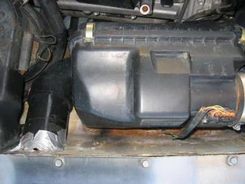

i am still expermenting with how to re texture the areas that i had to modify,
Dre ,
It is not too bad , just used a small torch and heated it where it needed bent and added material to make it smooth , found out that black tie wrapps melt at a low temp and fill in niceley.
