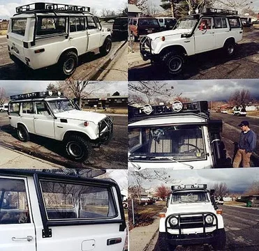

search for Gumbys ride
Those are awesome builds but not quite what I am looking for. I want to bolt through the cab so only the top half of the roll bar is visible. The dead link I found for one similar was out of Australia. Thanks for helping, these builds are helping me get a better vision of what it may look like. :-)

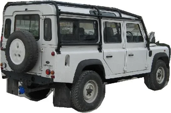

Thanks for the replys... yes the defender type is I am looking for. I'm sure I can fab it up, but wanted to get a visual from somebody else if I could first.
Does anyone know how to resize those pictures, to get a better look. How do you think he mounted it, just through the side of the body. I like the look, on the Rover, not sure yet on the 55.
Thanks for the pictures, Ron
To resize the picture you will have to save to computer and zoom in or enlarge the view on your internet viewer... of course you will get a larger blurrier picture.
I'm not sure how he mounted the fj's, it would need to be tied to the frame or it would be kinda pointless to go through this much work for a "show cage".
Safetydevices.c o m has a diagram of how the defenders are tied to the frame. It's copywrited so I didn't copy it here. They manufacture the land rover cages.
It appears there is room on the FJ55 to tie the front and rear mounts to the frame relatively easy. The hoop behind the rear seat would probably have to be exposed inside the interior to adequately tie it to the frame and maybe would benefit from a crossbar between the sides behind the rear seat. The "b?" pillar mount behind the driver’s door would have to be attached to the sheetmetal using nut zerts or something, I suppose, and would only be used to add some rigidity to the entire rack and not provide much support by itself.
