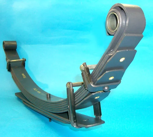

I would give Alcan a look as well. Good flex, good ride and completely customizable. You can pick whatever lift you want...stock to 5" and whatever weight rating you want. If you were gonna haul a bunch, or for a winch etc...longer springs whatever you want.
I had them on my 55 and they were awesome...great ride. You are looking around ~$200 a spring.

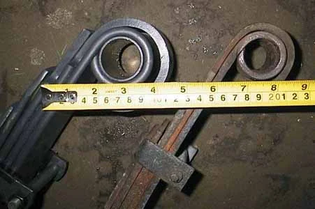

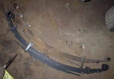

Stock Toyota springs from SOR. Put Toyota 1 tons (10 leaf) in the rear. Marv suggested I remove a couple leafs for a smoother ride, but I left all ten and even with the wagon empty the ride is great. Pack for 5 days of camping there's no sag. I'm not rock crawling, but they worked great for very rough cross country wheeling and they're DIRT CHEAP!
Here's a pic with 31s.
And what did you do for the front to have a level ride with 10 leaves in the back? what shocks are you running? I sent an email to SOR and asked about the Marv 1 ton special, but they were pretty clueless. I guess I did not speak to the right person. Any help would be appreciated. I would think they would have to be cheap to have them shipped from CA with what they must weigh. thanks

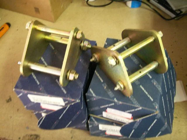

SOR anti inversion shackles
Does anyone know if these shackles would work with a set of OME springs? As for Alcan, I figure if i was going to spend that much, I may as well go with OME, as they have done the calcs. for weight and all. I would have no idea what to say about weight etc. I am worried that if I piece a system together, it might end up uneven from front to rear?
