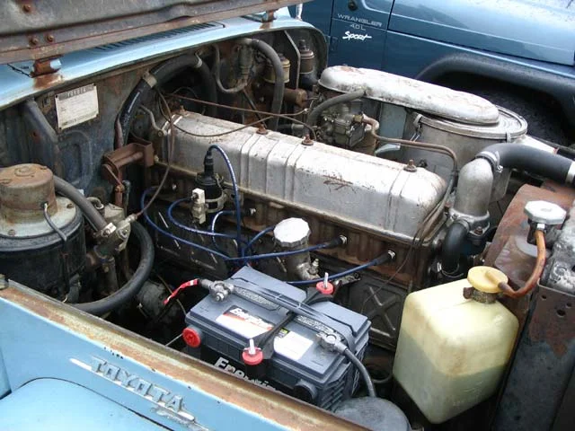

since you were just playing with spark plugs--
treerootCO said:
yep, #4 spark plug wire was faulty.
wrong plugs installed as well..the new ones smoothed out the idle.
Do your 45's take the short or long spark plugs? the distance of the threaded part that goes into the engine. My 45 has, "short throw" plugs in it, and I have found mention of this size in many places, but haven't been able to find any of the short plugs, just the longer, 3/4" ones. I am afraid to put the longer ones in, as I don't want to have a piec break off inside my engine. Any thoughts?
Abe
yep...
go to http://www.densoproducts.com/resultsSearch.asp
enter W16FS-U in the search field. I didn't buy from that site but they do have all the specs on Denso plugs. The application guide on that page shows Corvair but those plugs are what I am running.
14mm thread, 12.7mm(1/2") reach, 13/16" hex, U-groove ground electrode
Let me run out to the truck and get the NAPA plug wire part number for you too. Really nice wires and only 25.00.
Napa spark plug wire set - Napa part # 700126 7mm (blue in color if that bothers you)
Oil filter element - Toyota part # 04152-60060

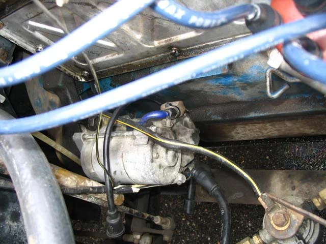

Swapped the starter with an FJ60 starter (because Landpimp is cool)

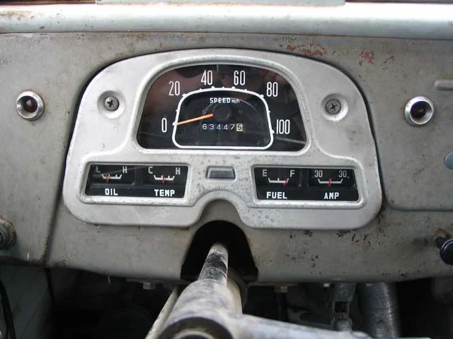

Cleaned up the gauge cluster and replaced the insulators for the amp gauge. Last thing I want is another electrical fire. Been there when my J**P caught fire.
Took out the bulb covers so I can actually see the gauges too
