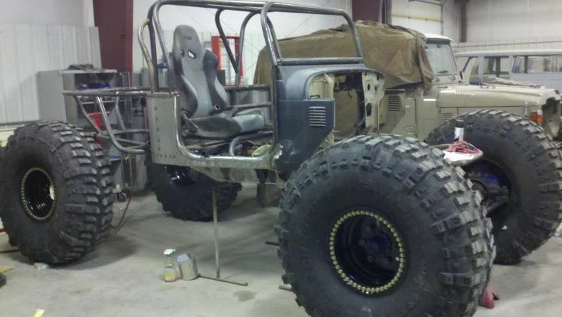

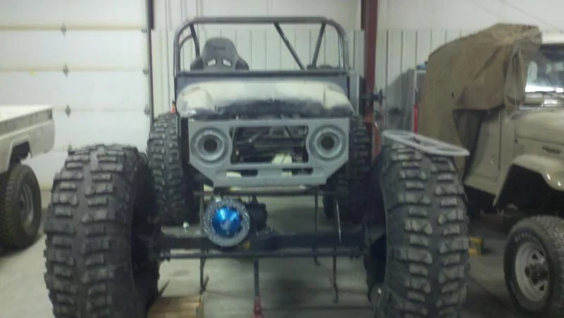

Ok, to start off this is a slow build.. (poor broke metal fabricator)
project plans our:
a fj45 tube truck
2.5 rockwel steeringl axles
8.1 vortec engine
wiple supercharger
4l80e tranny
atlas 2 speed t-case
4 link front/rear suspension
18" coilovers
ride height as low as possible 6" up travel front 8" rear
the look of a short bed 45
just a tid bit of backround info I work for Proffitt's cruisers.......:)
WOW...
45 tube truck

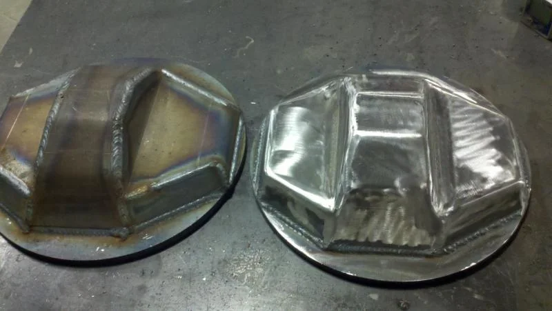

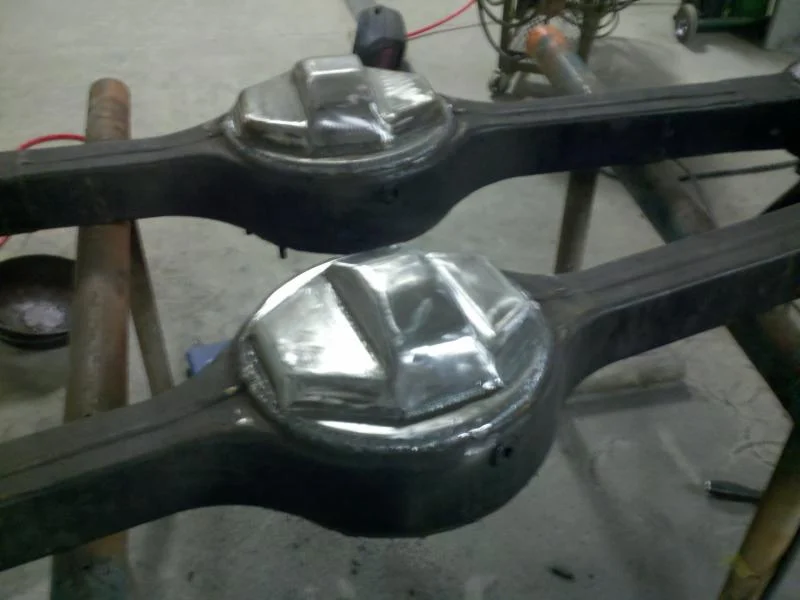

as of now the rig has overson pinion brakes, diff protectors, 1 double ended ram, johnny joints, mrw 20" extreme duty bead locks, and a ton of tube work
sorry to say, but now is the waiting time.... funds are low rent is due and truck is just begging for attention

Will the rockwells retain their hub brakes in addition to the diff brakes?
What are the diff rations?
Updates?
If I had cash on-hand to build a dedicated crawler, this is pretty much the way I'd go, maybe with a carbed Ferd V8 and an SM465.
A carb'd engine and a wide-ratio trans vs a supercharged big block and an auto to handle it? ummmm.
pinion brakes typically are the only brakes.
6.72:1 is it for rockwells.
