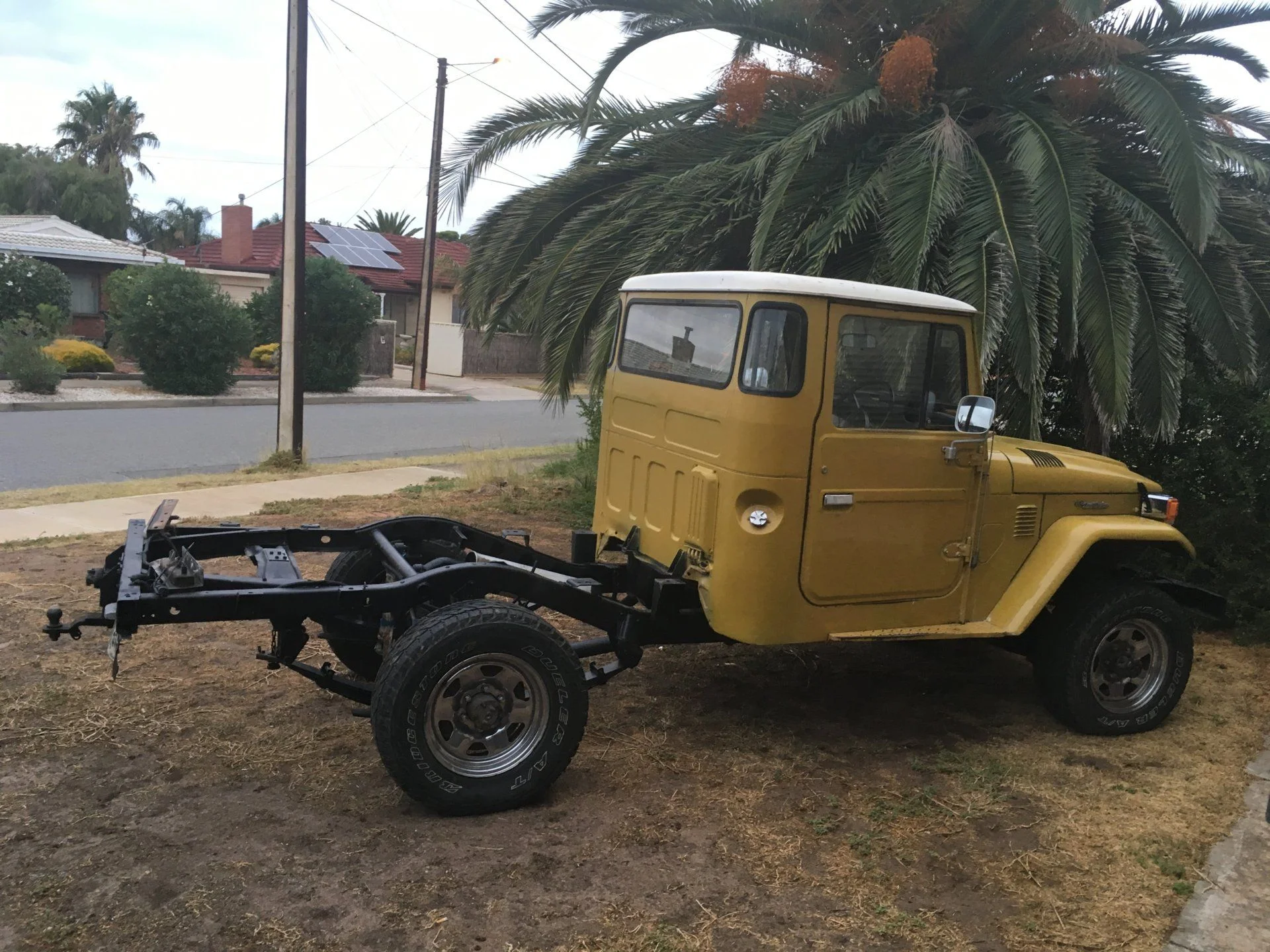

I've seen a couple of 70 series tubs mounted to 40 series and it doesn't look too bad. The one below is on an 80 series frame, but you get the idea.

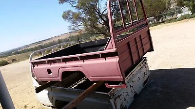

The 75 series bed is a good look, but requires bobbing the front by ~250mm.

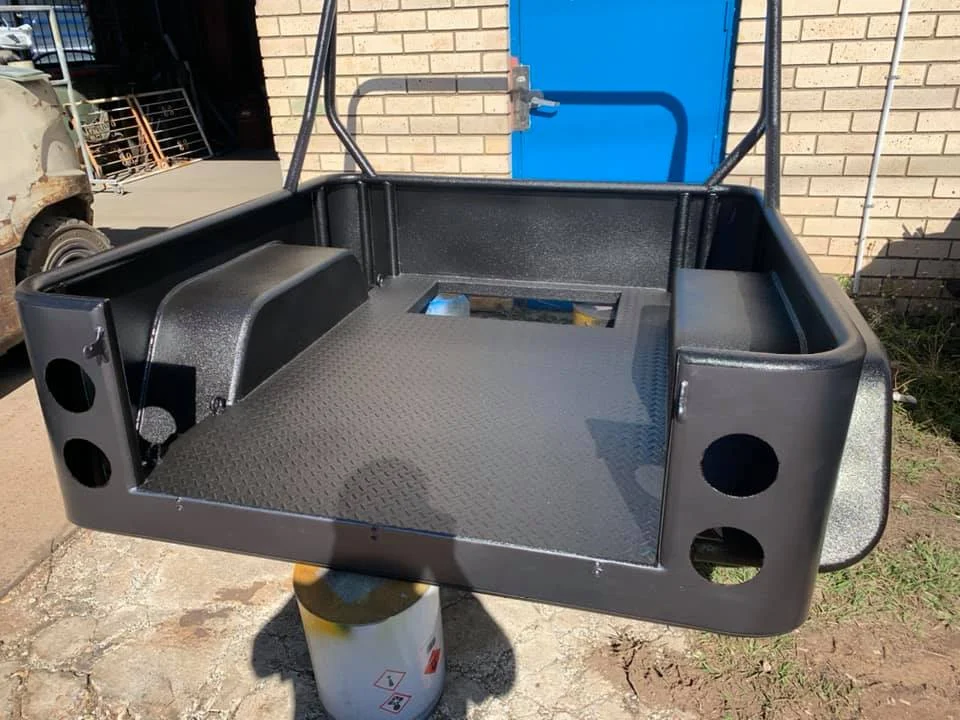

As above, I bought a rusty styleside tub and then had a local sheet metal shop match the profile, then made the rest to suit. Was stoked with how it turned out. With paint cost would be atleast $3-4k+ but.
Plenty more pics in my build thread but here is a few recent pics of the ute.
Super easy to Bob the 75 bed,

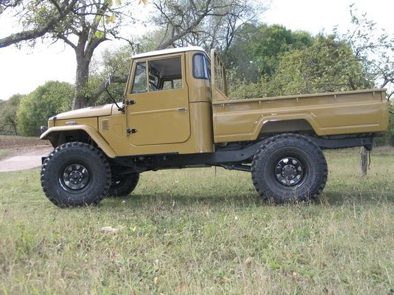

The key for me would be that the bed matches the body line of the cab. The first pic posted by @sneaky the bed doesn’t look “correct” to me. I like the body lines of the truck @Twisty posted. It looks factory.

I totally agree about the line of the cab- the 70 series tub sits too high but I have a plan for that. I am going to fabricate some matching undertub toolboxes that will meet up with the cab lower body line and also continue the line of the wheel arches and then slope up at the bag because I don’t like wide asses haha. I am doing some rendering so will post them when done.
