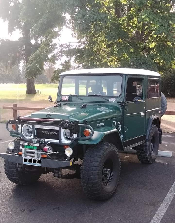

That doesn't look far from the 031 on my roof and wheels.

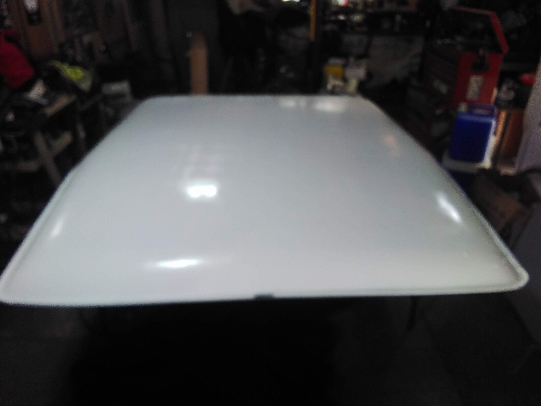

If I remember correctly the fiberglass tops were gel coated, not painted. When my top and bezel needed a refresh, I just rattle canned them with 6 cans of Rust-Oleum fusion white. Slightly brighter than what OEM looks like but I wanted it to have the most contrast to the green body. This was nearly 4 years ago and it still looks good today.

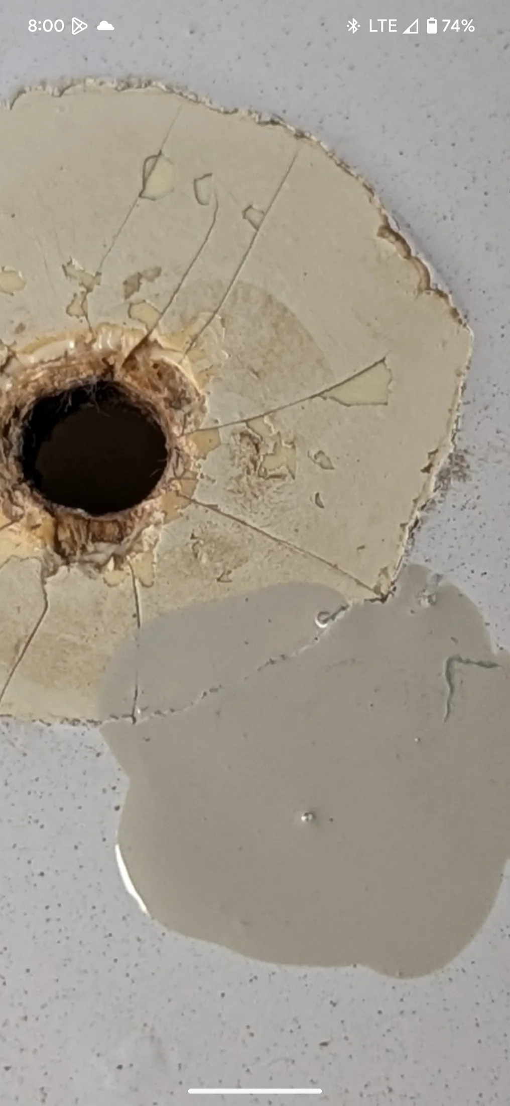

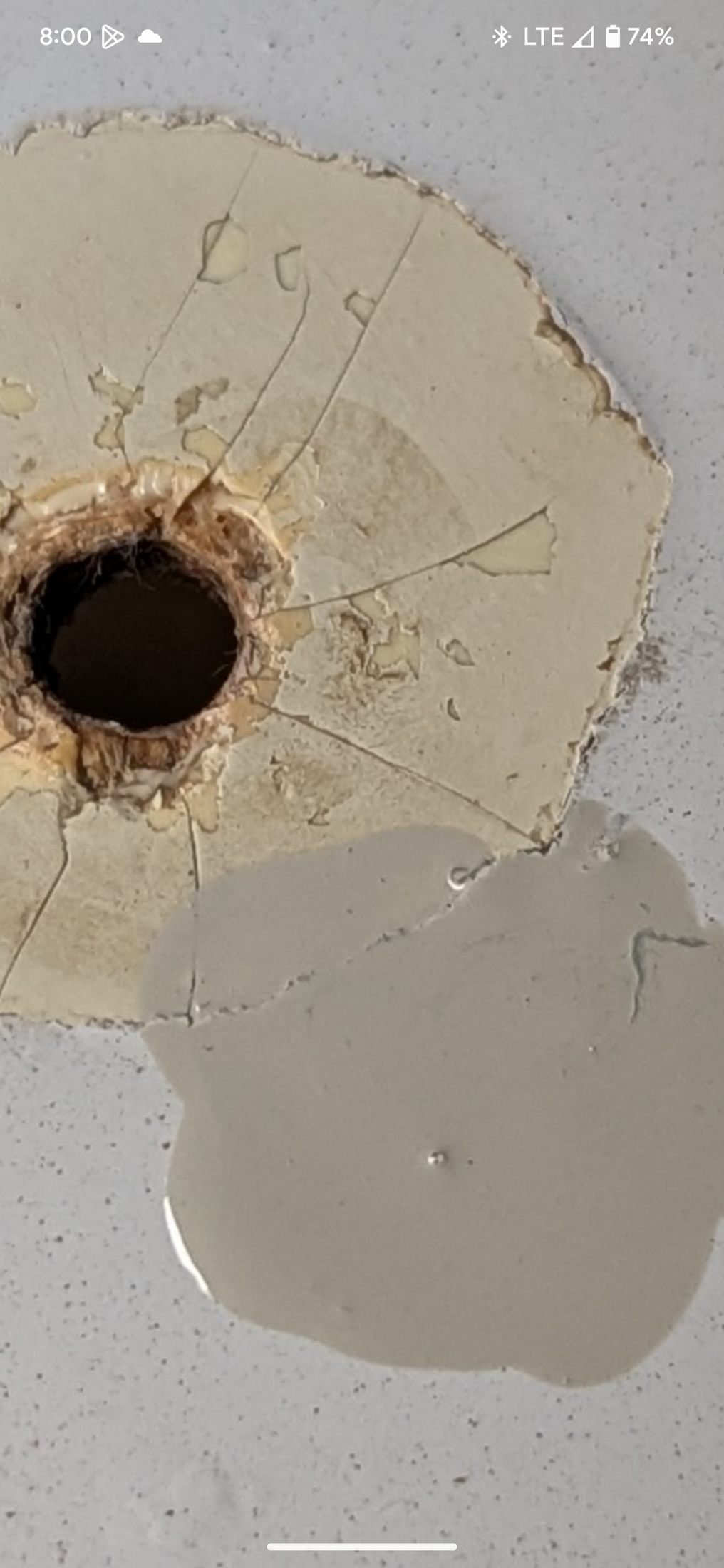

This was the roof for my '76 - the original Cygnus was under a repaint of blue, and under the Cygnus was the fiberglass gelcoat. At least for '76, the roof was painted and not raw gelcoat, as the steel rail and cap were painted after mating.
A dollop of wet Cygnus is by my finger, and it dried pretty close to the old paint. (wet and dry are slightly different shades)

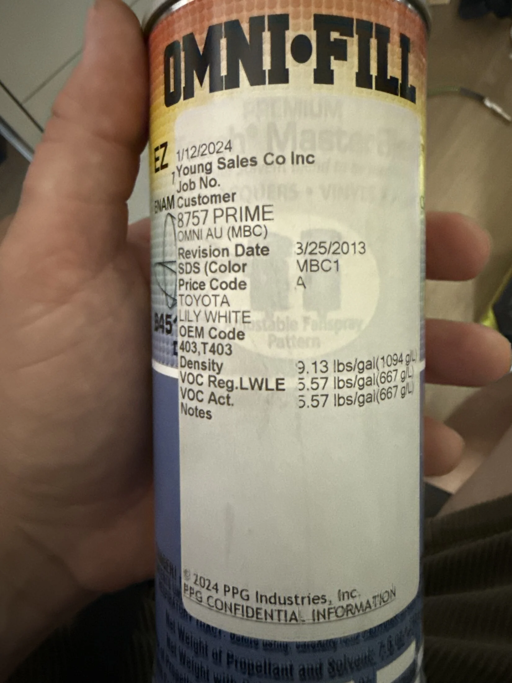

I believe it's the much sought after Shell Ivory or Lily White and not the Cygnus. Shell Ivory which i think was replaced by Lily White was a lost color code but a few deep diggers found a good match with a Lily White PPG Omni or Dupont LS123 or LS122. Ill attach the lily white i had put in a spray can below
