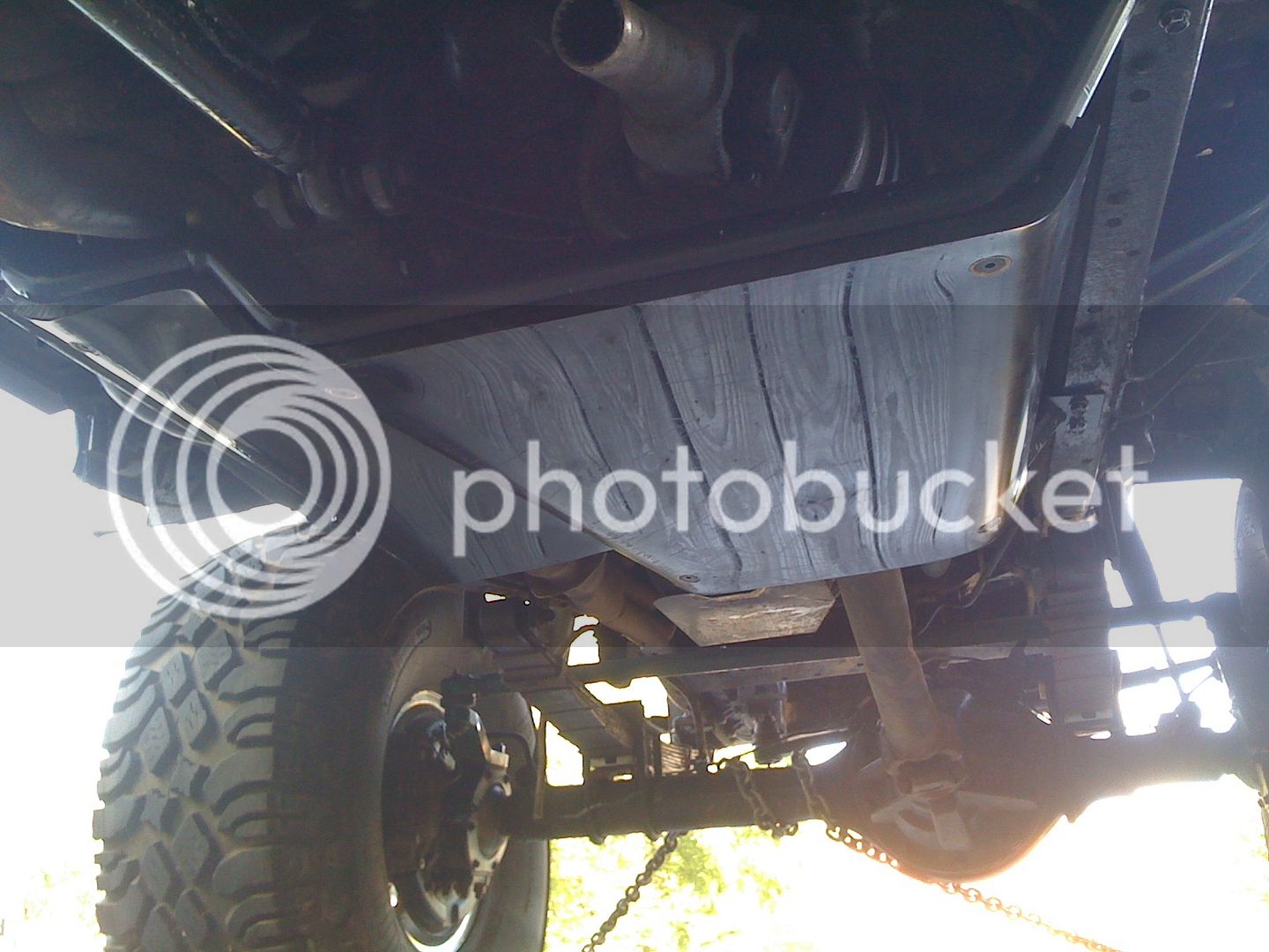

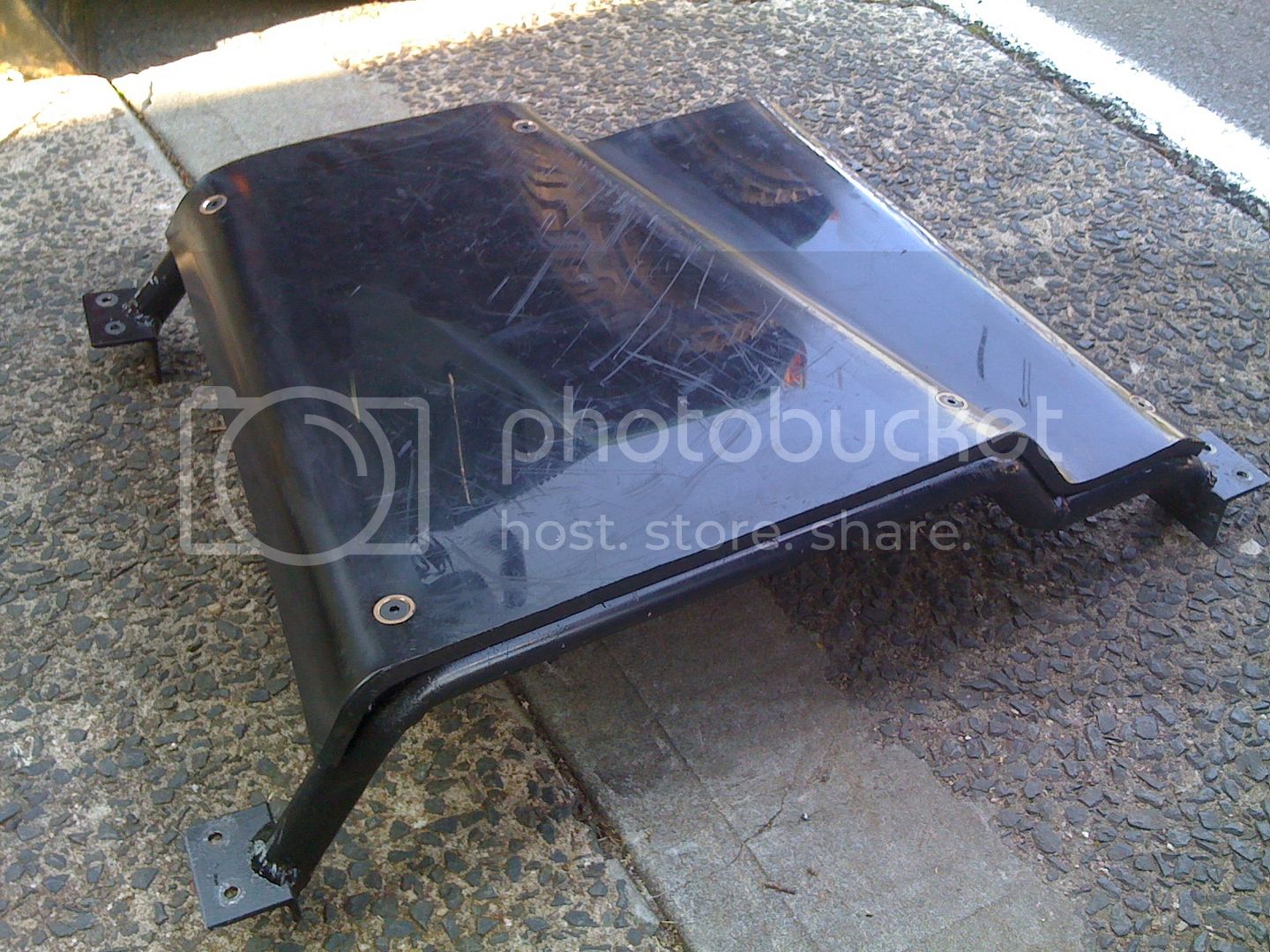

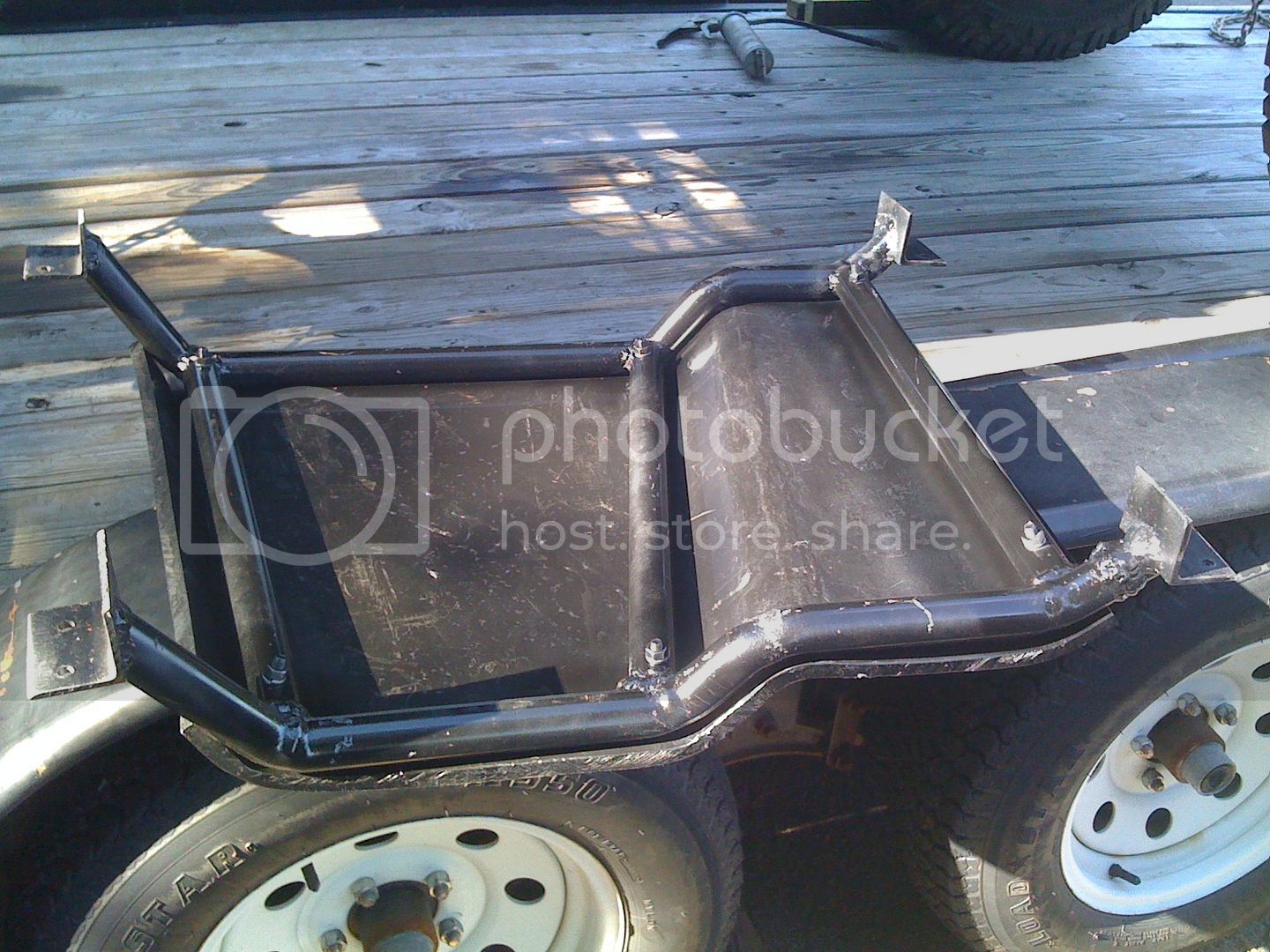

I finally finished the skidplate for the 40. Had to bend up some tube for the crossmembers and covered it with 1/2" hdpe, bending it wasn't to bad, I have worked with it before, Its been on my FJ Cruiser for two years with no problem. Had to bring it down on the 40 a bit because of the sm420 trans, what do you think? capt

Looks great! Where do you find the HDPE?
Thanks I'll search for it. Great idea!
