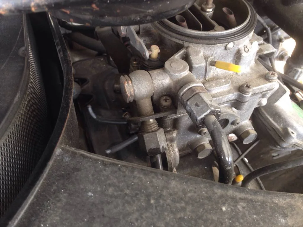

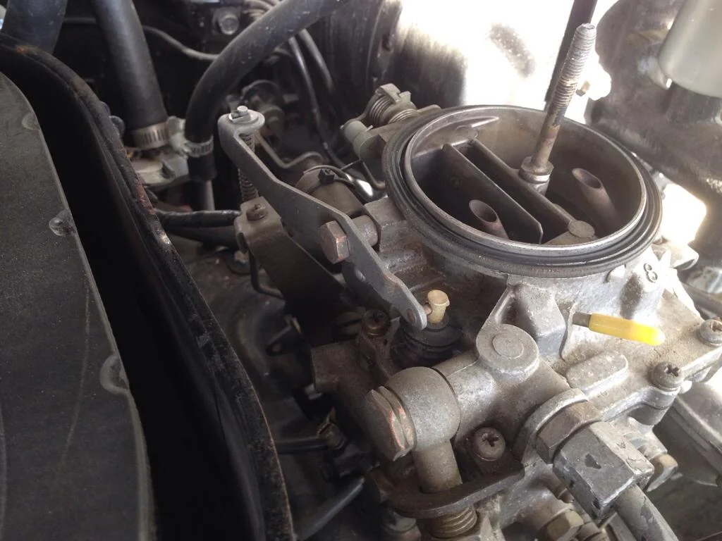

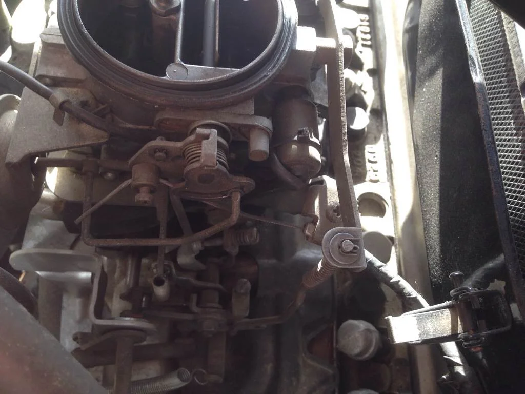

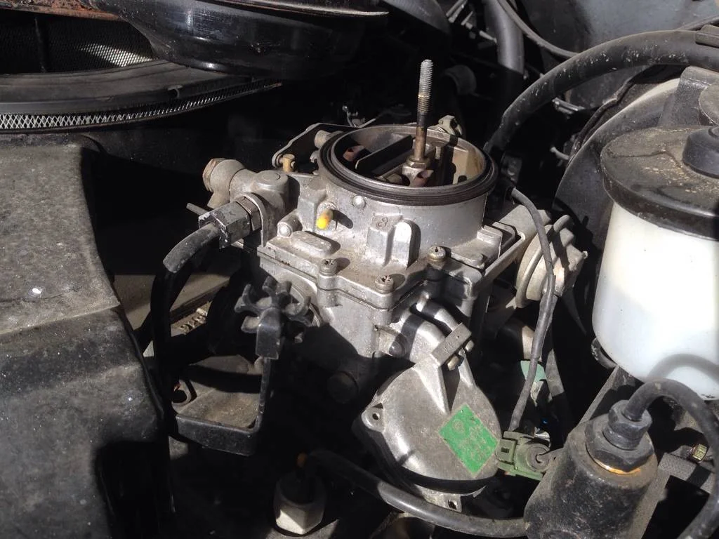

Hey FishTacos sorry this took awhile. Hope this tells you something.

I can't tell from your photos, but where is the dizzy vacuum line hooked into? I have the exact same type '77 set-up as yours, being a high altitude carb. If you look at your photo #2 above, it appears that the vacuum lines into port #5 & #13 are possibly capped. In a desmogged setup, I believe your dizzy line should connect into port #13.

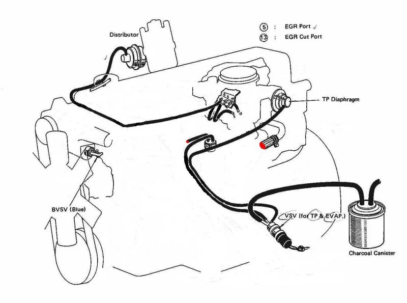

I went by the desmog diagram from subzali within this forum.
I updated my desmog vacuum routing per the Jim C. - High Altitude carb desmog diagram I posted below, see post #20.
ok i'm gonna check the diagram and try and figure out which line is the Dizzy vacuum line?

Checking an old thread for answers....similar situation with my 77'. Has a Holley on board, same dieseling and throttle cut out when gassing it. Did yours end up being the seal between surfaces? De-smogged improperly?
Being it was brought back up....I'll update my post in this thread. Per Jim C., the high altitude carb desmog should look like this:
