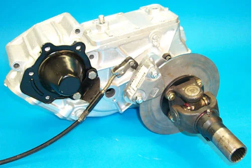

So I take it there's no easy way to ditch the big ol' drum on the back of the t-case for the ebrake... :confused:

I guess there isn't an easy way to get rid of the drum other than having it machined off.

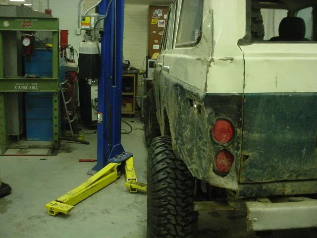

I'll get a pic up showing the tires sticking out tomorrow.
manafre disc e brake conversion

The 80 axle is about 2 inches closer to center than the 55 axle was. On a 40 it might make a difference.
