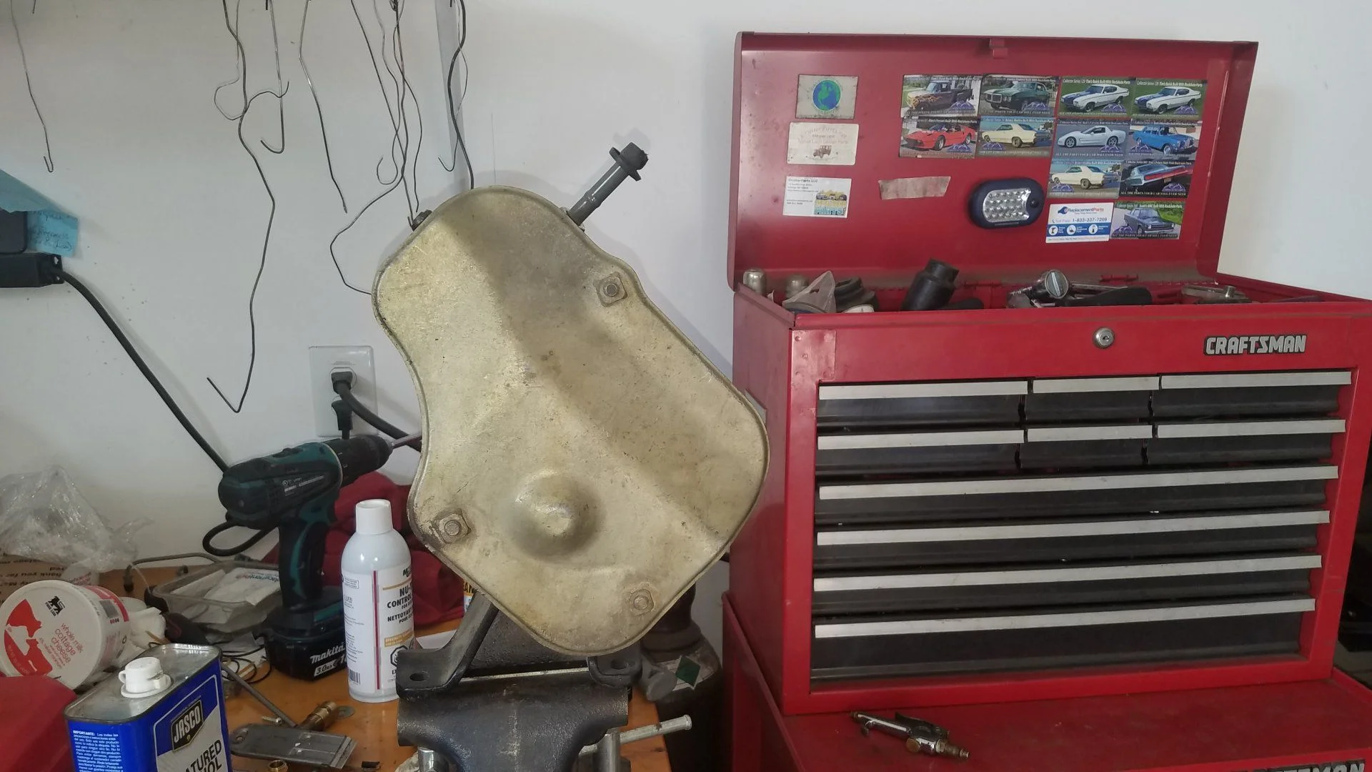

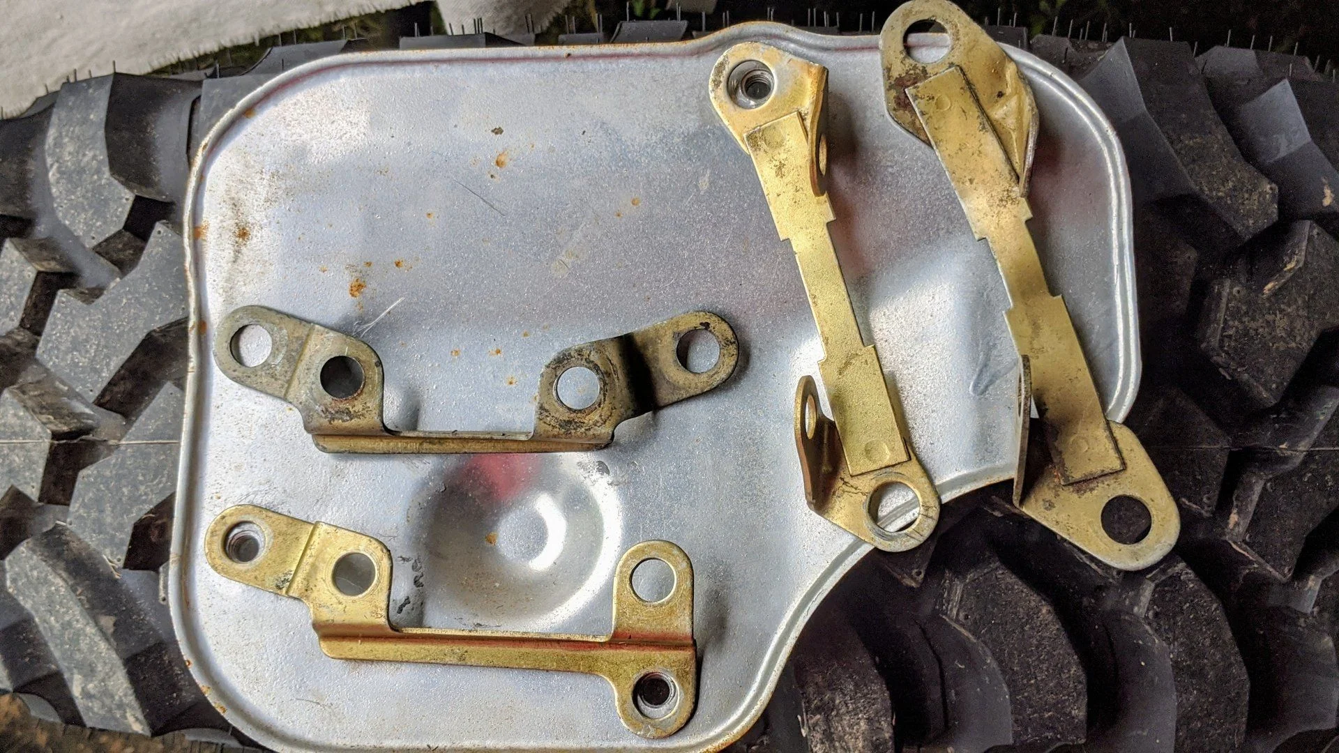

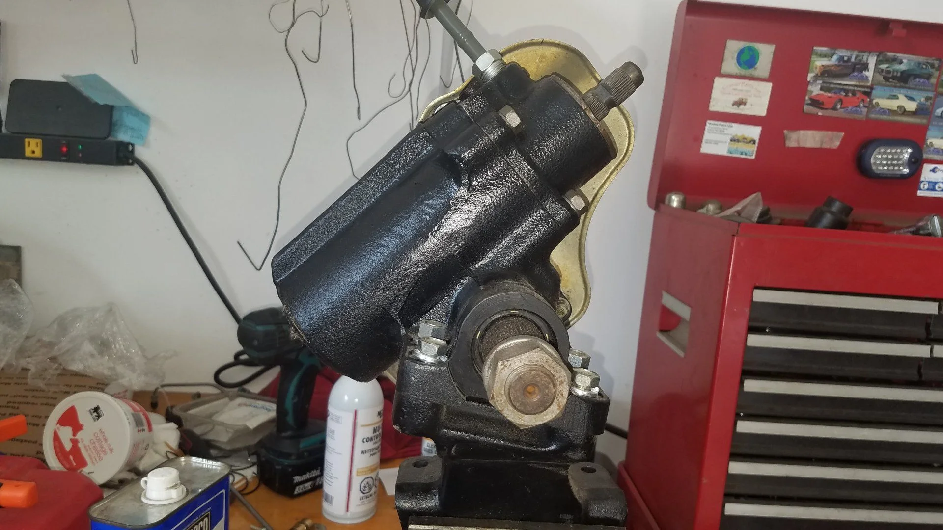

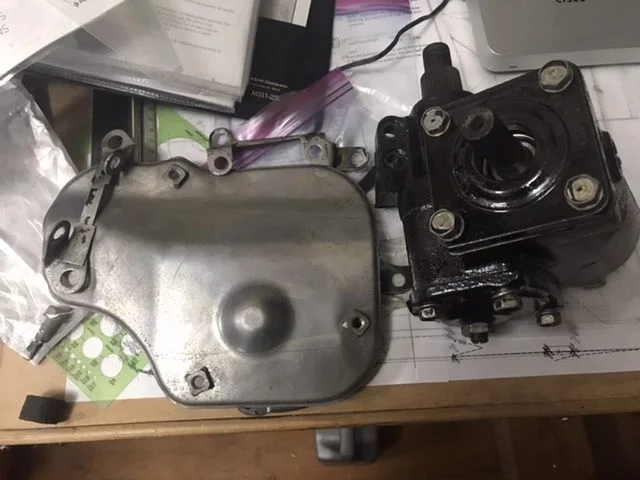

Several years ago I bought an OEM power steering gearbox for my 1980 Fj40 and I'm now trying to figure out the heat shield installation. It should be fairly simple. I have four different mounting brackets and it seems that none of the combinations I try work. Hole alignment on the shield to the gear box just dont seem to work out. Is there a difference between manual steering and power steering heat shields? Thinking that I may have a heat shield for non power. Thanks

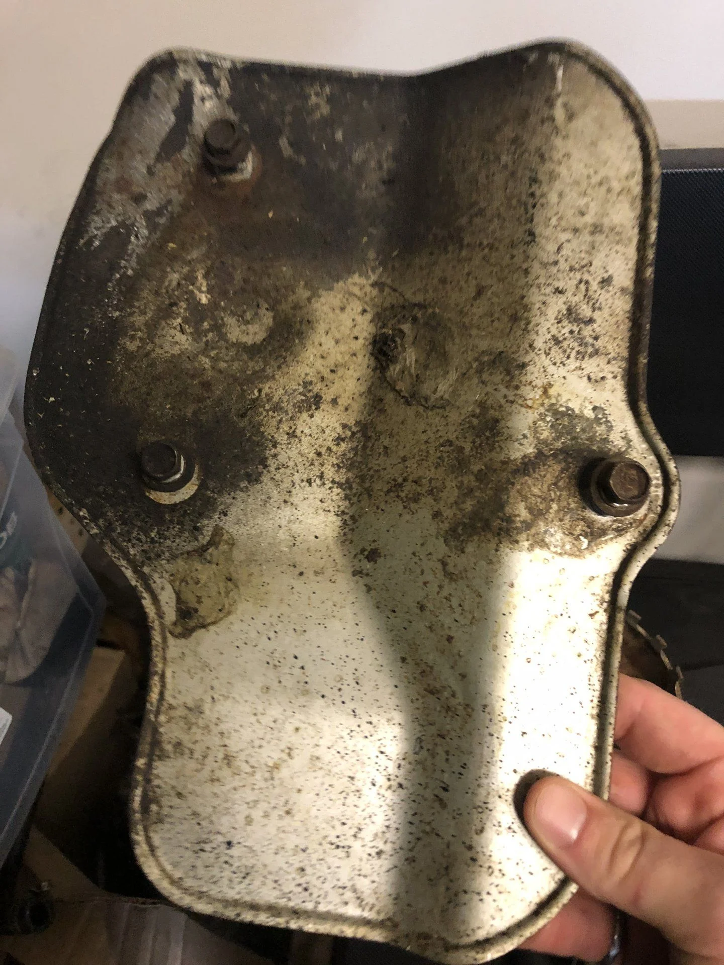

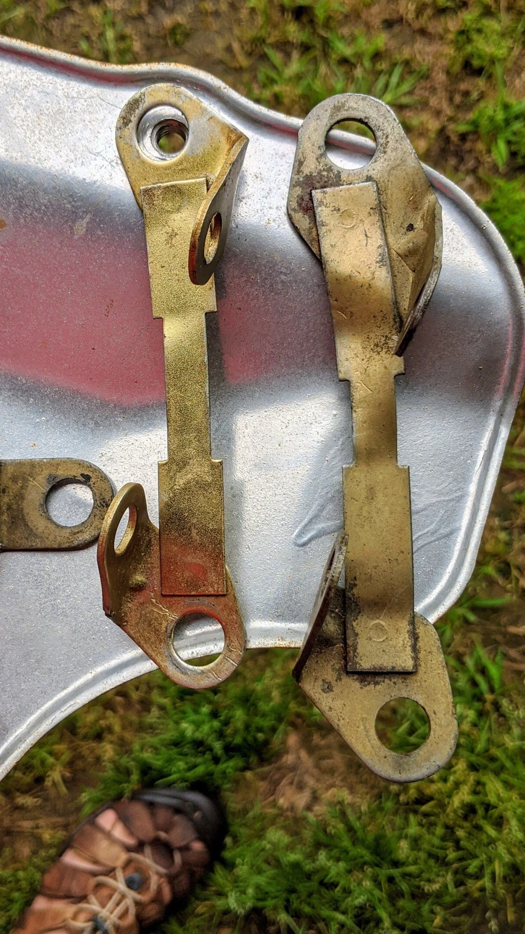

Here’s the later style manual heat shield and 2 brackets for comparison. Apparently the OEM power heat shield is really hard to come by, so hopefully yours looks slightly different :beer:

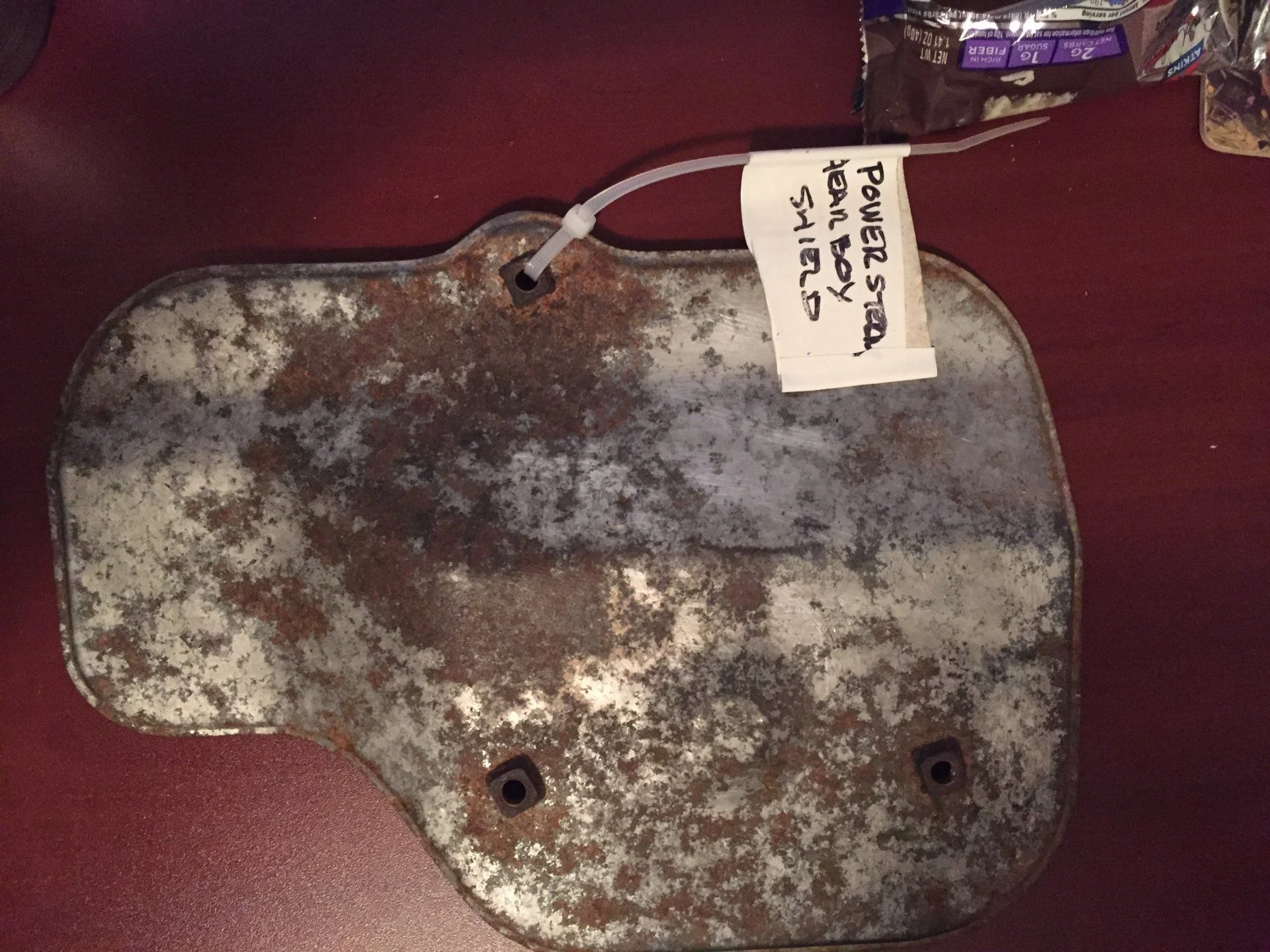

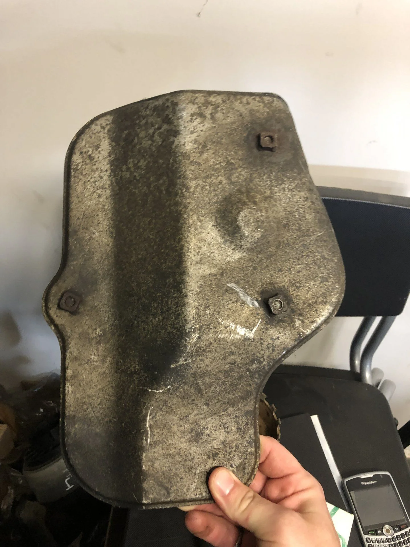

Here is my PS heat shield. The alignment of the bolts at the bottom is different than the photo above. I sure hope I didn't pay out the nose for the wrong heat shield
That looks correct to me.
@FJ40GURU had a ps heat shield for sale in classifieds. I fit the manual heat shield to my PS box, had to modify the brackets a bit but not that difficult.
That appears to be the PS type, a little bent in the bottom rear corner.
