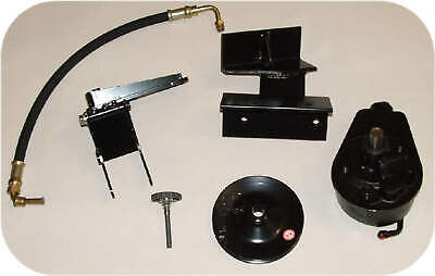

Hey Fam would you guys please point me to a good powering steering kit. And let me know anything I else I should know about doing a conversion!
This is the one I was thinking about getting on eBay. Your thoughts?
If that is not the JT Outfitters eBay page, I would recommend buying from the source: Power Steering Kit for Toyota Land Cruiser FJ40 FJ45 for Mini Truck Box – JT Outfitters
It’s the same price but this way you’ll get tech support. It doesn’t come with everything you need; you will need to source a pump, belts, etc. JT sells a deluxe kit that includes almost everything:
Yes you can save some money by buying parts here and there. When I did mine 20 years ago I bought some of the parts from JT Outfitters. Finding the old gear box on ebay is a good source but if not rebuilt it may end up leaking. Better off to buy the deluxe kit and get the rebuilt gear box. You will be happier doing that. Their bracket works without modifying too much.
