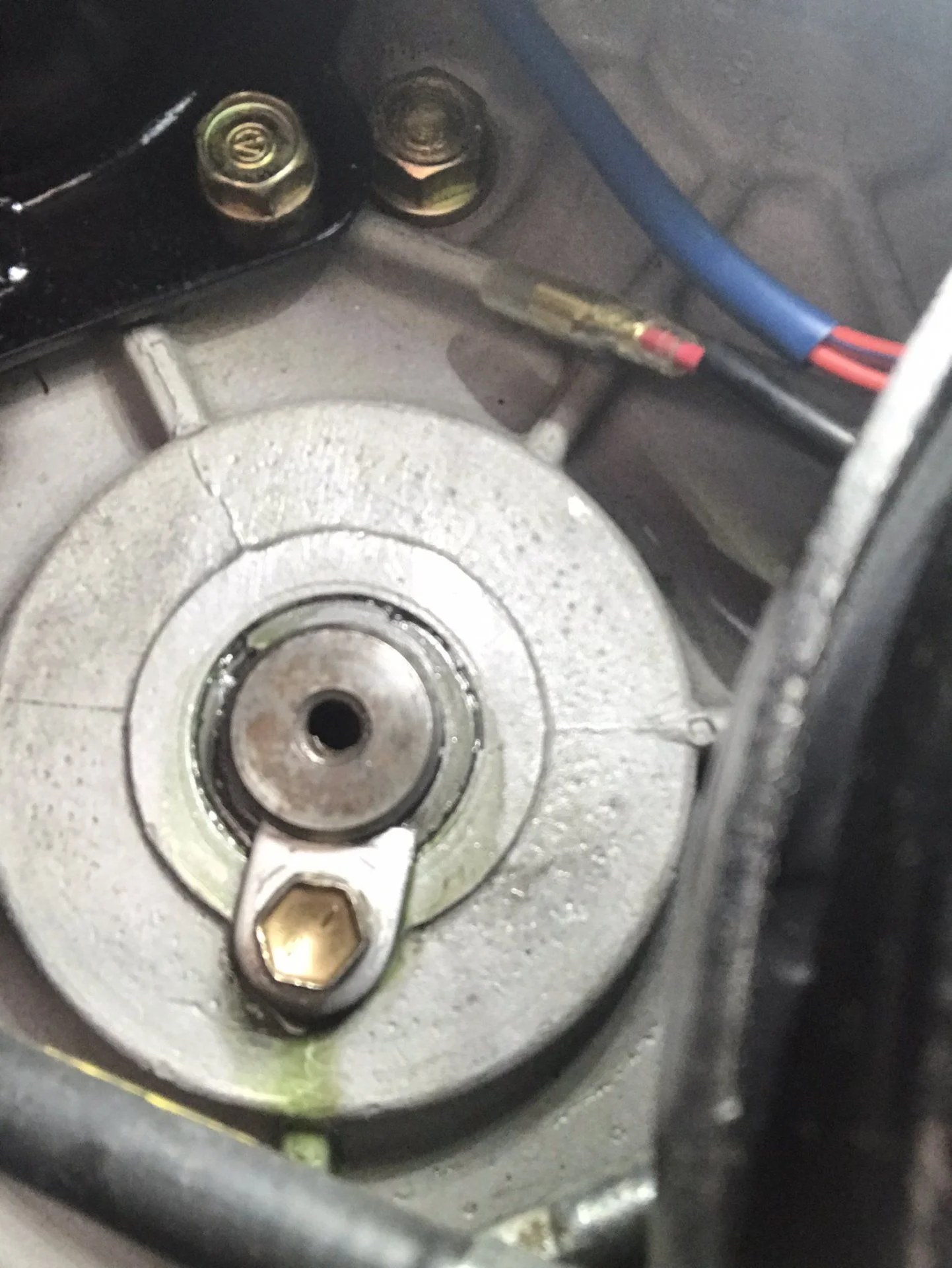

Starting new thread on this. Attempting to replace the O ring without removal of transfer case. I’m following the below steps and have a few clarifying questions in yellow.
Has anyone successfully done this?
Removal:
1. Remove 12mm retaining bolt and keeper, making note of distance of shaft protruding out of housing.
2. Home made SST - Using a 15/16 socket with 8mm stud, washer and nut screwed into shaft. Thanks @Coolerman (here is link)
3. Keep frost plug in T-case housing (front of shaft). Is this possible? I do not want to introduce another leak...

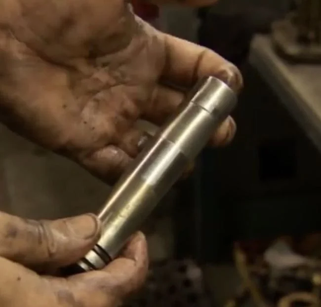

4. Slowly tighten nut on stud and back out the shaft just enough to access O ring. To avoid thrust washers falling, or shaft dropping inside of case, does anyone have the distance from rear shaft to O ring? It appears to be about 10mm based on the image I found below.
(NOTE: Image above is from the interweb and not my actual idler shaft. It is just for illustration purposes.)
5. Remove O ring ( if one was installed)
Install:
6. Install new O ring making sure to lubricate before placing on shaft.
7. Using soft hammer or drift, tap shaft back into place (Approx. 10mm)
8. Replace keeper and screw.
This is one of those procedures that comes with risk. Trying to mitigate it vs. overthinking.
I’m trying to avoid using “Right Stuff” gasket maker to stop leak at idler shaft. The information on The idler shaft O ring replacement without taking apart case is mixed. Hoping someone can weigh in here. Trying to avoid removing case.

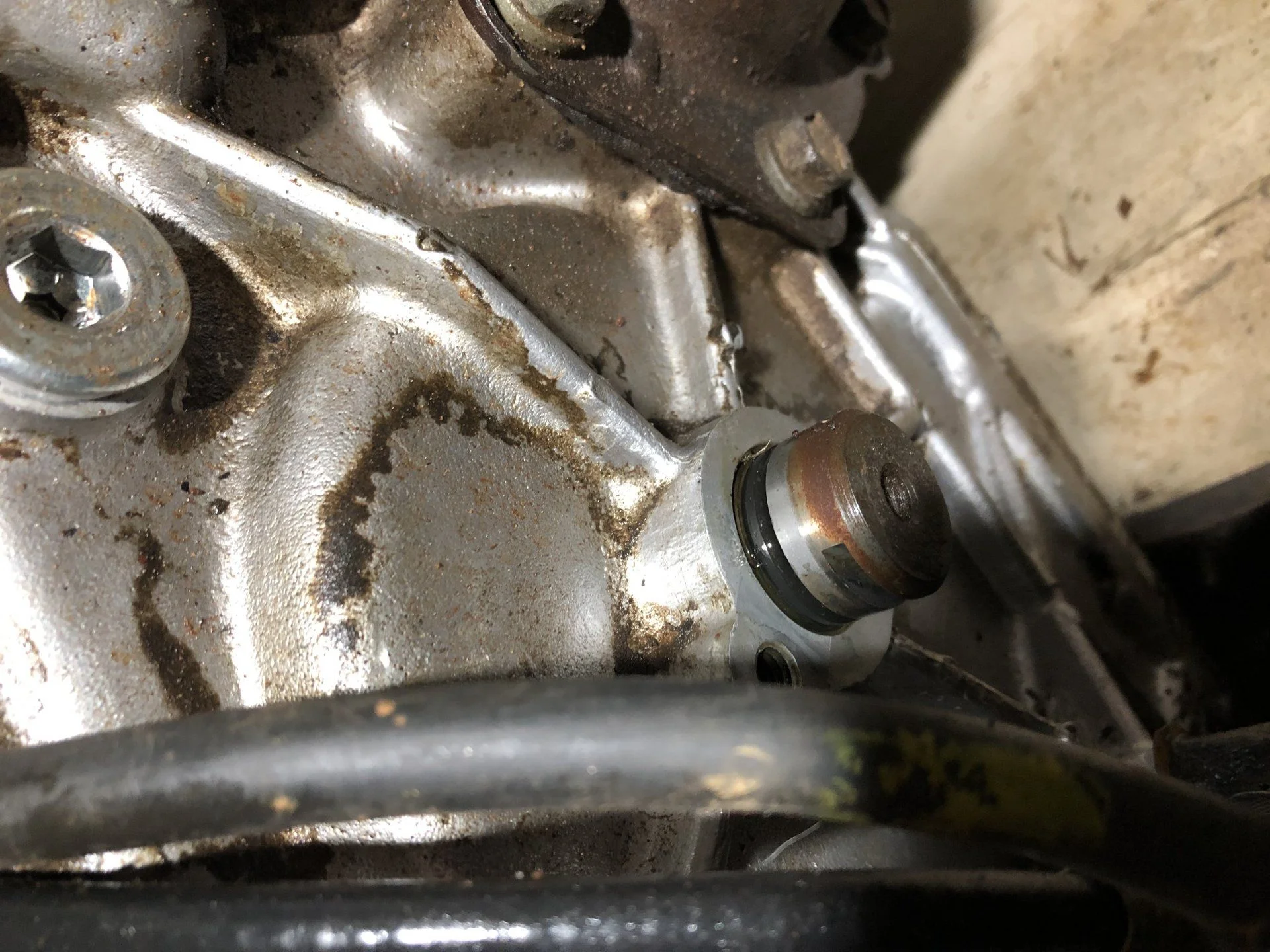

I did this yesterday.

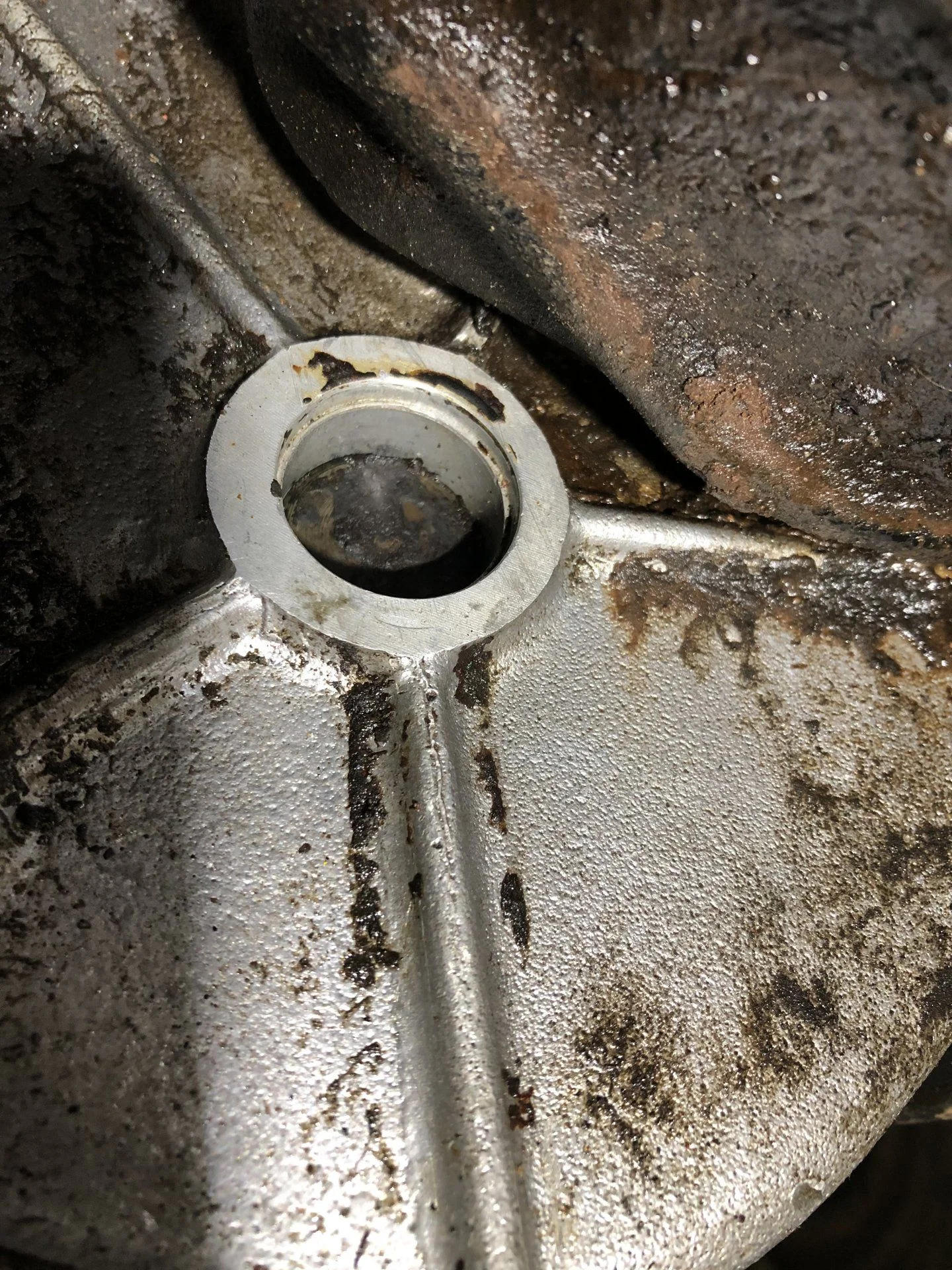

Discovered there was no freeze plug in place on my Tcase.
The shaft slid right out without any tools, just a push from the freeze plug side and some twisting, but only using my fingers.
Here is the pic of the shaft pulled out to where I could get the Oring off.
Here is the other end where the freeze plug goes, showing in the position when the Oring was exposed.
I would definitely recommend pushing the shaft through to pop out the freeze plug before attempting to remove the Oring, as it helped to have a finger on the freeze plug end. That made it easier to keep the shaft from moving too far out.
I was not able to get the oring off in one piece, it ripped in half pretty easily, but I had already order a replacement. They are no longer available from toyota, but FJ Parts in CA had one. I am glad I bought it ahead of time since it ripped and would have been difficult to buy the correct size.
I used the slot where the locking tab sits to help work the new one over the shaft, then it slipped right into the groove and the shaft slid back into place no problem.
Now time to get a freeze plug.
Nice work and thank you for posting the images. These will help others in future. FYI the plug is still available from Toyota. When you install yours, use some silicone before pressing it in.
Consider this. The shaft has a slight interference fit in the housing when both are in good condition. When a shaft slides easily, it is an indicator that the shaft, the housing or both are worn. This amount of wear is usually not critical to the gear contact. But it does increase the odds that the case will leak, even with a fresh Oring.
Thanks for this. Not having anything to compare it to will make most of us think it’s normal to have it easily slide out. In my situation, the leak is not caused by O ring or shaft wear. It’s worn out around the case.
