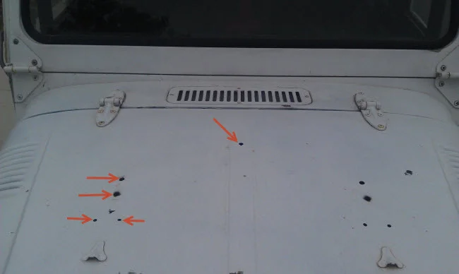

I have a 1972 FJ40 and am looking for missing parts for my hood. However, I'm not sure what parts I need as I bought the FJ40 as is without the accessories on the hood.
I've attached a picture of my actual hood and have added red-arrows that point to the existing holes that I'm looking for parts for.
Can you decipher (based on the holes in the picture) which parts are missing? Extra bonus if you can send me links to vendors that sell the parts :)
Hole in the center is for the windshield washer nozzle. The two holes on each side closet to the windshield are for the pads the windshield rests on when folded down. The other tow are for the hold down clamps for the windshield.
W/S washer nozzle, windshield rests and windshield hold-downs

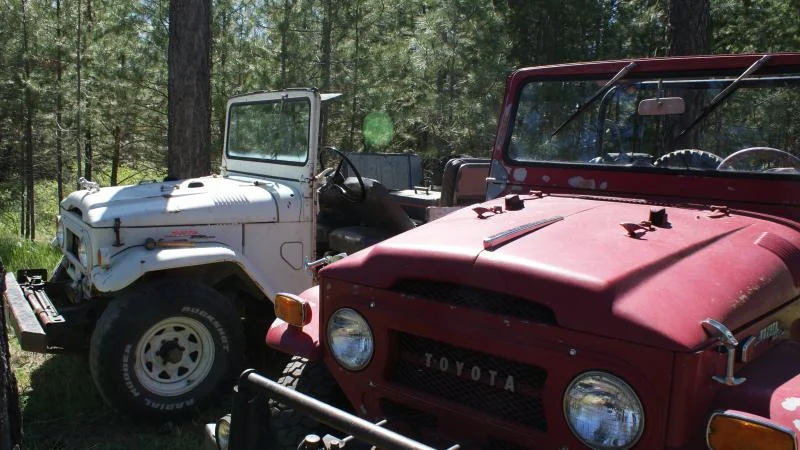

What do you mean early style hood? In 72 they went to the one piece hood as shown in the picture. 71 and earlier had a split hood with a chrome hood spear at the front...which is not in the picture. His hood is correct for his year fj40.
Example below, my red 71 with correct hood, my brothers 67 with 72+ hood. Now you can see the parts you are missing :)
His hood is the right one. I just referred to the point that in '75 Toyota changed the hooks and windshield rests. My mistake as I didn't payed attention that earlier Cruisers had different as well.

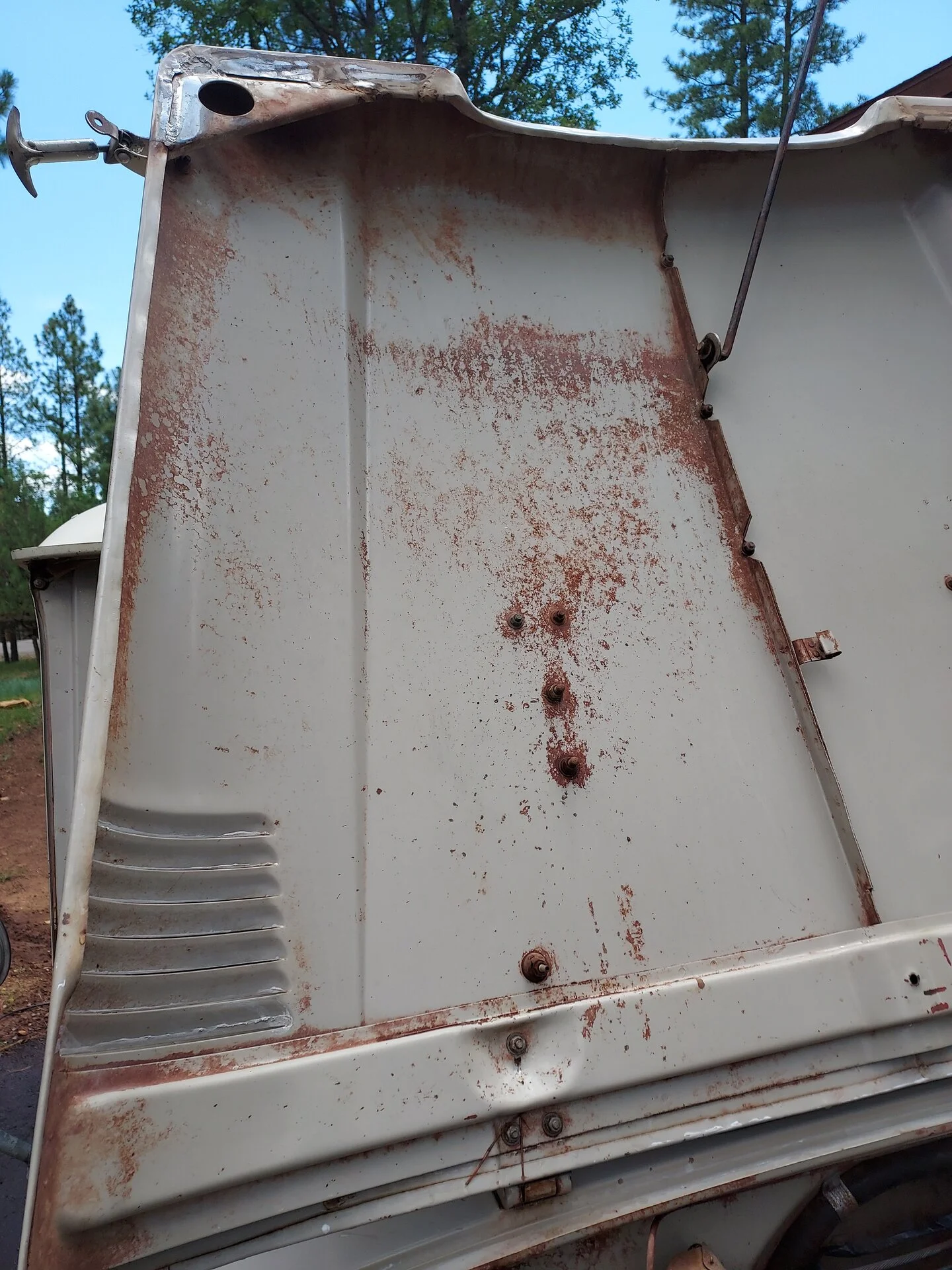

I have a 1971 hood with the crest hood ornament (split hood) and have two holes that I always thought were for washer fluid nozzles but they seem slightly over-sized. Any ideas? They are between the hood hinges and the windshield frame bumpers.
Those are where the washer nozzles go. Original style has been gone for as long as I can remember. What I got as a replacement were all gray plastic. Original were chrome that were seated in where piece which I'm not sure what it was made out of. To my knowledge 9/67 was when the washer became standard on all US models. When the one piece hood started it switched to a single nozzle that has two spray nozzles. Here is where the nozzle located on a 70 FJ40.
