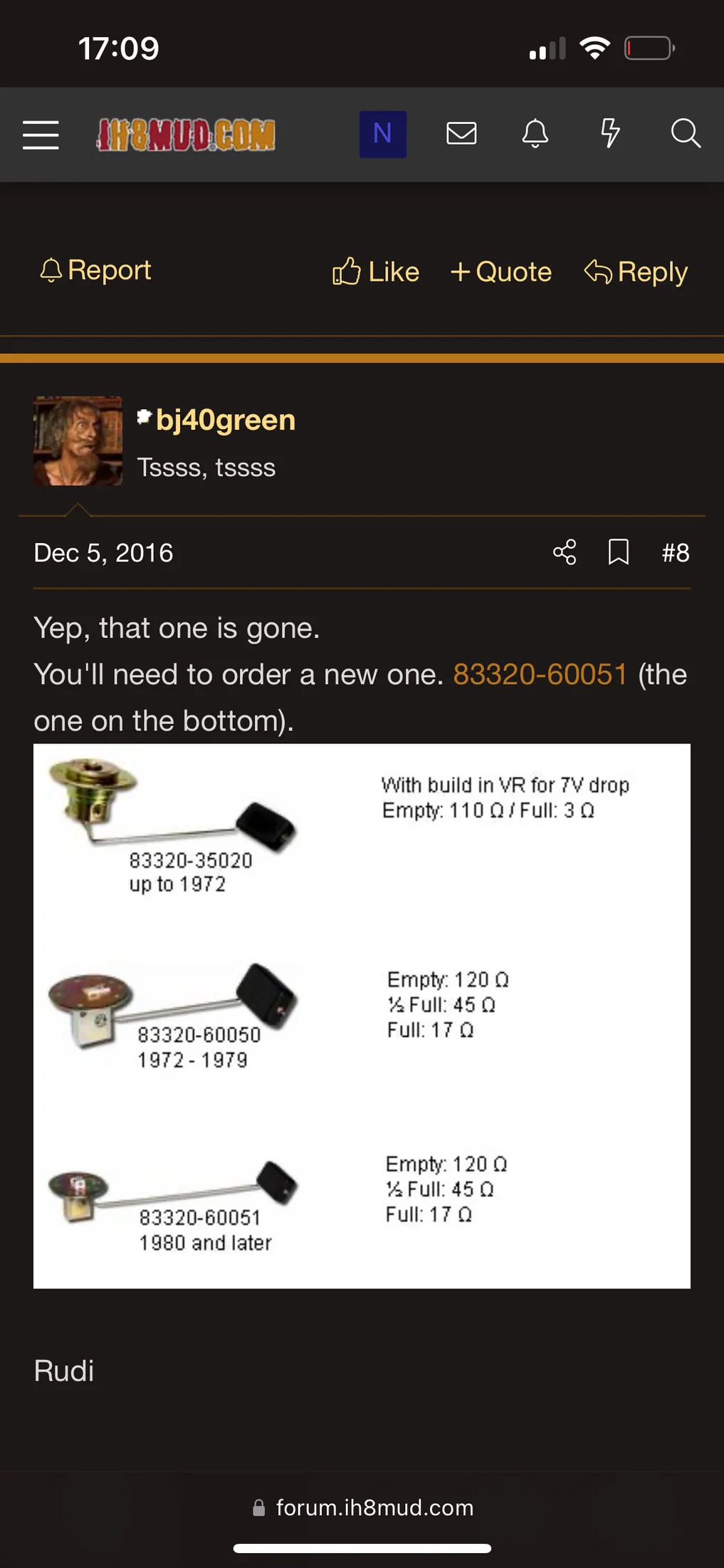

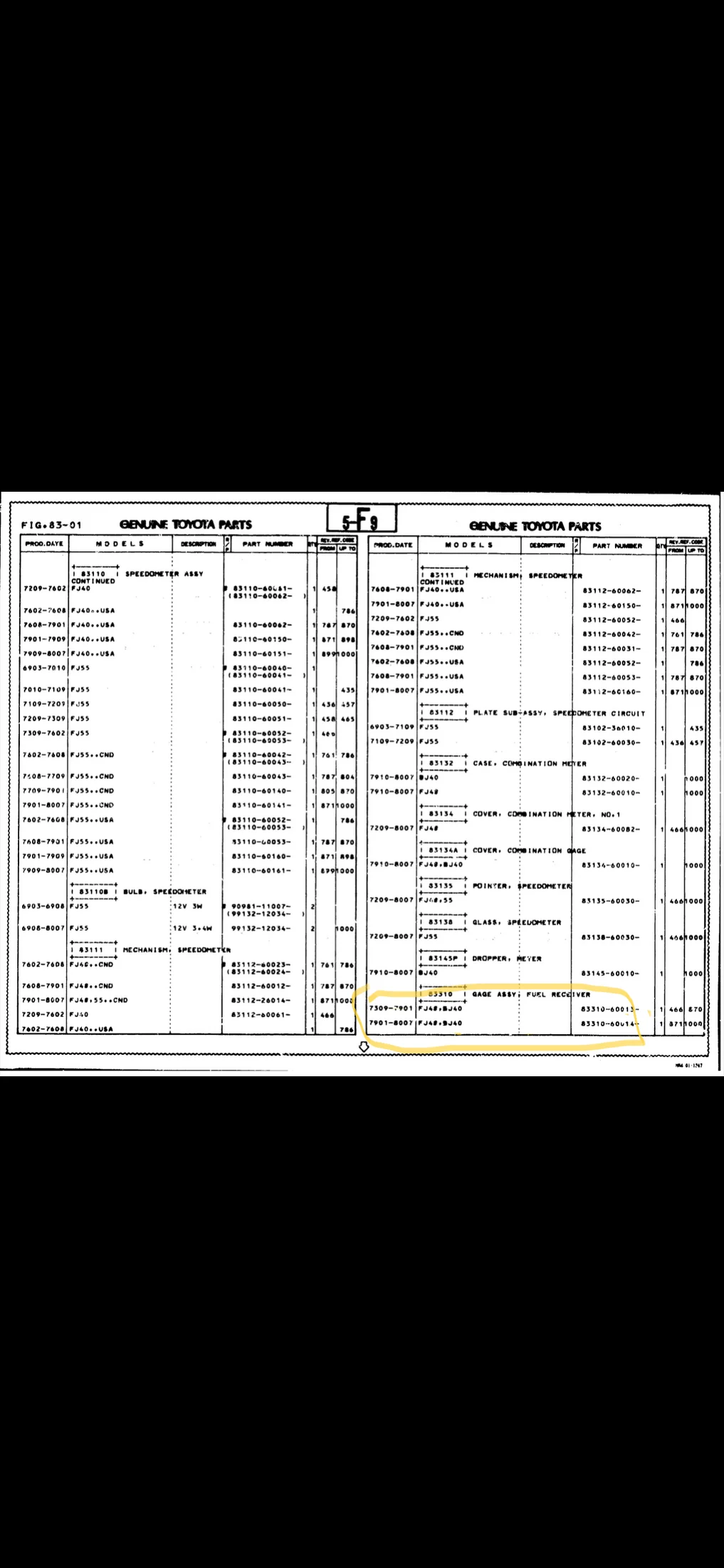

Can you tell me if a 83310-60014 works for 9/74 production date. Parts list I got from forum has 83310-60013 for ‘73-79 but the ohms on the senders ‘72-79 and ‘80 on. are the same. I also see Toyota Parts Dealers listing the 83310-60014 as being for ‘72-80.
