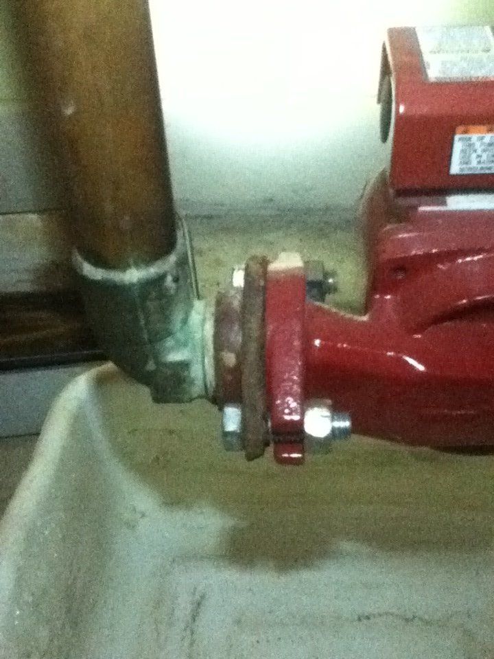

Had a constant drip from the flange to the pump... Cleaned it up... Ground away the rust ... Installed a new seal...
Now I have a new drip :(

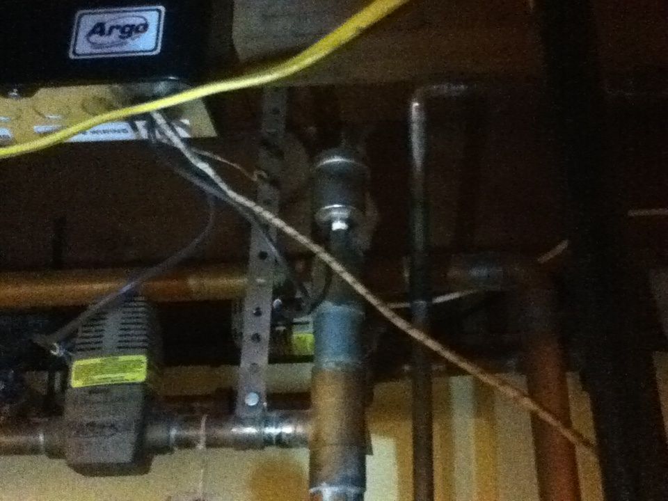

In the second to last pic is the relief valve? And the down pipe from this is dripping ... About one small drip every two minutes or so
I tried snapping it open and closed.... And also taped on the outside with a small wood mallet... But still seems to be dripping
Will it stop?
It's nowhere close to the 30lbs that it should open... Maybe rust speck causing a bit of a drip?
is that a T/P (temperature/pressure) valve or just a pressure valve. I don't see any insulation on the pipes. Is this a hot water boiler? If it is did it start leaking when you repaired the pump flange? water cooling off could possible cause that. May get lucky and it stop leaking after a while. I'm surprised to see a pipe just end at the floor. Here it would have piped to a drain or outside. I haven't changed a T/P valve in a while but don't remember how must they but guessing not that much. Last picture shows the automatic air bleed. Is that leaking also? I take it that is not potable water. Not sure if that is Bell & Gosset pump or just a look alike. The ones for potable water are bronze color. If that flange starts leak again I would replace the flange threaded to the pipe. Looks lie it distorted from over tightening.
Right on all counts I think... The pump is a BG ... No insulation on pipes as we have a half finished basement and the little extra radiant heat from the pipes is ok :)
Yes hot water baseboard heat...
Yes started dripping after the flange fix
The pipe does end at the floor... But... I think it is a common thing for our area as all the homes I see have the same ... However some homes do have dirt floors :)
The air bleeds (I have two) were both seaping ... But... The lower one stoped and upper one seems to have stopped as well after awhile
Not potable... Didn't drain the whole system ...
Yes again in the flange being distorted ... I used a large washer to increase the surface area the bolts were compressing against... The grease monkey that originally replaced the pump used small bolts that bent it ...I Bent it back some
I have a new flange... But... Could not get the old off ... There was some yelling at it... But ... It didn't scare it off ... Wire wheeled and ground down the one on it... Seal is good now :)
If I run into an issue again I got another seal ready to go as well LOL
And it closed again? Lucky man. Reliefs don't normally move off the seat so they usually go on leaking once they do. You may want to replace for safety sake if it's never been done. The automatic air release has crap in it. When you know you're done with everything fill and let them do their thing, bleed off pressure but don't drain, and clean them out last. You can unthread the top cap and the guts come out like a cartridge. Usually find these with the bleeder tightened down........not very automatic that way.
