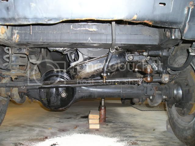

pic of the 4x4 labs arms on my axle....
Or... go with r/h drive high steer flipped to the back side of the axle running above the low pinion third... This would allow you to run the stock steering box which I assume hooks up on the back side of the axle. and it'd keep your tie rod out of harms way on the back side of the axle. Post some pics of the current set up.
Hmmm... Looks like the tie rod might interfere with the pan hard link. You may have to go 4x4 labs steering to get the tie rod on the back side. I thought the drag link from the steering box might be on the back as well but see its not.
Isn't the drag link in front? It goes from the steering box arm to the knuckle. The tie rod goes from knuckle to knuckle.
