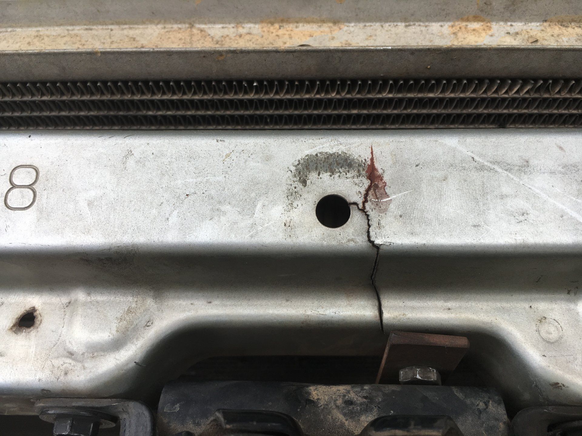

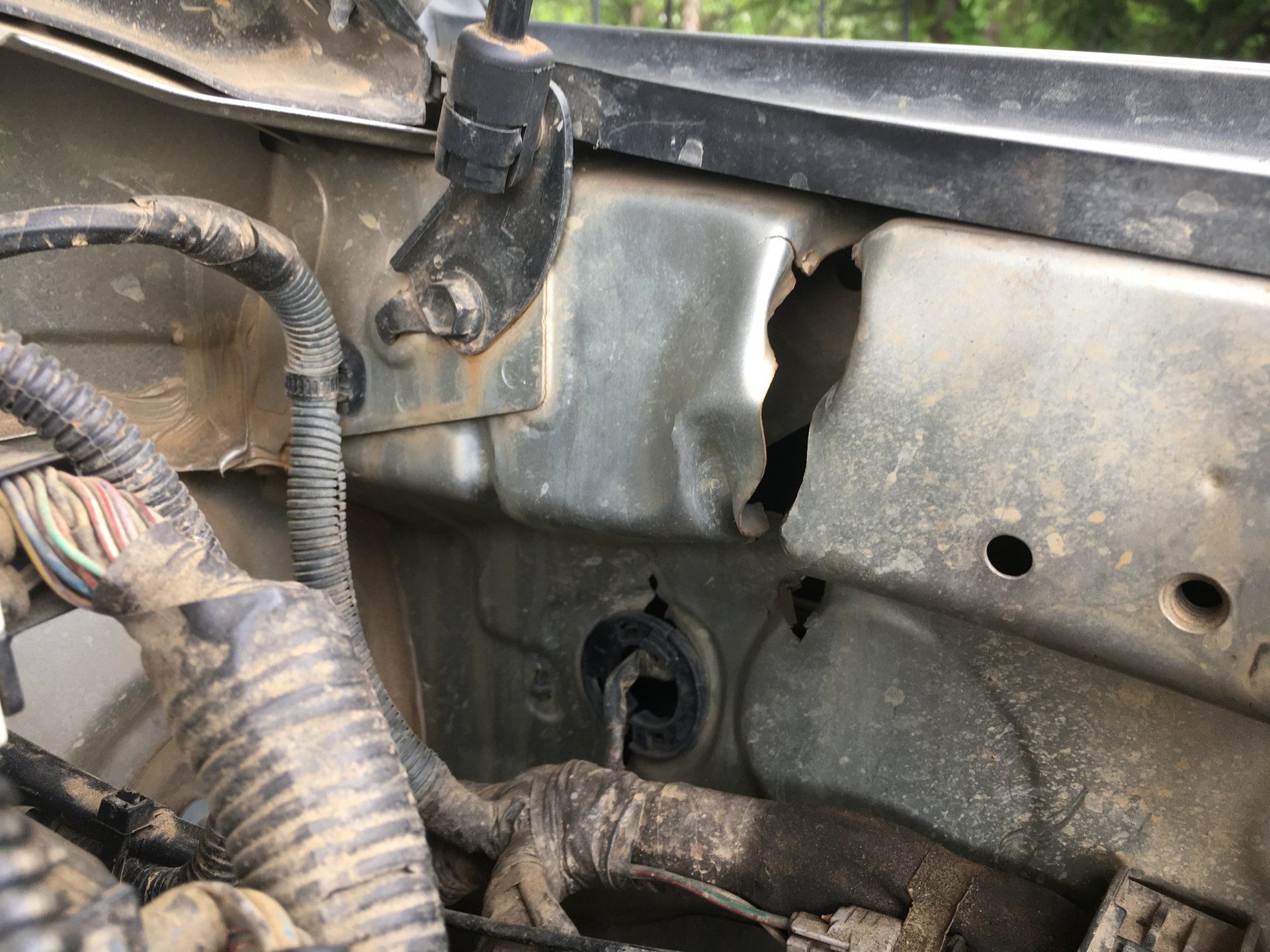

If you look at the factory dimple right in front of the hood shock mount the cracks start right there. The one I looked at Saturday had cracks running vertically from the dimple downward. I did not grab pictures. Underneath from what I can tell they crack from the underside as well along the lower edge. These cracks were completely though the metal and not just a surface crack.
Mine started early around 2007 and I ignored it for 10-11 years. Eventually went to a dealer body shop and had the core support and both inner fenders replaced. Around $3K. Didn't do any exterior panels, so paint match wasn't an issue. But, it took 10 years for it to be a problem and I tend to wheel pretty hard.

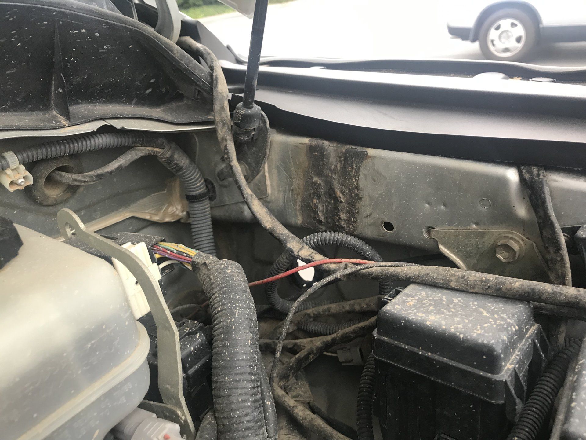

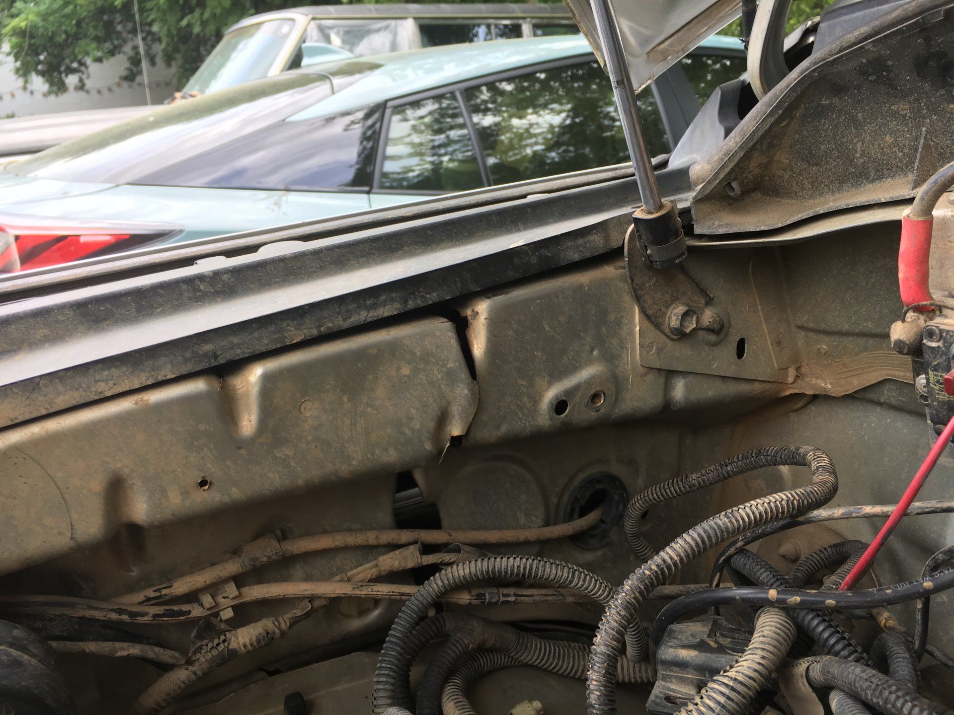

When it started to really fail, the inner fenders were dropping and it affected the radiator core support. My hood latch was not "fixed" and the hood would move up and down (though it was secured in the latch). The outer fenders showed no visible signs. I lived with it as long as I could stand it. I always said I would drive it until the fenders fell off. . .well, they almost did. Not the battery sits on the front of the driver side inner fender. I also have a large ExtremeAire compressor sitting on my passenger inner fender (where a lot of folks put a second battery). That weight contributed to the failing, I'm sure.
1) Driver side

2) Passenger side

3) Hood latch area
1) Driver side
2) Passenger side
3) Hood latch area
Thanks for the further insight on this. Looking at your photos and just ran out to check for any signs of cracking near the hood latch. Mine is fine so far.

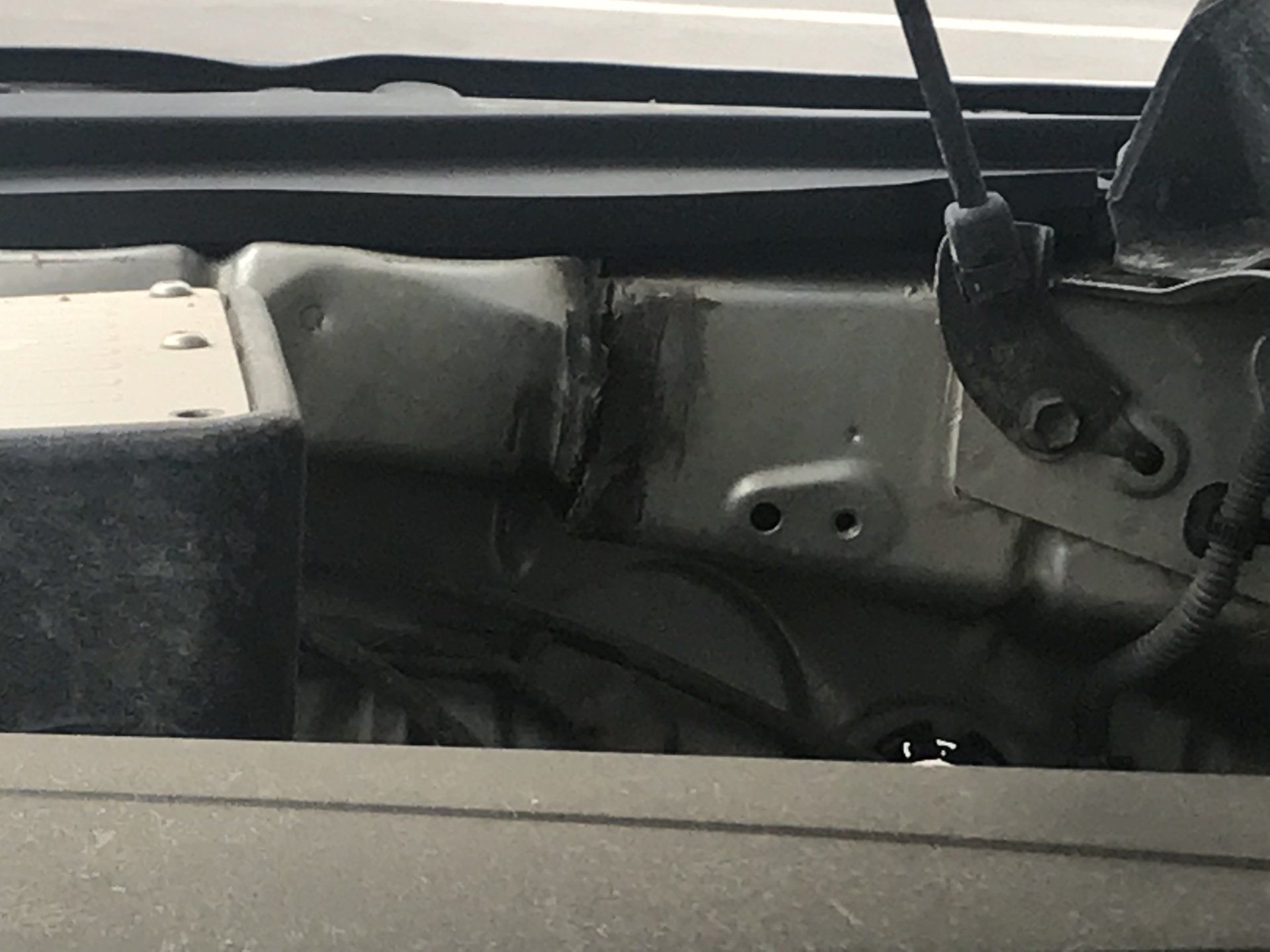

Original owner must have made a repair, not sure who or how they did it, but looks like preventative maintenance from original bulges.
The person I purchased it from stuffed the passenger side wheel into the fender well, which destroyed the integrity of the original repair on the passenger side. Drivers side repair is still intact.

2008224
1) drivers side intact repair
2008225
2) passenger side damaged repair
