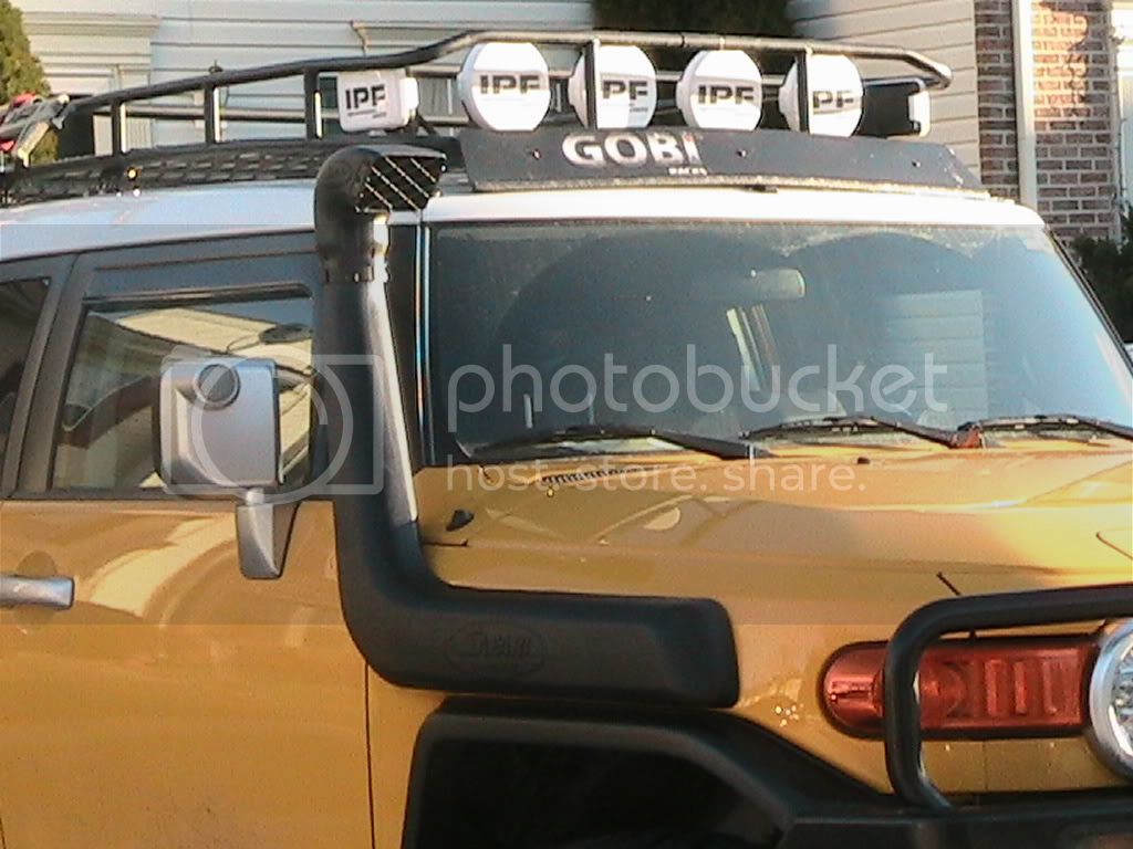

I got mine put on. Here are some pics. My camera ran out of battery so the pics are low quality form a camcorder.....sorry.
-Ben
