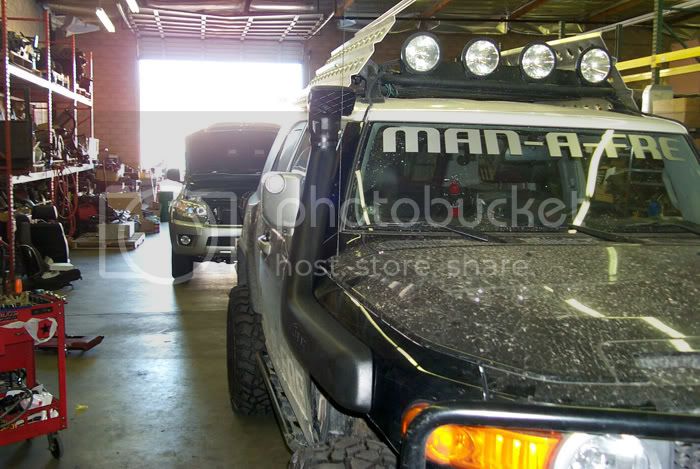

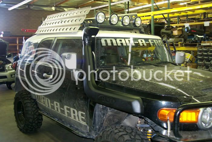

I got my snorkel on October the 17th, and it was installed yesterday.
Here are some pictures.
https://forum.ih8mud.com/showthread.php?p=2741379#post2741379
Buy a bag of the clips from your dealer that hold on the inner palstic fender liner, as they break easy.
I would pick up 10 to be safe.
And get an interior panel removal tool that slips over those clips.
This way you stand a chance to save some of the clips when removing them.
Part number for the clips you need from Toyota is:
90189-A0002

Thanks, sure is getting the rig looked at a lot, as there are only three FJs in the entire US with them.
Some look at it weird, they do not know what to make of it.
Price for installation will vary, but figure on 3 to 4+ hours of labor.
Maybe less.
I could have done this myself with some help and a warm garage if I had to.

Hey where did you get those sand ladders on your roof rack?
