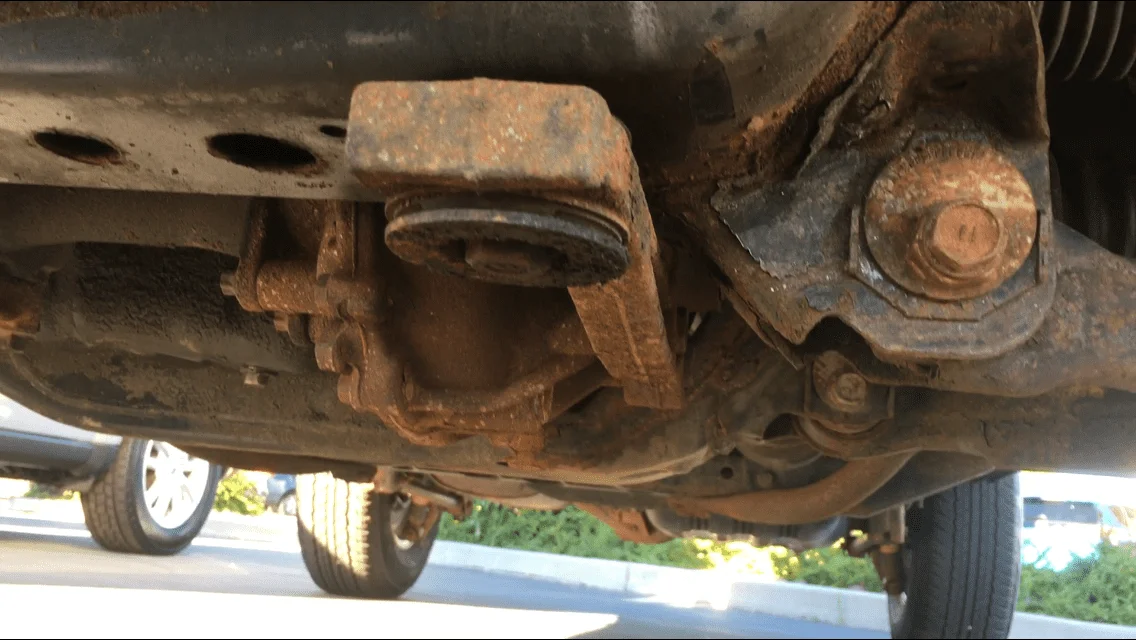

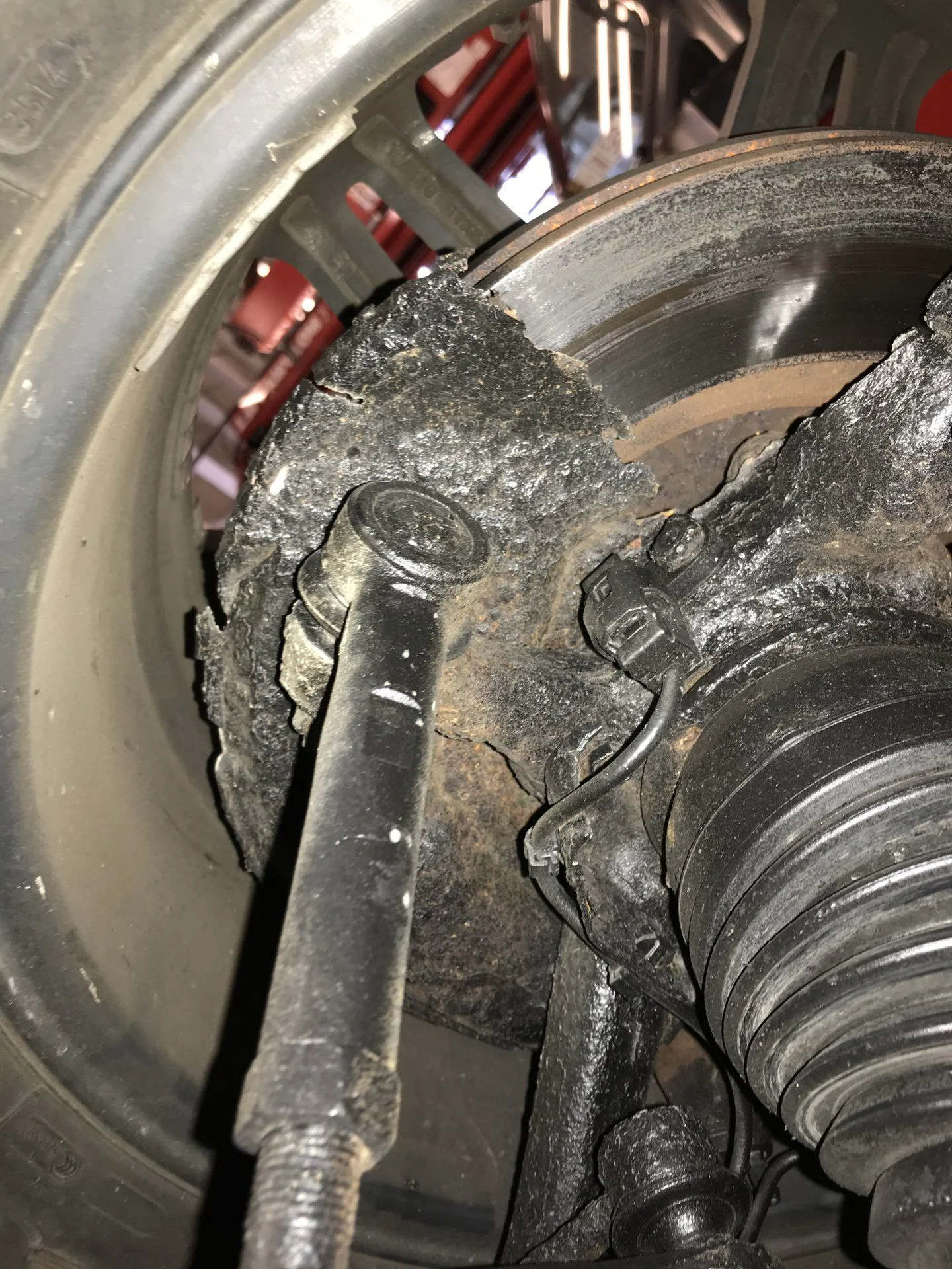

Was it parked in the ocean ? Where from on the east coast. Here in Georgia on the east coast is not going to be rusty as a rule but get north of Virginia and you see more snow and a lot more rusty cars

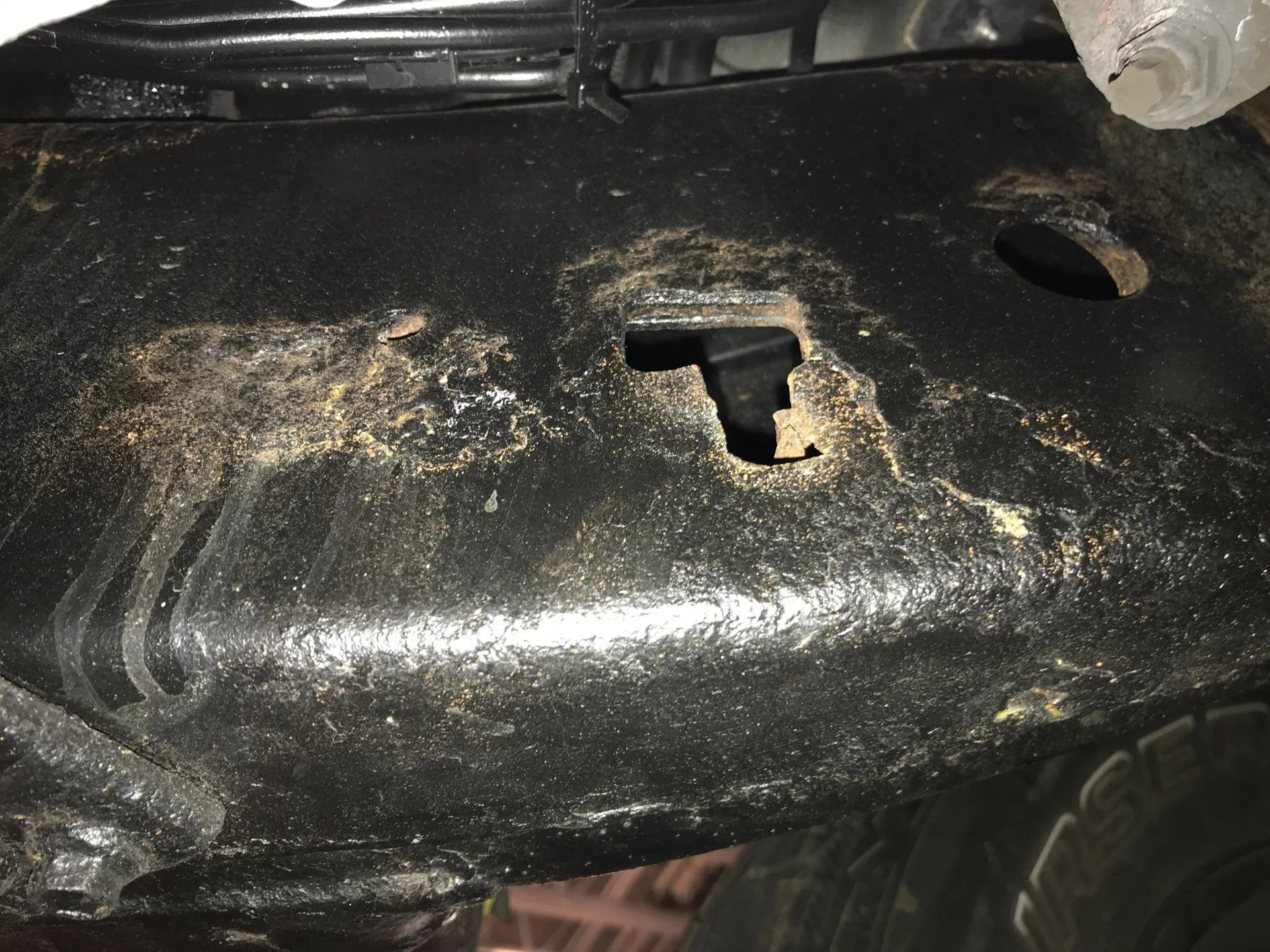

That totally sucks. I've never seen an FJ Cruiser frame anywhere near that bad. For that low of miles I can't fathom what sort of conditions that lived in.
Yeah, that is pretty bad..... I'll pm you my email and I can look at the contract. Even "as-is" I am not sure they can sell you something that is unsafe. Maybe contacting the Better Business Bureau is a good start. Let's look at the contract and see the fine print.
Massachusetts is its original home.
1 out 5 for condition on the rest of the car I would give it a 5 for how old it is. Besides the frame the car looks and surprisingly well like its brand new. Even my OCD father think so.
Carfax has no damage reports of floods on it. Clean Carfax.

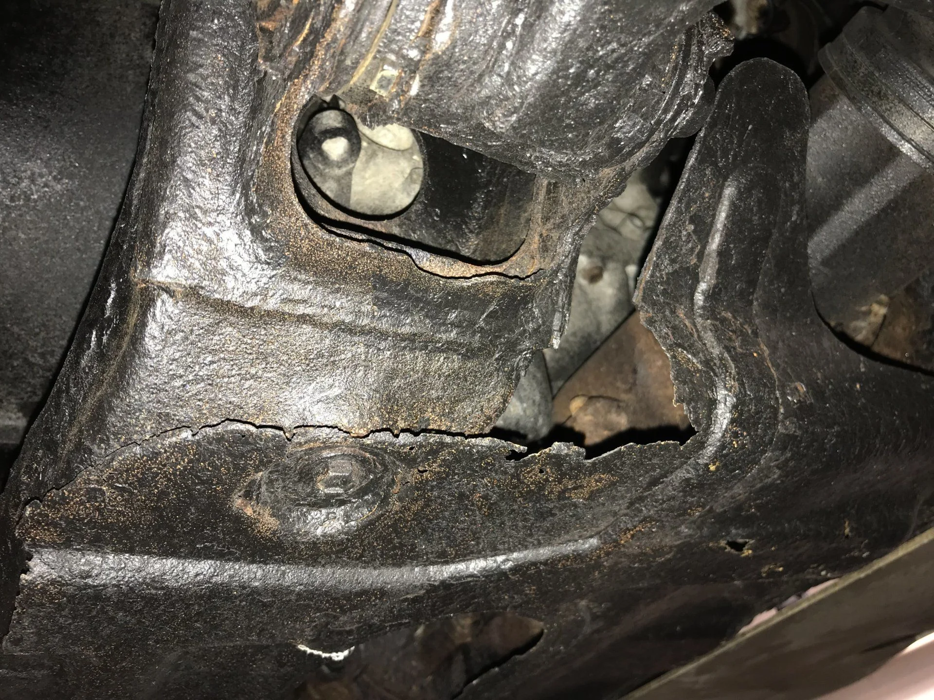

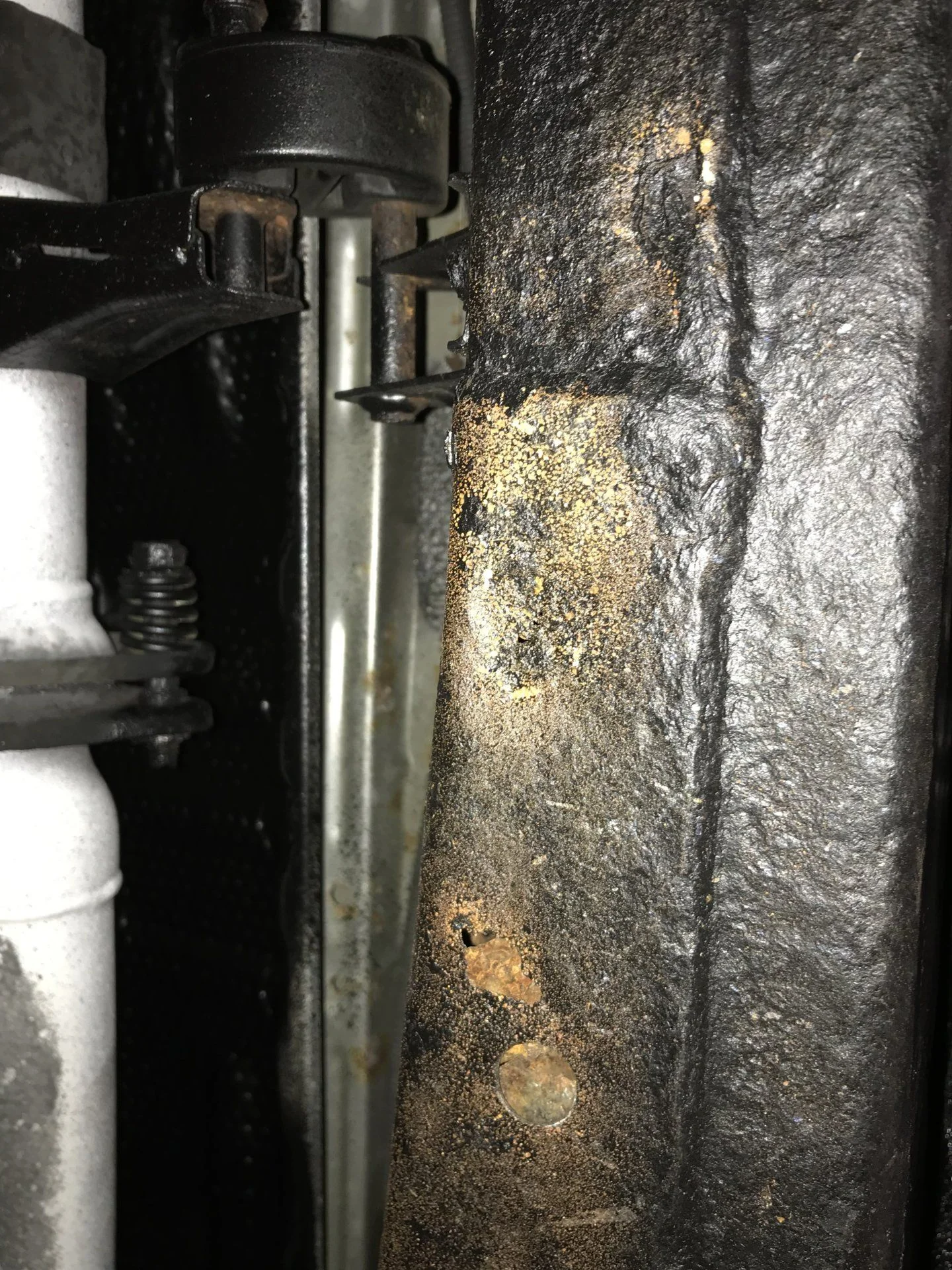

Holes aside, the experienced/trained eye (not meaning that as a slight, OP) can tell that frame is jacked- you can tell by what looks like pitting under the paint.
I suppose the silver lining is you will always know what to look out for from now on?
I am sorry you are having to deal with this, OP.
Holes aside, the experienced/trained eye (not meaning that as a slight, OP) can tell that frame is jacked- you can tell by what looks like pitting under the paint. ..
