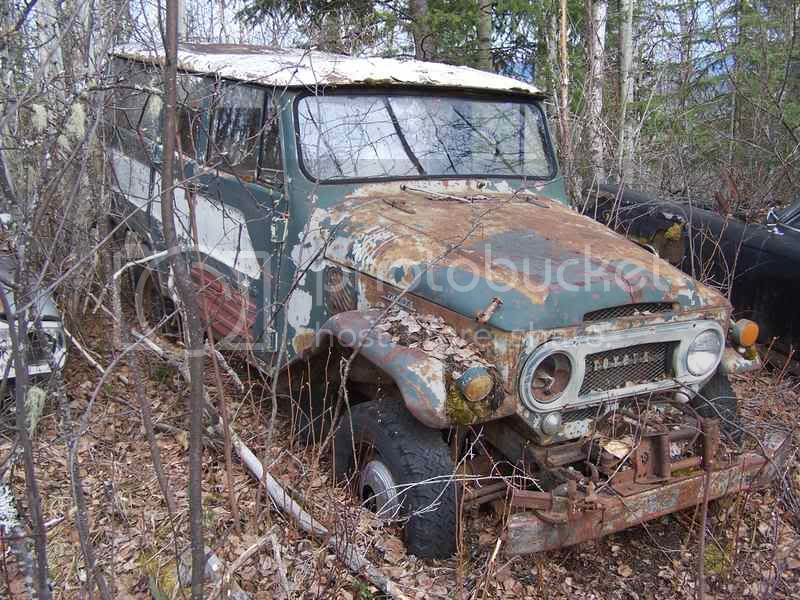

well i recently was offered this beautiful piece of technology out of the blue and wasnt really sure how much of a trainwreck i could be getting into. i've seen afew others on ih8mud and realized how rare these seem to be. its your typical rust wagon but have no idea the availablity of parts or interchangability between the 40 series, same drivetrain? what can i look forward to as far as replacement parts that will work? its been in the woods for awhile and will need a new brake system for sure as well as motor work etc.
any suggestions?

Oh hell yeah. Save it. If not for yourself then for some other worthy soul. It looks to have much potential. The drivetrain and axles are same as a fj40. So are the fenders and front bib and the hood for the most part. Dive into the 45 section here and learn how cool these are.
Dude what a find, HELL YES get it out of there and back on the road of recovery. If that was anywhere near me there would nit even be a question We would already be trying to figure out how to get it home, Please keep us posted and more pictures after you get her cleaned up.
nice find! it's even got the factory PTO and the early hubcaps on it. well worth saving or at least try to find it a new home with one of the guys on here. somebody would be stoked to have that old LV! :bounce:

I've never seen one with the factory winch installed.

love the vise on the bumper :) this old timer has some tales to tell! :)
This is the dream of most that seek the elusive FJ45LV, to find an unmolested Beast waiting for resurrection! From the firewall forward, FJ40 parts match, and are available. Rear driveshaft is longer, but rear diff is the same. This will have the Ball joint front axle,not birfield.
