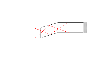

Are you hell bent on keeping the Z design? What you could do is just angle the frame up like Chuck did. With the departue angle as bad as it is on a pig I wouldn't think that the extra 4 inches horizontally you gain would help that much. Plus with a gradual slope to the rear it could provide a better "ramp" to have the ass end slide off with. And another benifit is that you have one less weld on your frame thus there is less worry about every weld being 100% at every joint.
I'm kinda anal about how close to perfect I can modify my rigs. How outta whack is the rear frame? Only the PO knows if he got adequate penetration of those buttwelds. Fishmouthing the ends & plating over is the *proper way to adjoin those rear sections. I would source a decent rear frame from another PIG & start over. Also the stresses in those joints will fatigue more easily than a continuous bend (like I did on mine). I don't see why you'd have to source a new tank unless you bobbed it like I did. Lastly, I think I gained ~5" from the frame mod. It doesn't seem like much, but I had to add a 2" body lift to get the body leveled out @ the rear.

I went back out and looked at the frame; the left is fine, whereas the right is tweeked maybe 1-2mm off (not as bad as I thought). I had a second idea: after making sure the welds fully penetrated the outside of the rails, take some 1x1/4" strap and weld some stringers inside the frame in an X pattern across the cut areas. Then box the inside of the frame rails, and plate the outside.
The reinforcement stringers (for a lack of a better word) are in red. (and yeah, I mastered MS Paint! Alright!)
