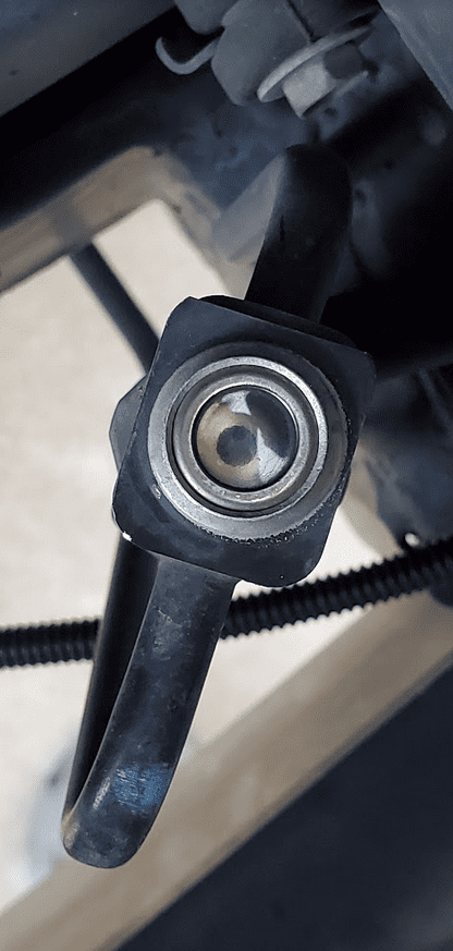

  2. Checked the Glass Sight and couldn't see through the glass at all. I even though the glass may have been worn

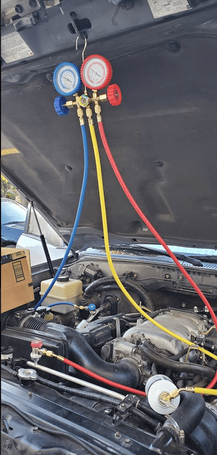

  1. Bought a set of manifold gauge, and confirmed there was 0 psi from L and H ports.

The following picture show how I set up the gauge and scale.

This picture shows the Glass Sight is free of bubble and can be easily seen through.
    • So it must be leaking somewhere.

Full Charge Procedures:
  1. Now it's ready to recharge the system.
  2. Tools/Parts needed:
    • Manifold Gauge
