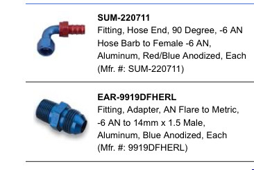

I want to use my original section of trans coolant hard line and adapt it to 6AN flex line. I need a 6AN to 10mm Compression fitting. Can't seem to find one. I got a 6AN to 3/8 compression but don't think I can make that 3/8 I.D go over the 10mm hard line. Ideally a 6AN to the original flare on the land cruiser but I think I'm dreaming. Any good source for the fittings I need?
Search at summit racing .
Here’s an example- but not exactly what you’re looking for
The better solution would be to use a female 6AN tube nut and flare the hardline.
