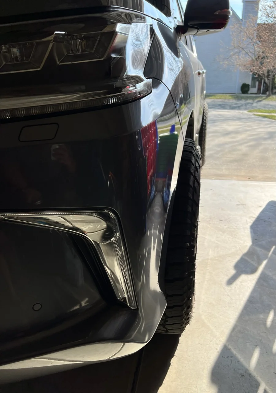

Just got these mounted.. 18x9.5 +0 and 275/70 Wildpeaks
