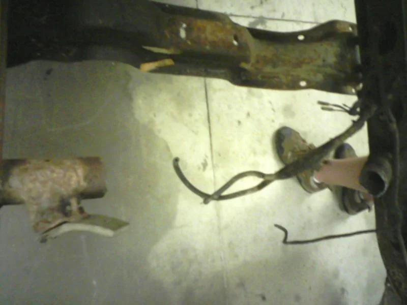

Below are some images of the PO’s modifications; first there is the cross member that he cobbled in note that it is about an inch and a half too wide for the frame and he used some kind of spacer to get the right height out of the tranny. You can also see how he had the springs set up so that he had some kind of shackle reversal. The motor mounts from this vantage point don’t look too bad but if you were to look closer you would see that they were twisted to the point of breaking before the motor was even fired up. The picture on the right is after I cut off his mess up front and replaced it with the new out boarding crossmember. More to come

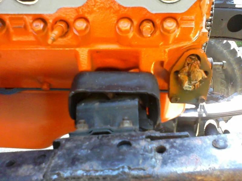

Here are a few more pics of the before. Top left is his front x-member with the spring mounts. Note that it is already broken. Top right is the back of the front spring mount. This was probably the best of the fab work done to it. And bottom left is the twisted motor mounts with the 350 it came with. Here you can really see how twisted it was.

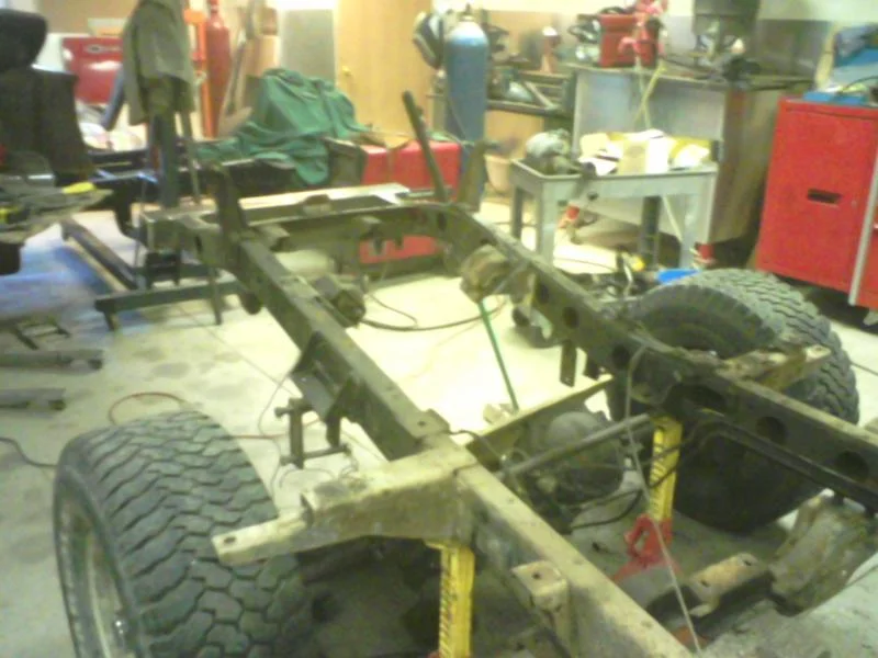

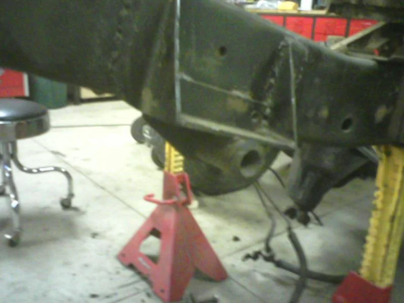

Ok after some hacking and whacking here are some pics of the progress. This is a few years ago but I wanted to give everyone an idea of what the starting point was. Top left was after cleaning up the front and installing my cross member. The other two are pics from a few hours prior to that when I had all the old work chopped off.

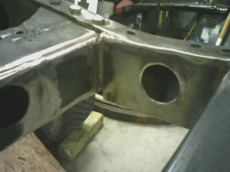

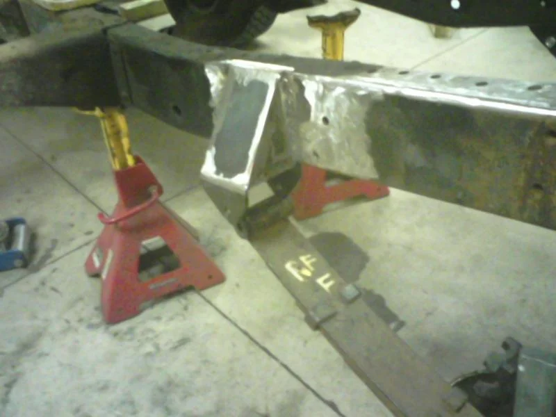

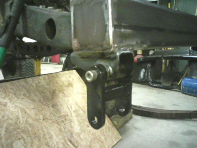

Now then.... Starting to put things back together. Though they are a little out of order you can get the picture. Bottom is the new front cross member and top right you can see it installed. Due to some perceived clearance issues (real or imagined) I decided to run my steering gear on the outside of the frame channels so I closed up the steering shaft holes. Top right I made and installed some new shackle hangers and you can get a bit of a better idea what the front cross member works.

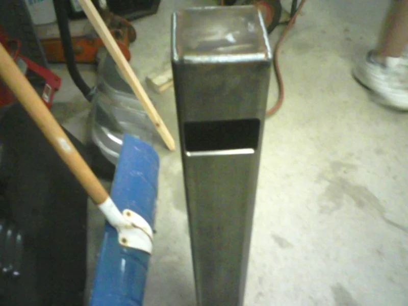

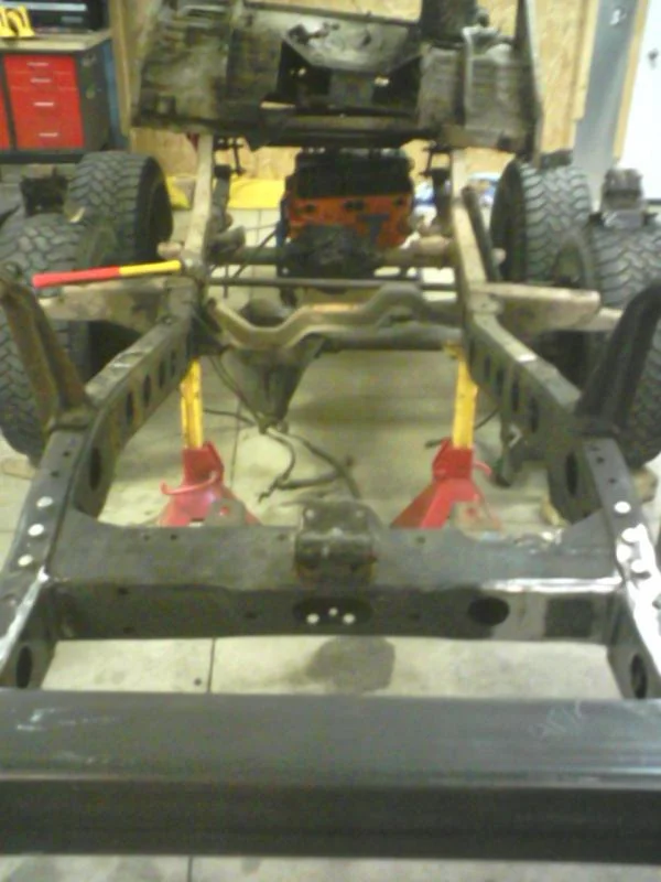

More progress on fab work... Top left picture if you turn your head 90 degrees you can see the care and precision the PO used to delicately cut the OE cross member out. Top right (no head rotation needed) is a picture of the back of the front spring out boarding. I used a couple pieces of 1/4" wall 4" square tube and a bit of time and came up with this. I would say it is at least a little better than the Po had in there. I also switched it back to the way Toyota had it from the start; Shackles in the front.

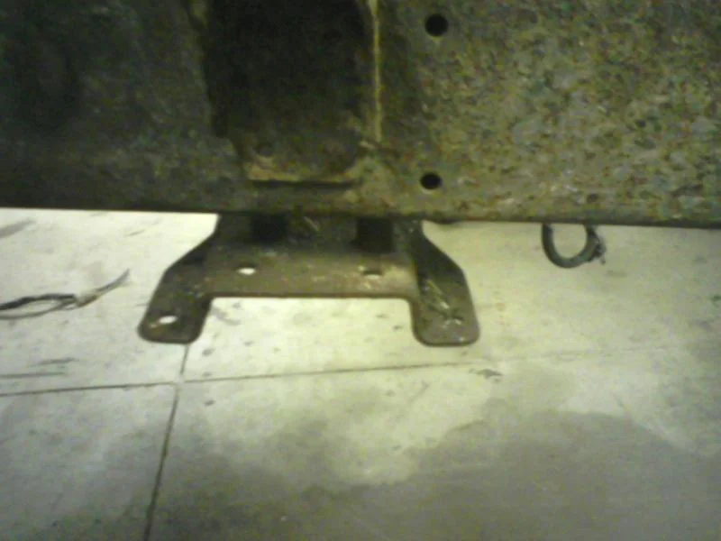

More progress. This is after coming back from powder coat I built sock mounts motor mounts and other bolt on stuff and had it coated separately hoping that it would make for a better look when done. I know that there are people who aren’t fans of powder coat versus POR15 or similar products but I can tell you that this coating is super tough.

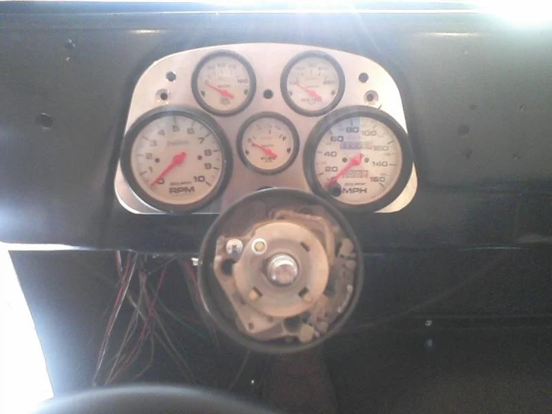

Ok- bouncing around a little here, But I am still trying to find the flash drive with my other pictures on it... Tonight I worked on getting the instrument cluster in. I got the aluminum Gauge cluster from Metaltech and I am totally pleased with it. It accommodated the Auto meter Phantom Gauges nicely and dropped right into the dash. On the Schedule for tomorrow is working on the wiring. The folks at Painless should think about changing their name to slightly less of a pain.... Not too catchy but more accurate. if there is someone out there who has worked with these with and picked up any tips I would love to hear them.
