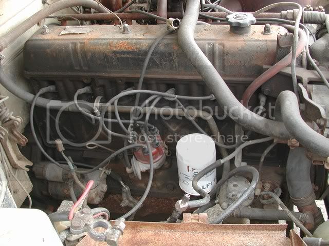

so if it like this:
its a 1 1/2f?

serial number on the engine starts with an f then like 542 number number shoulda wrote it down.. ok so ive got a rare engine nice lol...
