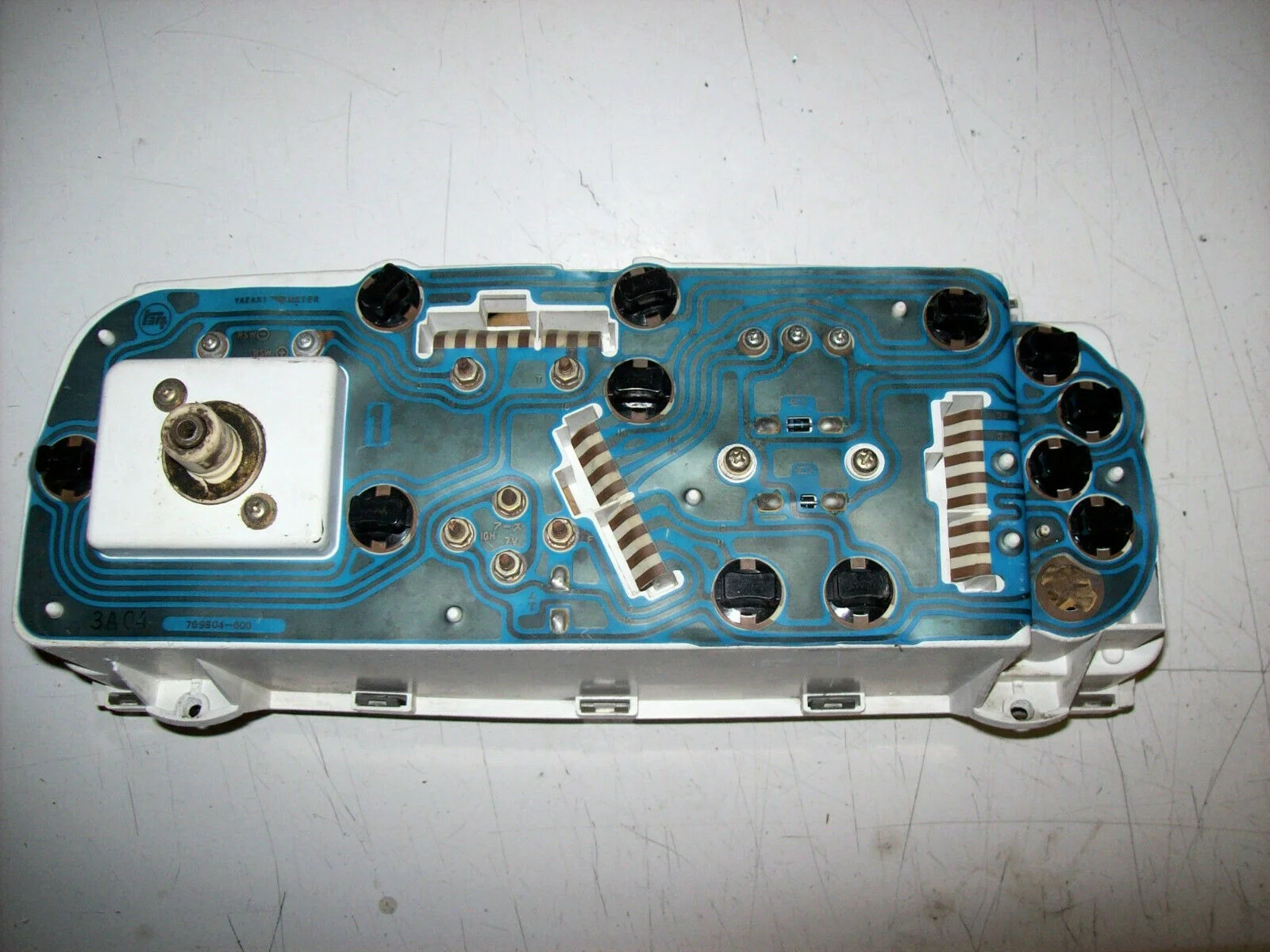

Well, ask the seller to send you a pic of the rear of the cluster which will show the harness connections. You have a late year 81?

Here's what the back looks like!
