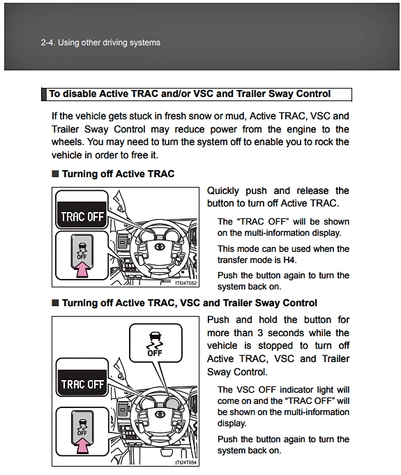

Active TRAC (a.k.a ATRAC) is on by default and can be disabled - at least that's the case on my 2013 LC200. I would refer you to the Owner's Manual:
HTH
I hate that ATRAC is in 4Lo only but at least this way there's one less button to clutter up the center console area haha.
It's not in 4Lo only. Please see above OM page stating specifically that it is in H4.
P.HTH
