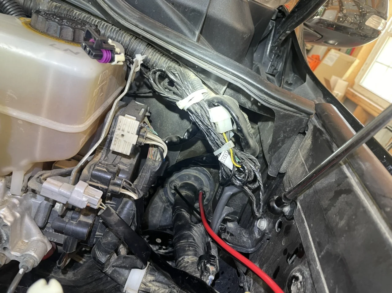

I'm running direct batter power into the cab for my radio. I cut the end of the grommet "tube" off but it still seems I need to poke a hole through the inside grommet with a scratch awl or something. Just wanting to make sure I'm not missing something or doing something stupid.
Answering my own stupid question. Yes you must poke a hole. After I did that, I pushed in a 12 awg solid wire in from the engine bay then connected it to the double 10 gauge stranded wire on the inside of the cab and pulled the double 10 gauge wire through the hole. That’s a lot of wire for such a little hole some silicon spray was needed to move the wire so it could be pulled.

Great video. I wish I had seen it before I did mine! FWIW, I used a heat shrink / solder connector to connect the solid piper wire to the 10 gauge wire I was pulling. It did break free but after I got the 10 gauge through. Silicone spray first would have solved that.

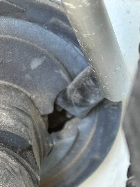

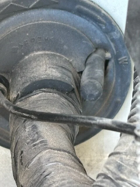

Searching through the always helpful mud threads on firewall access, I found the answer to my question of where but in looking at the extra nipple on the driver's side I expected to see a solid grommet but look like there are several pieces that make up the assembly. I found that surprising. Attached are a couple of pictures.
For my application, I am going to be running 6AWG wire to the second row of seats. I have not quite decided which side to do the run, driver's or passenger's side. I understand that the PAX side is a bit easier.
However, a couple related questions. Being that in the fuse/relay box there a several unused slots I am wondering if anyone has added a 50 amp fuse and run wire from there? I would assume some addition source wiring would be required. Seems like a reasonably clean option but then one is messing with the main fuse box.
The alternative is to attach directly to the battery terminal which I am curious if anyone has used a terminal fuse block? Which seems pretty clean.
