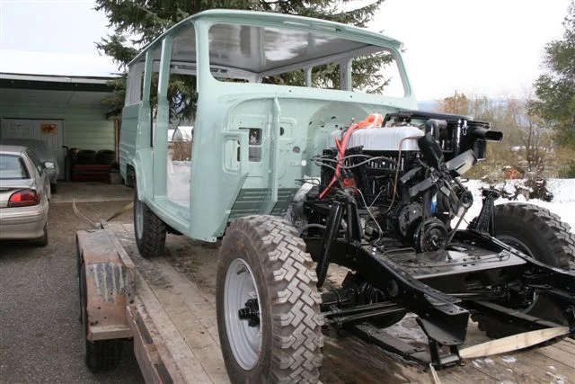

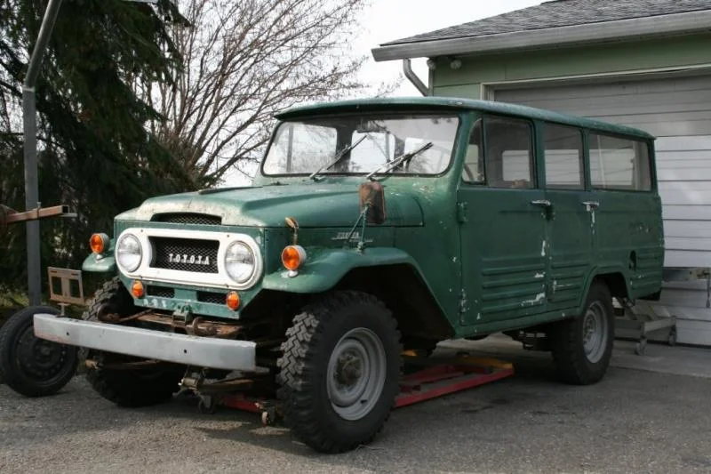

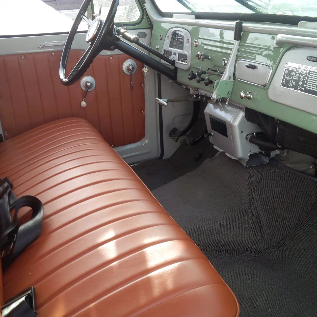

This restoration began in 2006 and should be done this summer. Then and now pictures below. Just got to get her back together!

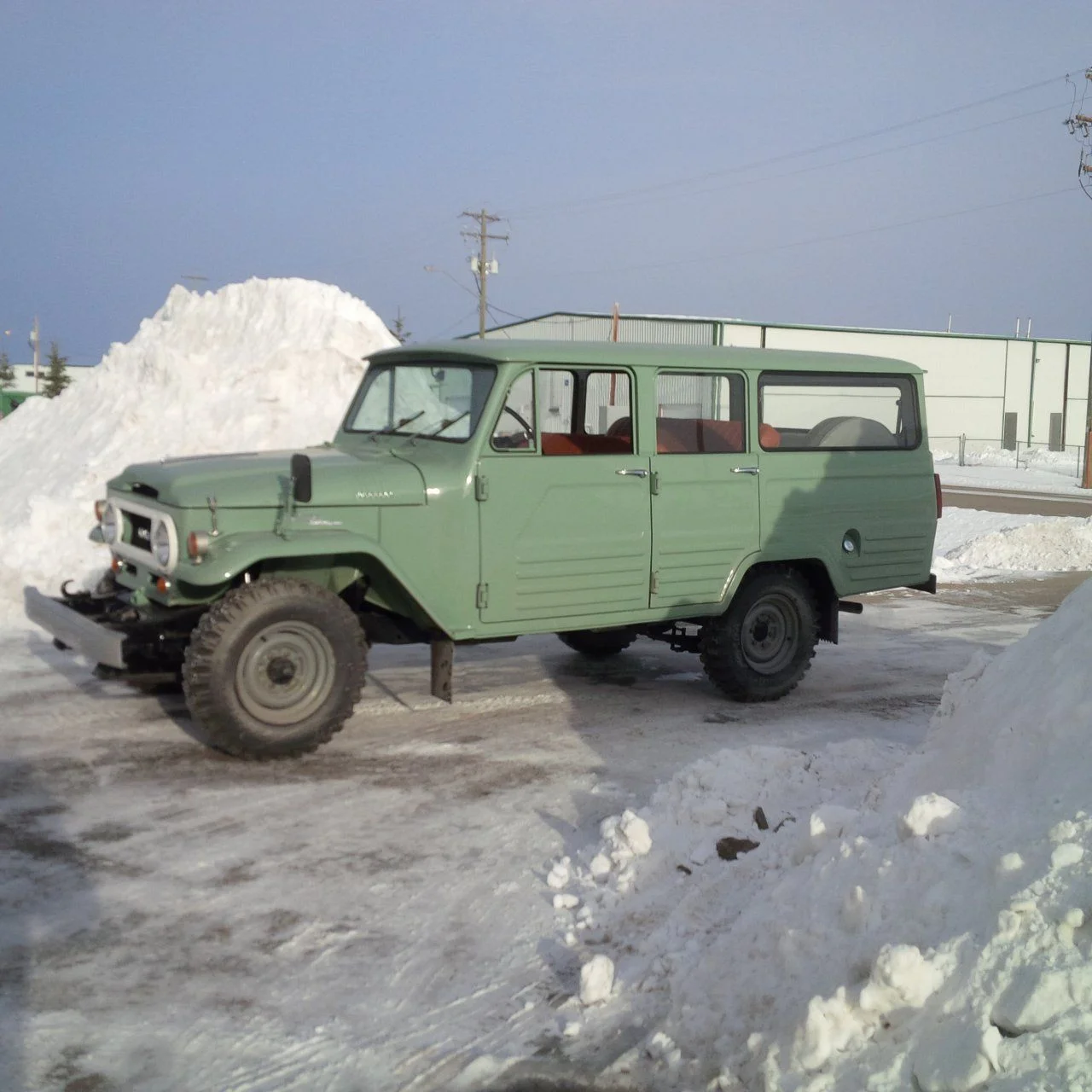

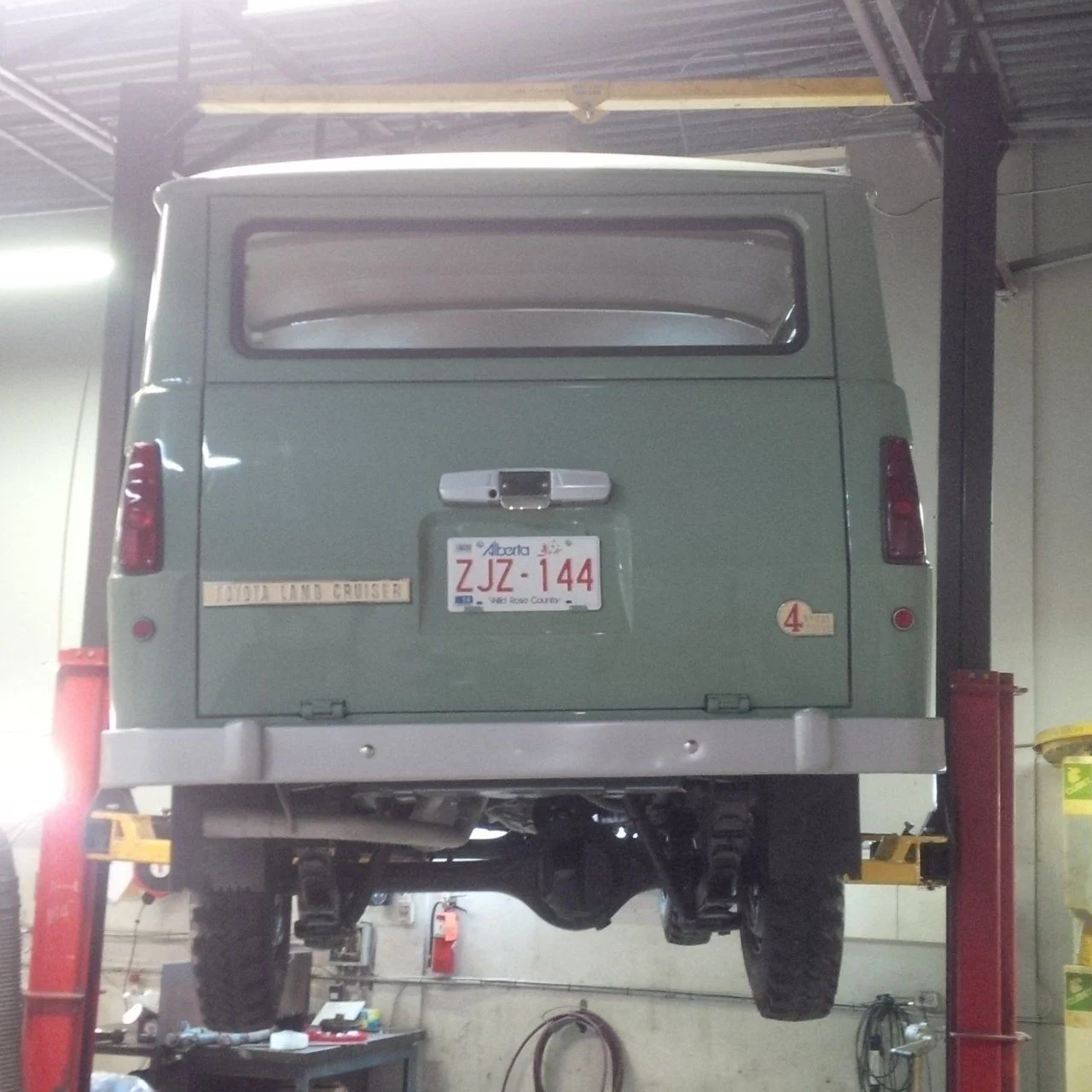

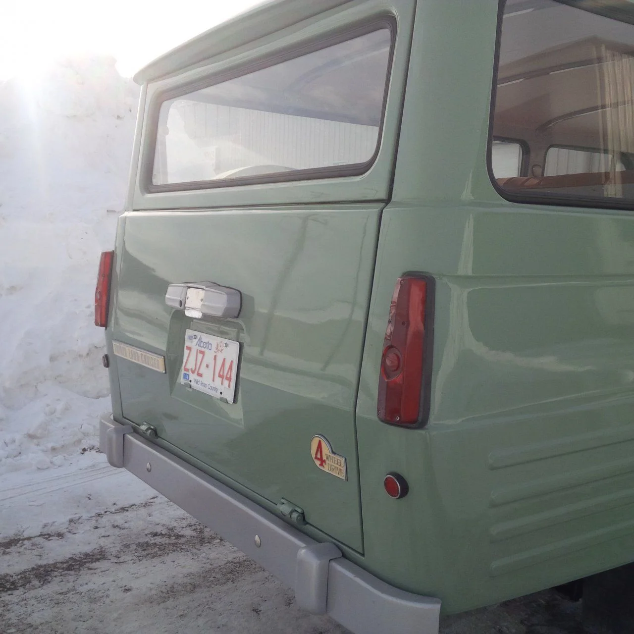

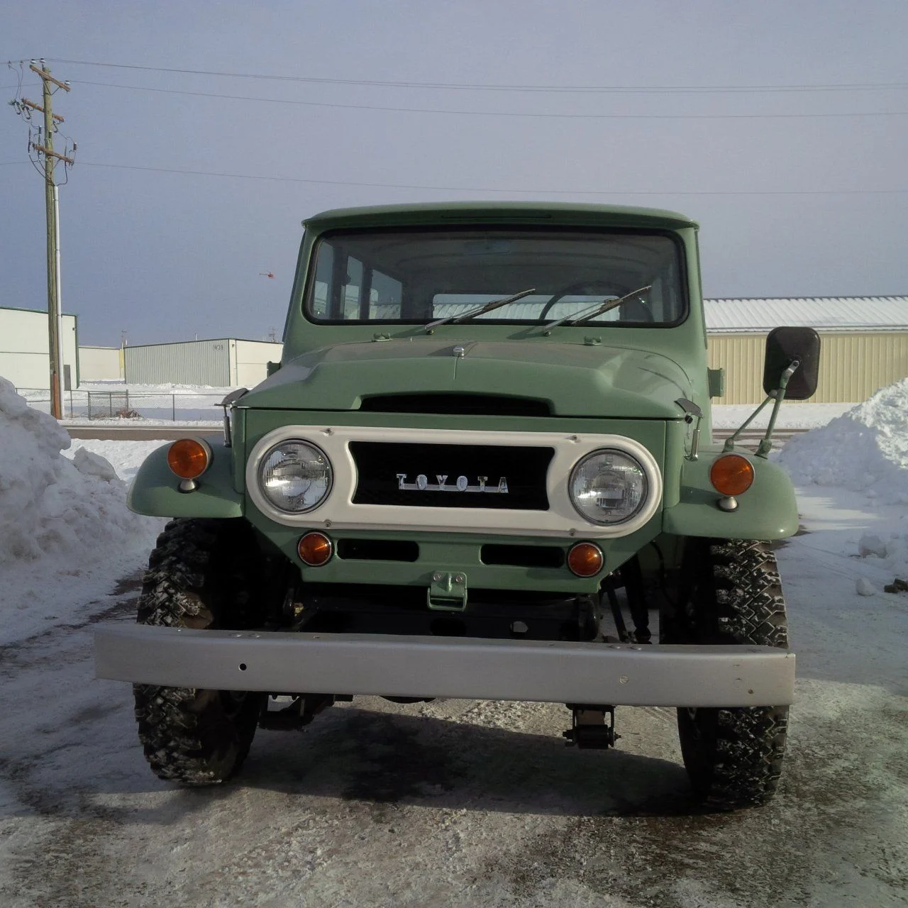

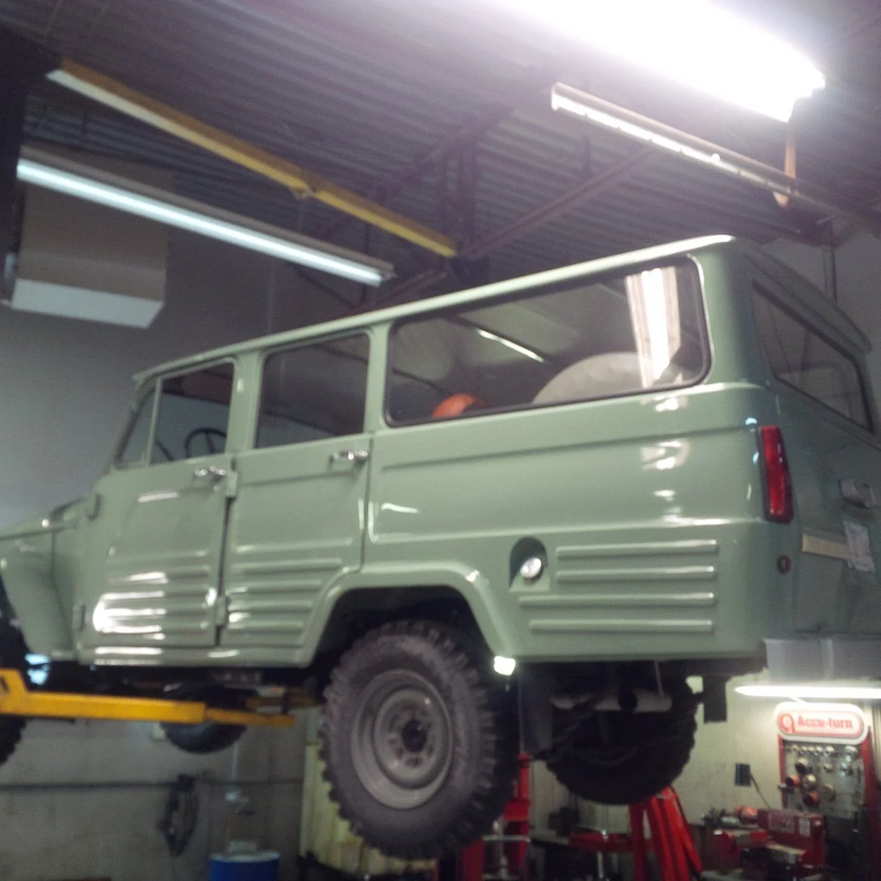

Well, she's back! Took a little longer than expected (see above prediction about being done in 2012) owing to getting the final little parts sourced. The previous (long) drive in this lv was 500 miles over the mountains, so I decided to take the same approach on the way back! And It almost worked out - except for a lack of lubrication in a key drivertrain component, resulting in total failure (see photo of drivertrain below, with said component missing). As this took place in the middle of the mountains - at night - out of cell phone service - hours from home - it turned into a little bit of a trains, planes and automobiles situation. The truck is now waiting for a new (used) tcase comes in from Specter. Will send some glamour shots when it's done
And from the original thread: this a Canadian truck with 25,000 (documented!) miles that I got from the son of the second owner (it had been in the family for decades) after having had my eye in since the 90's. This is the original color as best could be reproduced, and the overall restoration was as stock as possible. That said I look forward to all of the comments and suggestions from those that have forgotten more than I will ever know about these trucks.

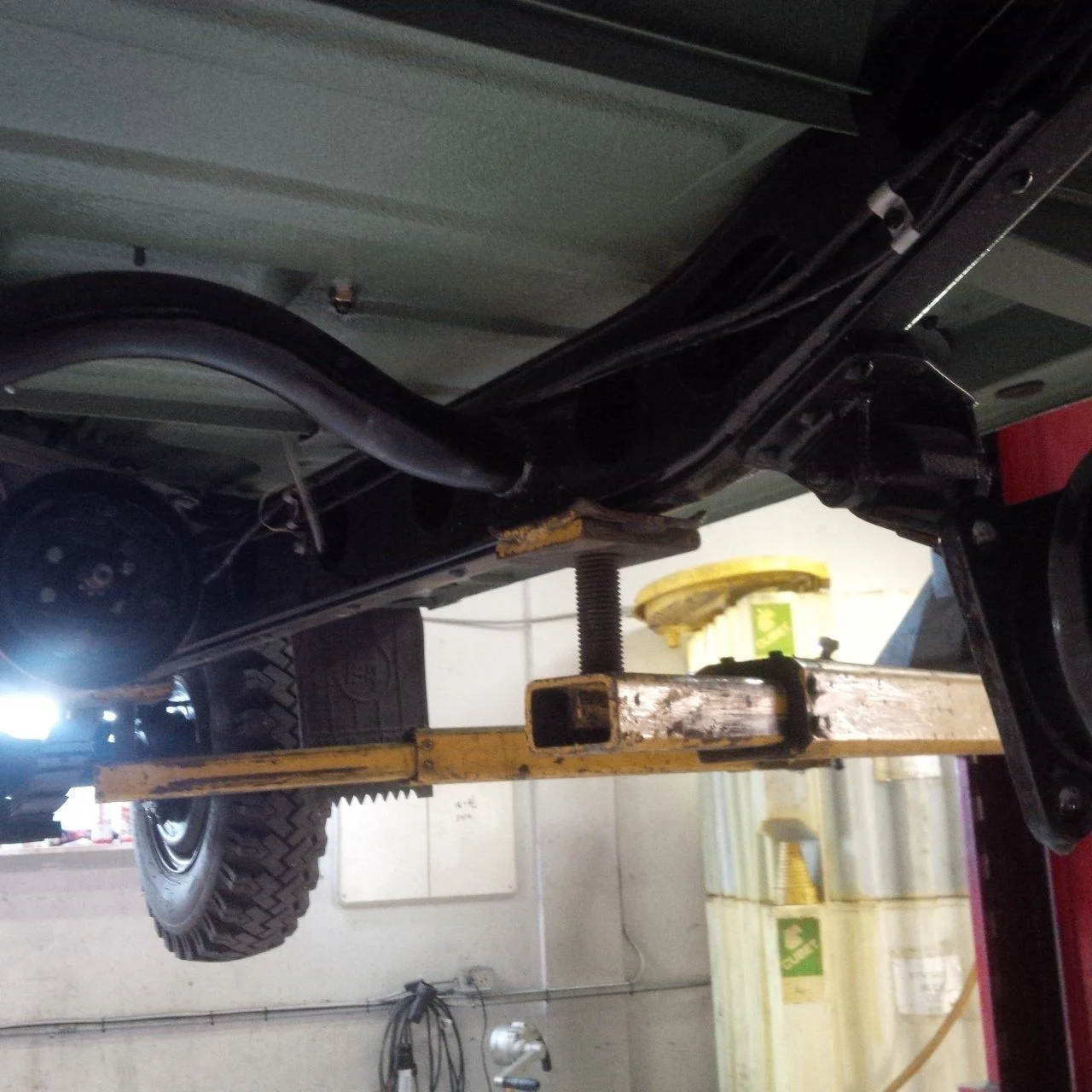

So... the T-case... did you forget to fill it or was there a fatal leak?
And, did you have it towed back to Calgary or is it sitting in Revelstoke or Golden waiting for the T-case?
Forgot to fill it - and I had lots of help in failing this badly on that! Man oh man.
It is in Calgary now. Just needed to get it back home. I am grateful for the premium auto club membership which got it most of the way here.
