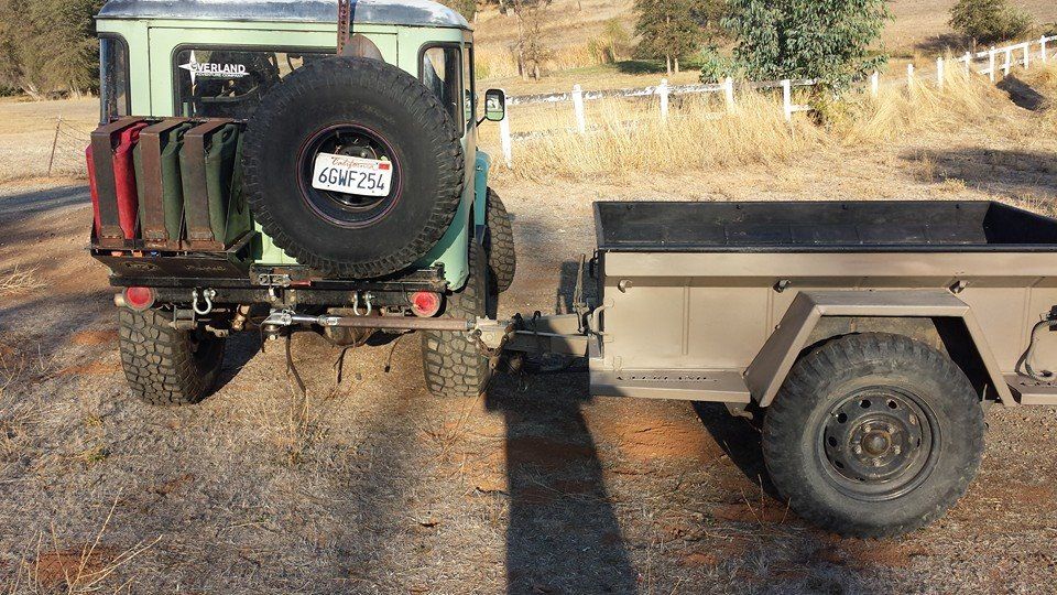

Outta here for the weekend. Just an overnighter over the hill into Reno and back... but still almost 100 miles of unimproved roads. Should be a nice little test, I've not actually towed it behind the 40 yet. I dragged it around town today, just to see how it tows, if there are any issues with the cruiser, ect. So far so good. Only thing that really sucks, is I can't see it at all, not even a little when pulling straight... other then that, I barely knew it was back there. The only real thing that I noticed was the transfer case and transmission whine a little louder going up hills.
Sweet weekend with the trailer. Had a major failure, the cheapo hitch broke. We fixed it pretty quickly though and were on our way again. Over 100 miles in the dirt, 220 total. I'm pooped but man it was a fun weekend.
