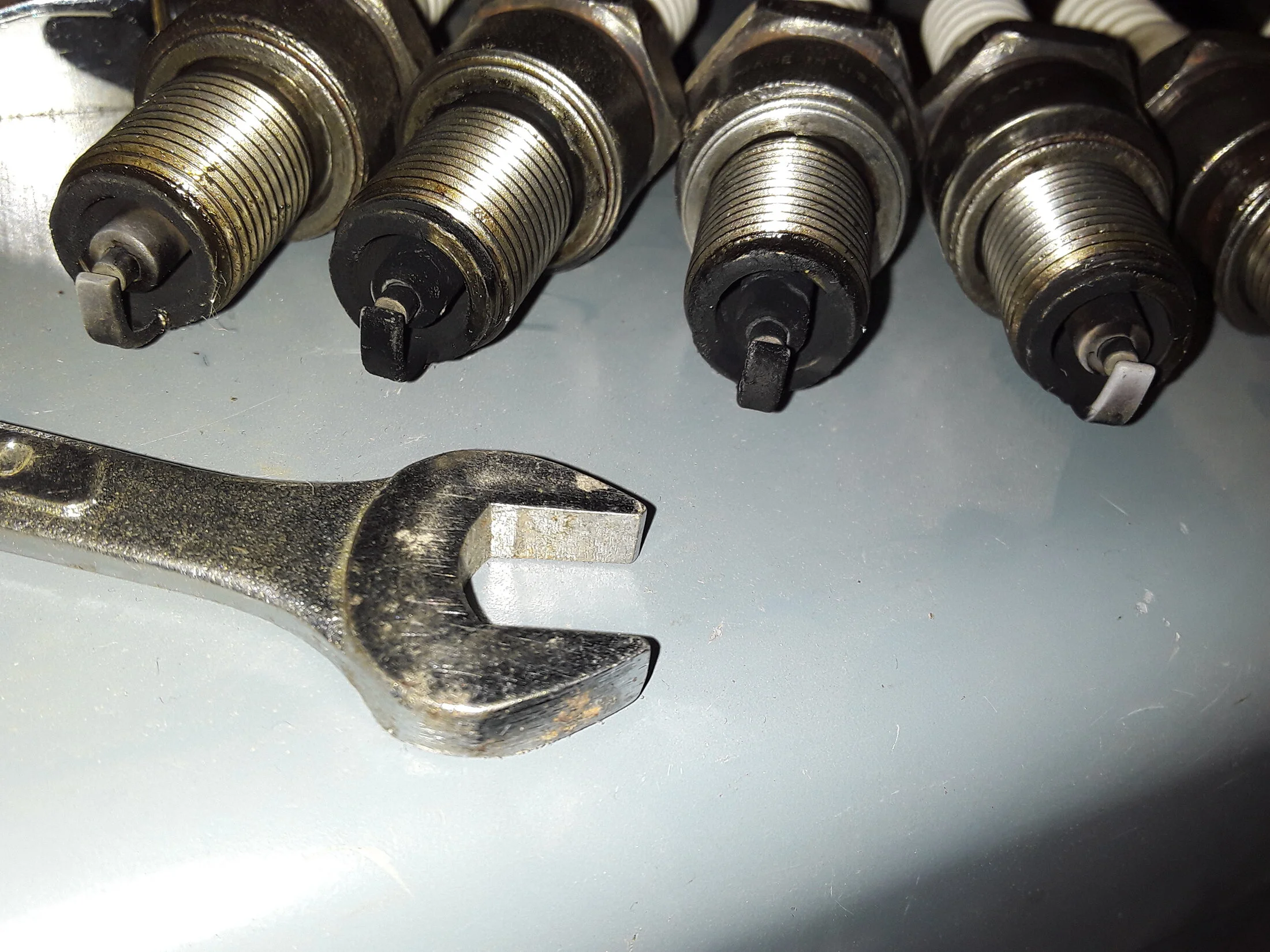

My 1975 2F has a history of being an oil-burner. With the manifolds off, there was quite a bit of carbon deposits on the intake valves. I fixed the leak thru the valves a few years ago. The spark plugs kept fouling, but, I could deal with them as a symptom.
Late last year, I installed Valvoline's 5W-30 Restore and Protect. I'm going to spoil the story here and just say that the camshaft didn't grenade, yet. It is a new oil that has been proven to reduce both sludge and varnish deposits, including deposit removal from piston ring lands, and piston skirts, which is unique in an oil. It isn't an oil flush, as it is specified for new engine use as well. I'm also using, in the fuel tank, a bit of Lucas Fuel Injector Cleaner for upper cylinder lubrication, and Techron High Mileage for fuel stabilization.
After about 100-miles the oil is opaque black, and it is getting changed.
Now, the spark plugs get dirty, but the electrodes are all self-cleaning. Number 5 and 4 are still having issues, but, this was early on.

I just did some Cruiser stuff. I checked the oil, and it is still really clear. After the initial seven-or-so-quarts, everything was suit-like. The two plugs were still suffering from build-up, but, the engine runs really tight.
