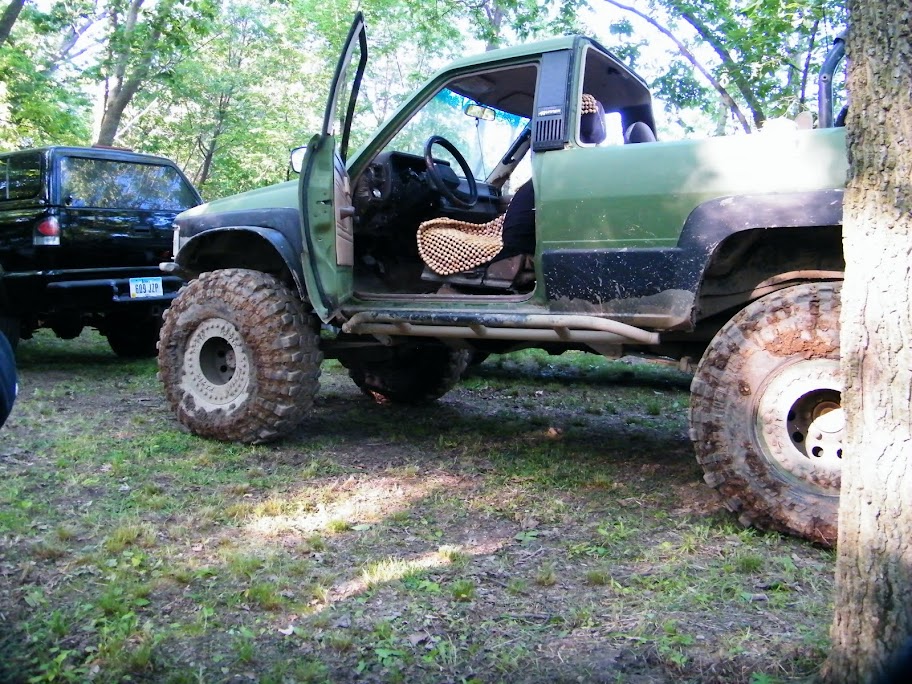

Yes, those pesky temp sensors... I also had to install a mechanical, it works much better. Location suks, but on my trail rig, I'm not too picky.
