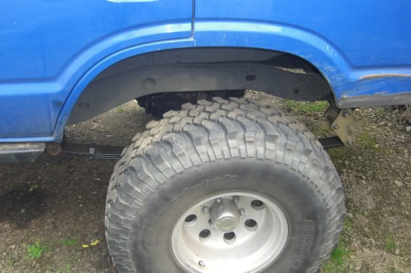

here are some pics, I am sure the experts on here will be able to pic apart everything I did wrong! I have a feeling that with this and soa you'd be tall enough to not rub with 37's and stick to a budget
edit: my packs were completely shot, and it worked out o.k. I think if I had gotten another set of good springs it would have turned out even better. ilovetoski and I had a chance to drive each others rigs yesterday, his has the man a fre lift and sits taller in the rear. I felt like mine rode well compared to his, and had no bad handling characteristics. He seemed happy with the way mine felt, it tracks straight, not too bouncy, etc.
my spare is in the way of seeing the back springs very well, but I hope this helps. Some of the mistakes I made were:
not grinding off all the rivets that are in between my springs. squeaky...
also didn't remove some of the clamps I should have.
not replacing bushings, etc.
not using 2 sets of good springs for rear, mine's not as tall as i think it could be cause my original springs were so shot.
Still need to extend sway bar for best handling, but I will remove it off road for sure.
aside form that, I think it is a good way to go if you are on a tight budget, as I am. Give yourself more than a day and a good helper and it should turn out better than mine.
