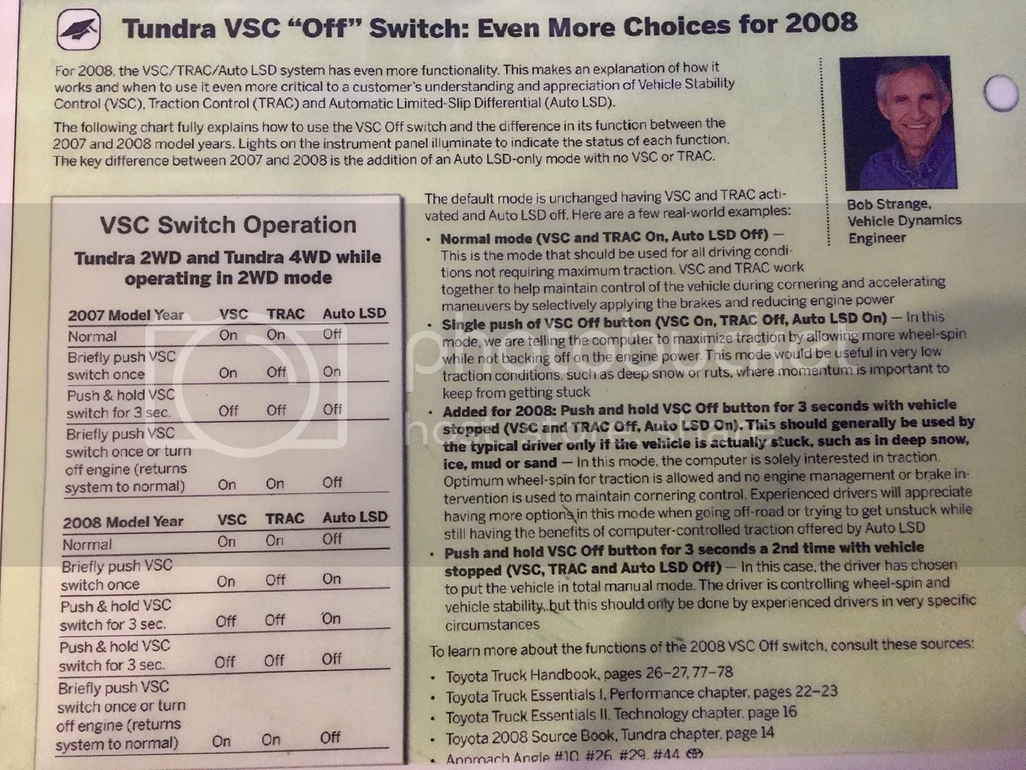

I understand what to do on technical terrain when going slow. But what do others do when they want to go fast???
I posed the question above because, this past week, Jordan Brenthel (Proffesional class 1 trophy truck racer) took my LC out for a photo shoot. While out there, he called and asked what buttons do what so he could really run the truck without all the nannies engaging. I didn't have an answer and told him to look in the owners manual!
Ultimately this made me think of the cheat sheet I keep in the Tundra to remind we what and how to turn off when I'm jumping and running hard in the dessert.
Just wondering what if anything others do?
If no one knows, not a big deal. Jordan and I are going out again in Jan and will have two days to experiment and from that, I'll make one up. Just thought I'd ask here first.

Didn't mean for it to come off like, "look at my credentials!", was more emphasisng how driving schools by professionals are better than breaking metal on 200s for this particular group of people.
I don't have any high speed time in my 200, but when I used to work in a shop we had our hand at desert racing, and i had the most seat time out of the bunch.
If I were to run at speed in the 200, I would still lock the center diff which will disengage the VSC and I'd turn off swerve control, because I don't want what @Markuson was talking about and have the VSC essentially slow me down . If I were new to high speed, I'd leave VSC on by unlocking the center diff and just turn off swerve control to allow tire slippage in the sand. VSC will save you from powering off the side of the trail when sideways if you aren't ready to kick the back end out and basically drift around turns.
I think it's also a good time to talk speed. When I think speed I think over 60mph in the dirt. So if you are ready to completely control a 3 ton vehicle bombing through the desert, then take control. If you are unsure, leave VSC engaged.
To relate just to your experiences, on HMMWVs in Afghan, I was airborne infantry for all my deployments and whenever I was QRF and drove as f**ing fast as we could to get to my buddies in fights, we made it a platoon SOP to kick into high lock for more positive forward traction and less power being sent to the axle that doesn't have as much traction, and gunners just held on for the ride. Since my old 1151 gun trucks and 200s are pretty much the same, full time 4wheel drive with center lockers. I would treat it like the same if that's what you're used to.
Thanks for the insight Taco. I definitely agree, driving schools are well worth the time and $$$. Lucky for me, USMC HMMWV school back in the day was 4 weeks and 75% was all off-road. I was also fortunate enough to attend multiple performance driving schools like Bobby Ore's and Rod Millen's and a few week long EVOC classes.
When Jordan and I go out next month, we will play around with the different options on the 200 and I will report back what we learn.
