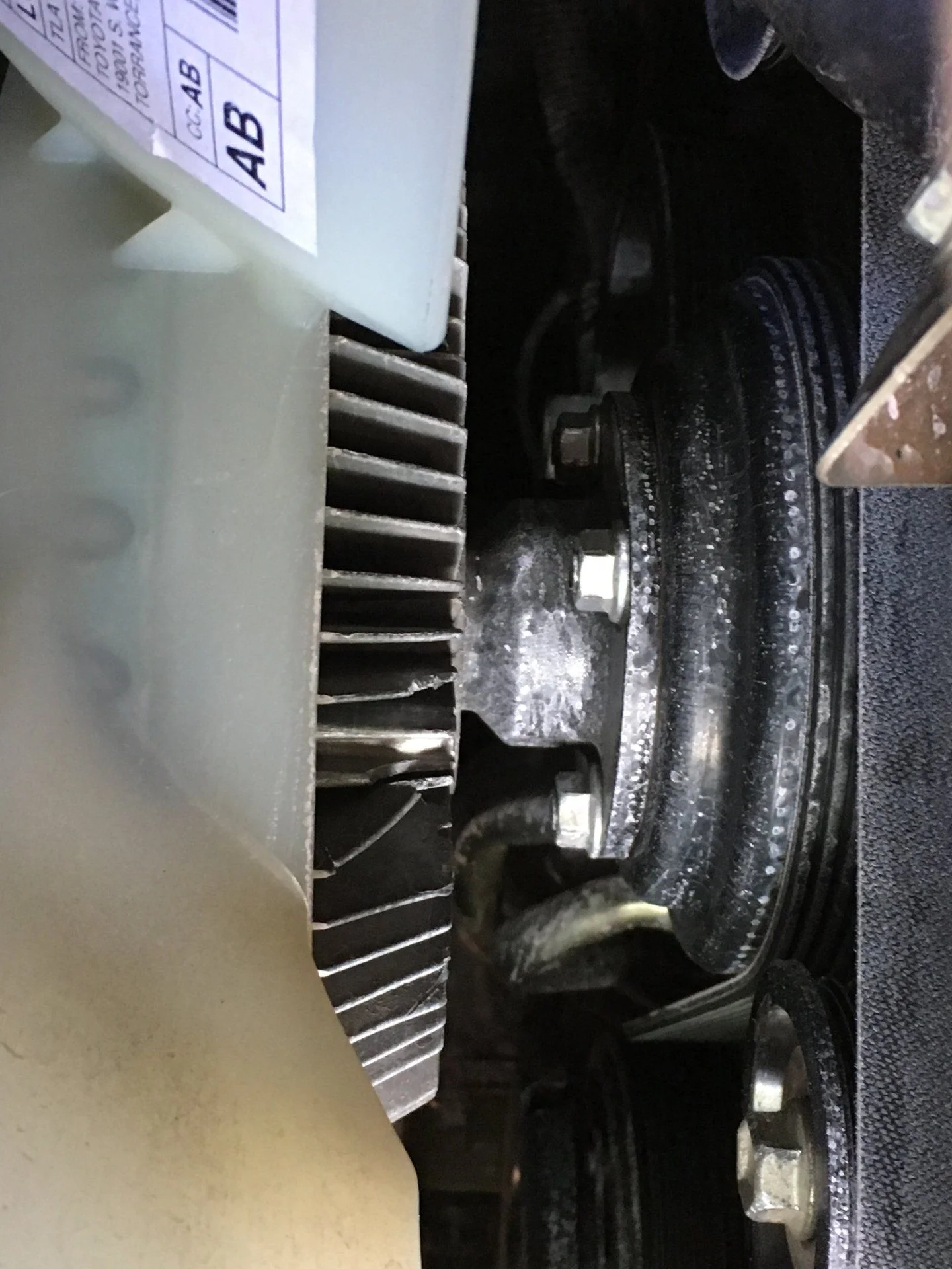

I just noticed that my fan clutch is damaged (outer fins). I'm away from home. Wondering if I should be concerned or should be okay to drive back home. I will have the mechanic replace it once I get home.
Is there a way to test the fan clutch for normal operation? I did drive 4 hours up here with no issues and the damage looks mainly cosmetic, but still concerning. I'm assuming when the fan came off the clutch, hit the radiator, it also damaged the fins on the clutch.
I think you are OK to drive it home. I would replace it with a Asisin (same as OEM) clutch. The one on there is a aftermarket fan clutch.

No blue base on mine - looks just like the pic @mripper posted:
It's the original, so definitely not aftermarket.

Just to clarify, the clutch (as far as I know) is the original, I did not have the shop replace it, but it was damaged when I had a bunch of other work done and they forgot to bolt the fan and started the engine; radiator, fan and clutch damaged.

Yes, IMO it was OK for him to drive home
Non-issue to drive on that, I've seen far worse.
As for colors, AISIN offers clutches in over a half dozen colors including red, blue, green, orange, grey and black. The key becomes knowing which ones offer what improvement over the others while still fitting the fan blade amd water pump or bracket.
Thanks buddy. Just got the Aisin and it's indeed black, looks identical to the one I'm replacing. Going to replace it tomorrow, if anyone has any shortcut tips would be great. Looks like I just need to unbolt the shroud and should be able to wiggle her out.
