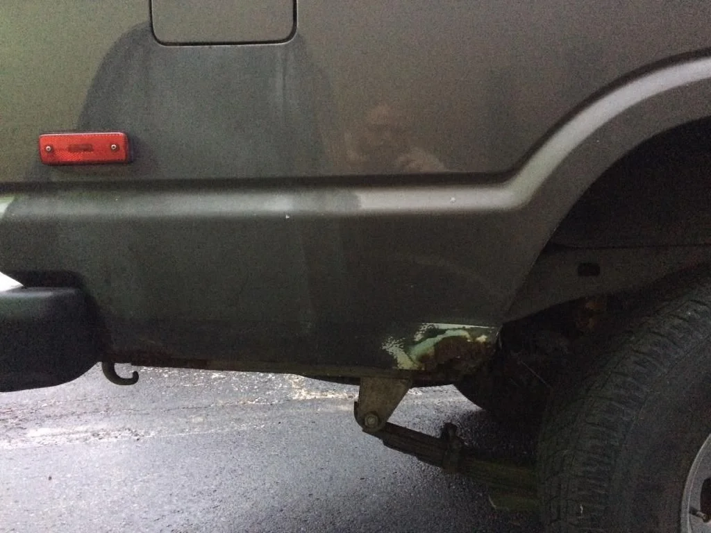

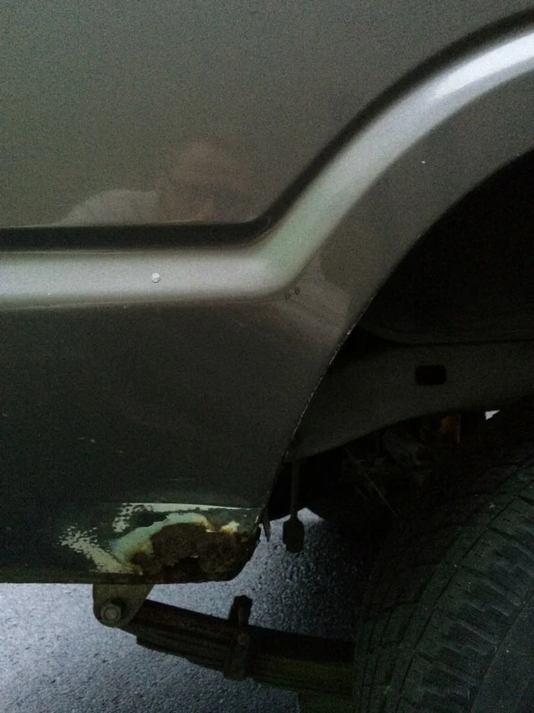

So I am beginning the restoration of my TLC FJ62, and while sitting here at my desk I have come up with an incredible plan.....in my head ;) As I will be pulling the motor out of my cruiser and installing an 5.3 Vortec, I am starting to think about body/bumper work for my project.
I have decided to cut the lower rear 1/4's out so that I can extend the rear bumper up to the rear of the wheel arch. This is to achieve two things, 1. rust removal since I cannot find repair panels, 2. it will also offer a rear 1/4 body protection.
On to my Paint and Body question. Has anyone found or used any repair panels from any other manufacture that replicates the fender profiles of the FJ60/62? I was thinking that if there was another car/truck company that had a similar fender profile as our 60's, I could use it as a donor piece of good metal instead of trying to fabricate a complete new fender lip.
I would love to hear everyone's thoughts or experience on this

All I have ever heard about is Wolf steel rear quarters/doglegs.
http://alfaparts.net/tlc.htm
Also heard mention of Cool Cruisers repair panels...
As far as other makes/models that match the 60...no idea. I bet a early Suburban would look close, but be way off. How about donor panels from another 60? That's the route I am taking with almost the entire rear half of my BJ60. It's a ton of spot weld drilling but very little fabbing and bending.

so now that I have all of the "pieces to the puzzle" here at my shop.......I can say that I am happy with both. The Wolf pieces have more metal included, and I think will allow for a better blend with the metal work.
German pieces are nice, although there are ripples in the radius arches, which I think are due to inadequate "shrinking" of the metal. Nothing that some prep work won't eliminate....but since I have both to compare.
