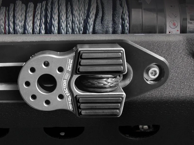

I'd like one of these. Can I connect one to my existing synthetic line? Or do I have to buy a new line with the link already attached?
Super easy to connect the Flat Link to any existing Syn or steel cable. You just need a set of snapring pliers!
To elaborate, the hardened pin is retained in the link with an internal snap ring that inserts into the bore on the bottom. You can connect it to any cable that has a proper thimble.
I'd be all over a part like this but just can't justify the cost.
