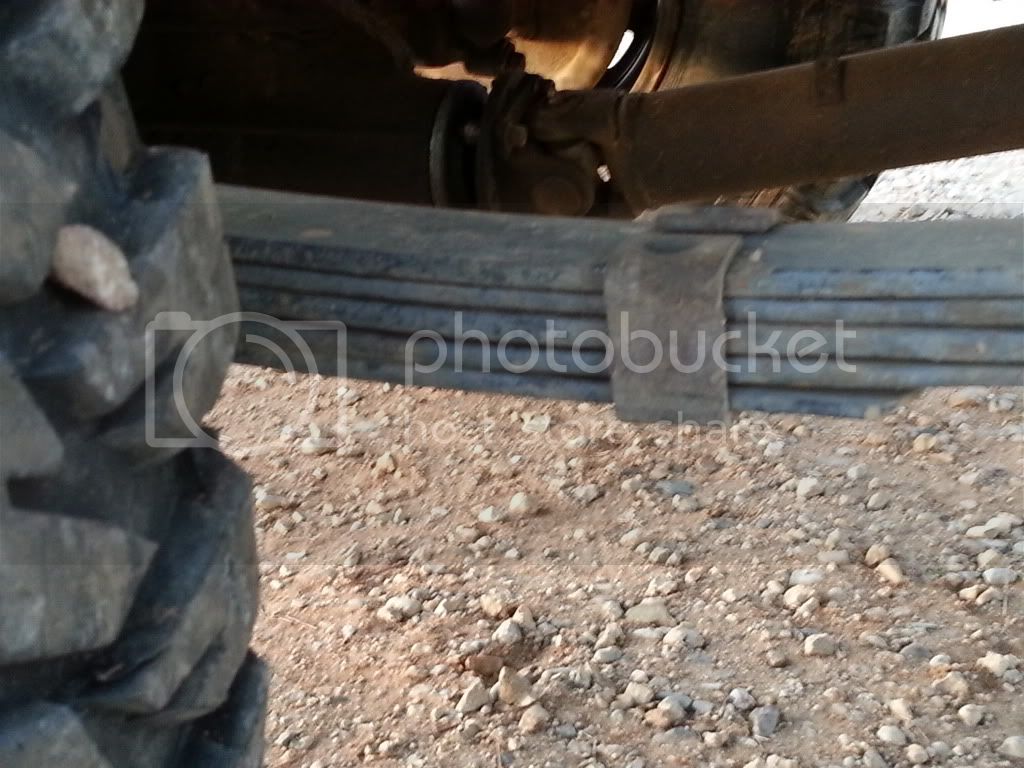

Hi wondering what springs you run in your pack im running 5 pack rides really still what do you all suggest to pull. in my 82 first gen
http://s911.photobucket.com/user/lanelikastreet/media/20131228_164512_zps0336d2d3.jpg.html
Start with the bottom and work up from there. The overload I would keep as it helps prevent axle wrap. I have the same leaf pack in my taco, love them.
