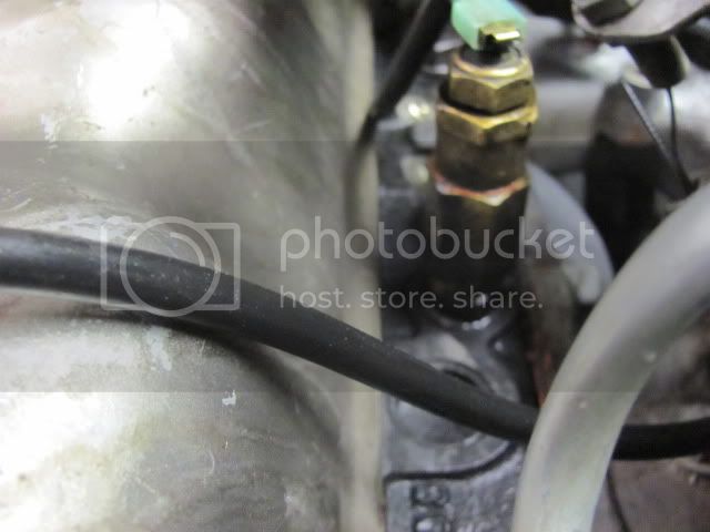

Is anyone aware of a temperature switch that will install in one of these two threaded holes that can be used to turn my electric radiator fan on/off (on at around 200-210 deg F and off around 180 deg F)?
I have searched ebay and the web, but can't tell if any of the switches would fit these threaded holes.
