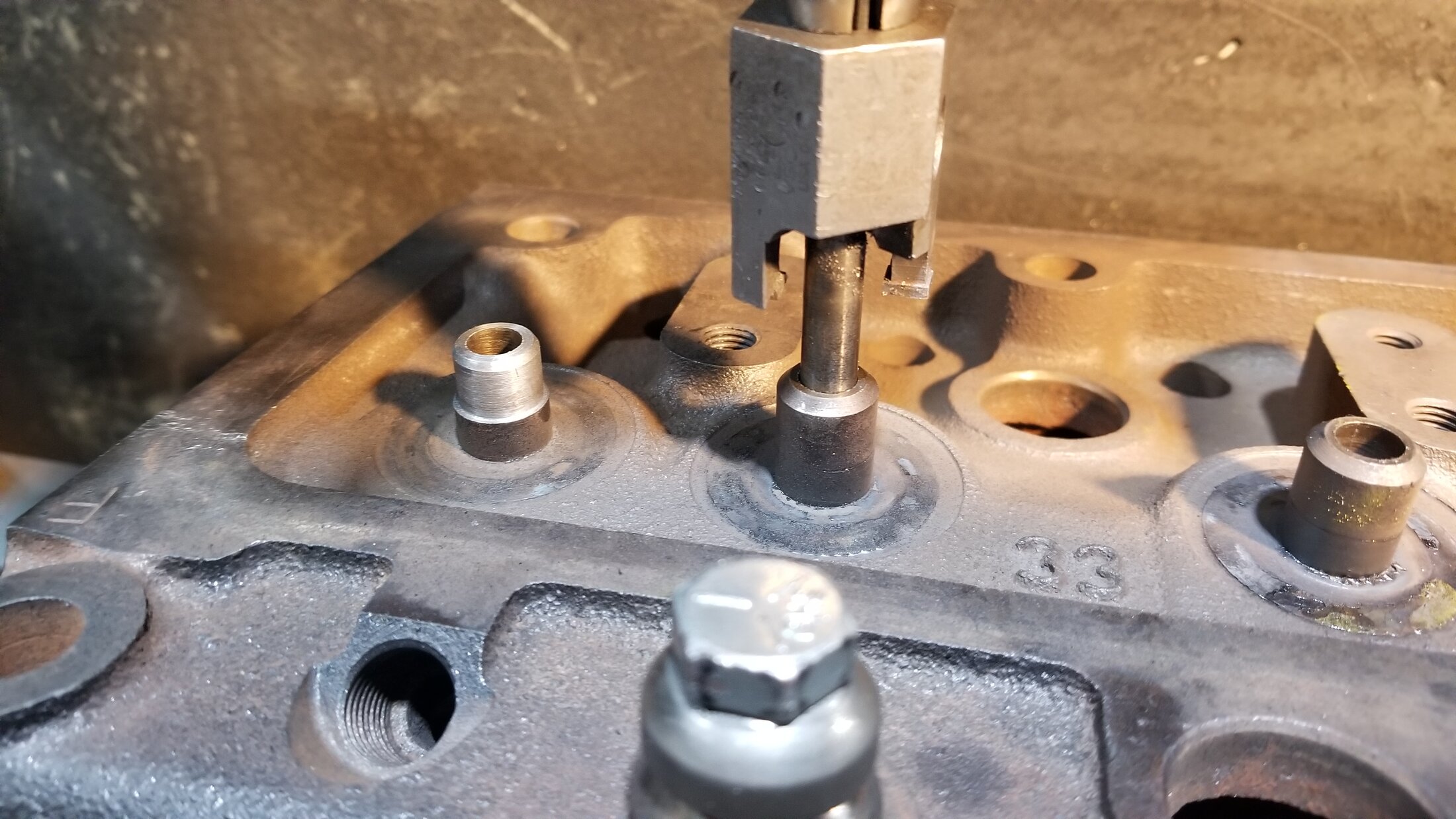

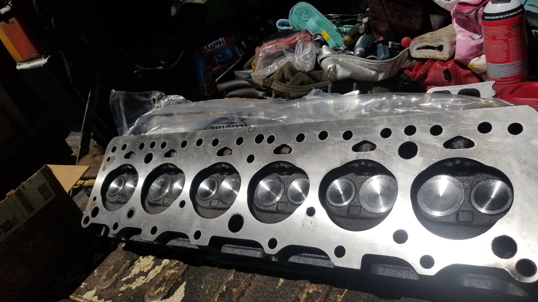

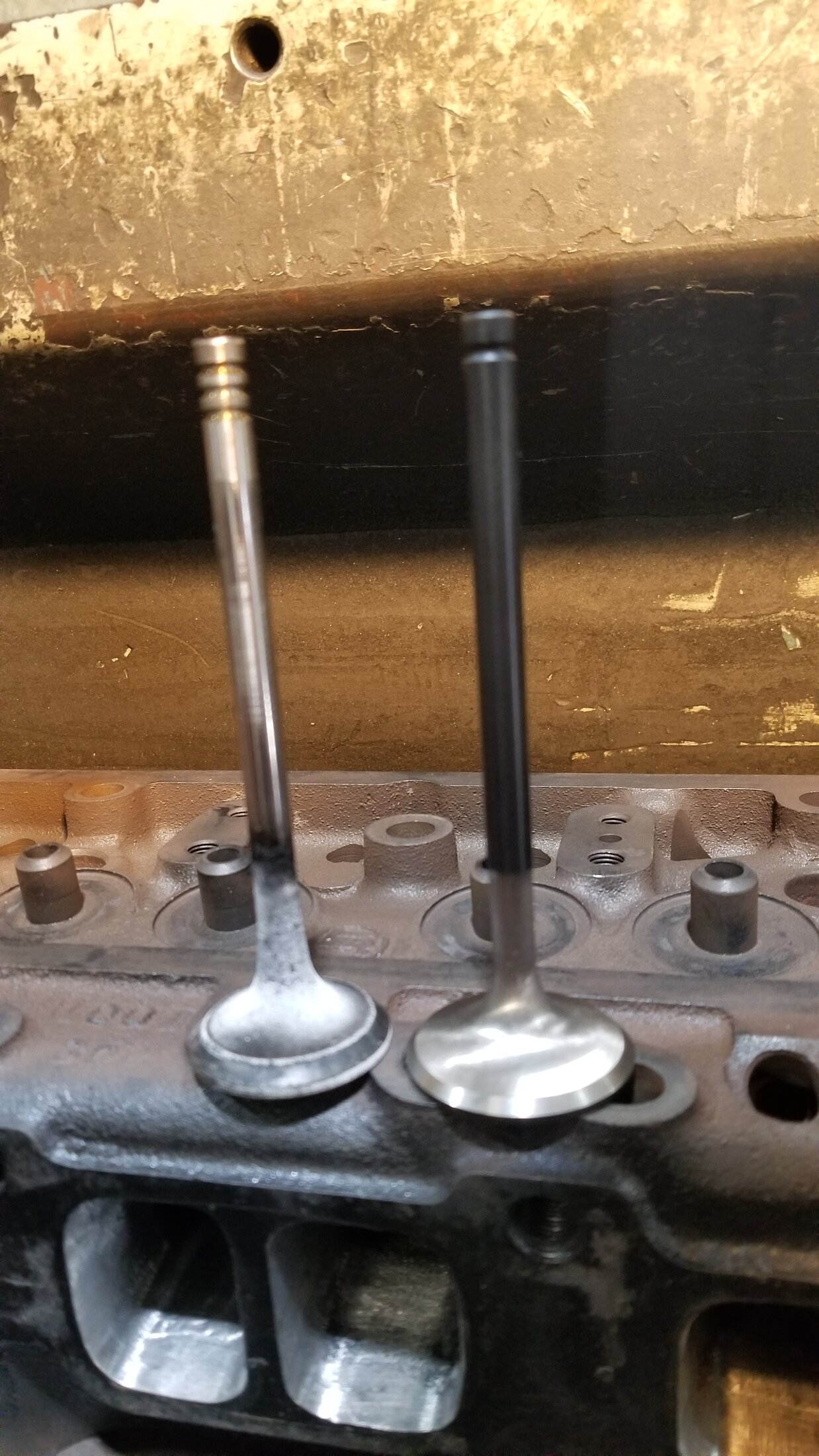

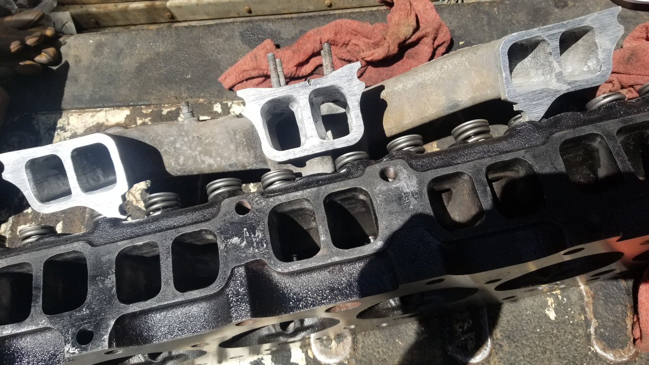

OK. I first built this engine 20 years ago. early 2F block, Late F head, bored , balanced, RV cam, Downey headers, wide runner intake, 60 series dizzy, 10/'73 carb.
The head just got a routine valve job and a "Bowl Job". so I've been promising it a good valve job for the last 10 years.
So I took the head to my local machine shop (there's only one). Machinist did all the usual stuff, checking and shaving and truing and stuff.
I told him I wanted the slightly larger cheby valves and some nice port matching and polishing. He ordered 18-02056132 and 17-00321750, that's what's on the invoice. He had to machine down the valve stem seal bosses on the head to accept the cheby valve stem seals

On the valves specifically, there is an advantage in longevity to using current metallurgy/technology, i.e. stainless steel chevy/LS valves. If you have to use a little bit larger valve sizes to get these to fit then OK, but in general large valves and more efficient intake and exhaust (porting, headers, etc.) are mostly going to benefit an engine tuned for max hp at high rpm's. The F-series motors were designed for good torque at low rpm; one of the (many) ways to achieve this is using modest (smallish) valve sizes and conservative cam timing. Modest valve lift from the cam will also increase the service life, another worthy goal of the original design.
Short story: Just throwing larger valves in without a different cam and a lot of other work is going to decrease the drivability and usefulness of an F-series motor for its intended purpose.
