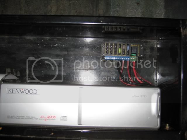

Here is a small one with the relay built in, that I used in my 40. It's made for motorcycles but works well in Cruisers too. The limiting factor is that there is only room for six connections. If you're going to run more than six accessories off of it, then you'll need to use a Blue Sea or similar larger fuse block. The cool thing about the Farkleshop fuse block (besides the built-in relay) is that you can choose on each and every connection whether you want it on with ignition only or always on, and you can change back and forth instantly just by moving the fuse.
Farkleshop aux. fuse block
Installed in the Con-Ferr box behind my front seats:
