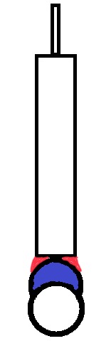

Thanks for that input and I've been debating the same over those factors.
The eyelet metal is pretty dang heavy and wide. I was debating to whack it off completely and put in a new standoff as it would be aesthetically better. But can't imagine it would be stronger, especially if I put in a filler plate. Something like what's in blue to support the legs
I’m attaching an image of what I’m thinking. My concern would be any sideways force now has much greater opportunity to bend the welded interface sideways. Before it was simply resting on the bushing and retained there. Now the shock end is effectively retained to the end of a post the diameter of that existing weld… any sideways force (like even the whole assembly being very slightly off center) is multiplied.
Additional bracing to keep it from “rolling” off that post would help, at least in my head.

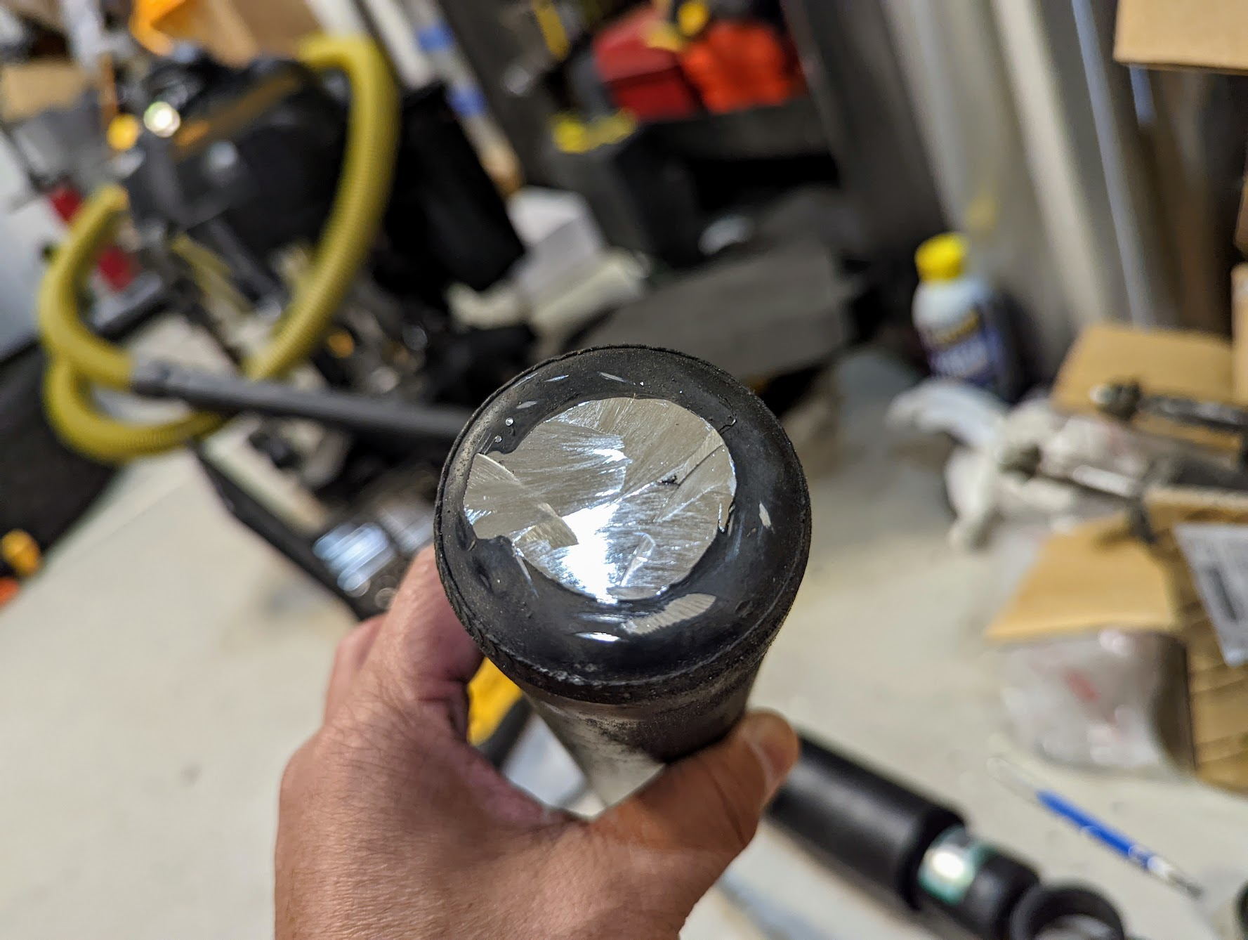

Having cut the eyelet off, the interface there is quite robust.
I don't doubt that, but it is designed for the forces seen by the shock sitting on the eyelet. You will be altering those forces quite a bit.
Also I'm not suggesting completely filling those areas, simply adding a triangle shaped vertical brace to help resist sideways deflection.
May all be overkill, but I've always felt that is a good path when making changes like this.. ones that could result in not being able to get off the trail if something goes wrong.
Good points but I'll likely leave this part alone as it's robust enough in my mind. I imagine other areas will fail first before this interface will.
